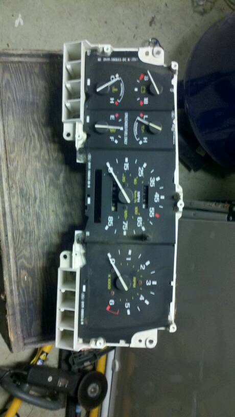

just so i got this,g and 8 should be grounded for it to read correctly with a v8?
i like to be sure before i go into the dash and harness on this and change from factory
Good time to clean this while its out
Sent from my DROIDX using Tapatalk 2

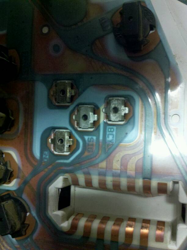

The back of my cluster says 8cyl signal and ground. So do I ground the 8cyl wire on the plug?
