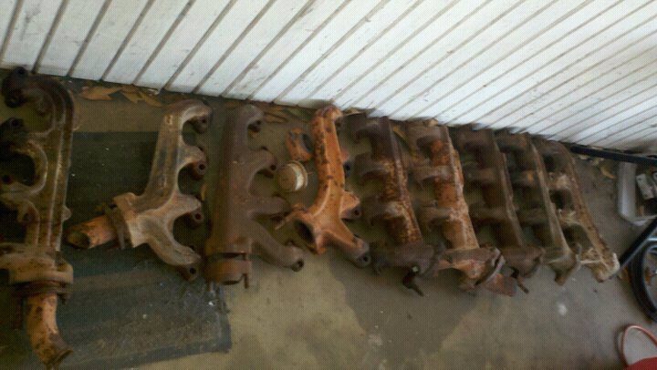

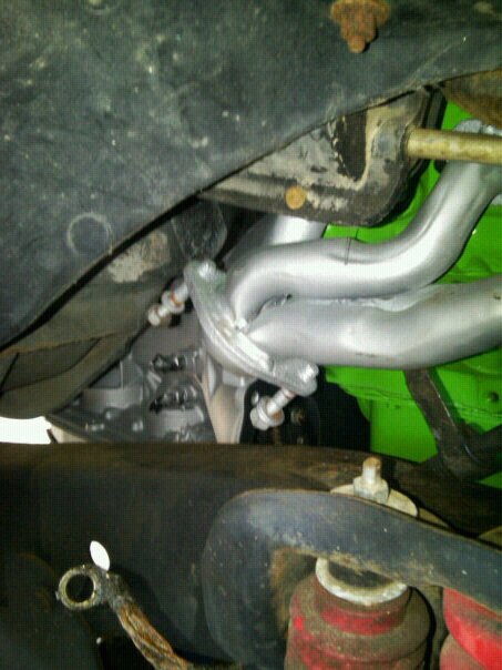

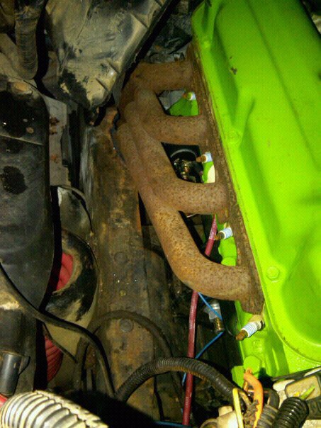

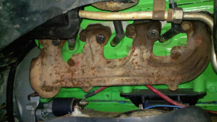

The headers dont work they hit the frame,long tube headers no good either.after multiple trys I got a pair from an old galaxy 500

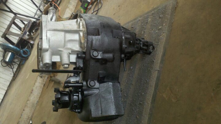

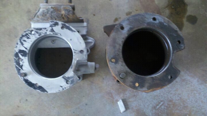

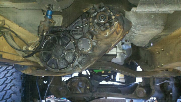

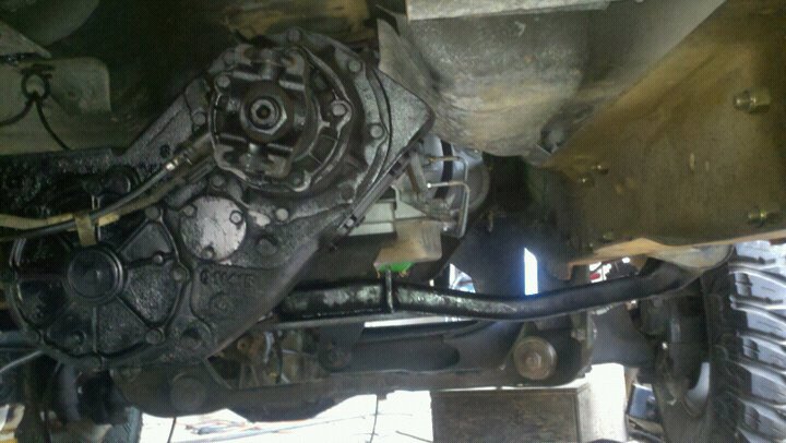

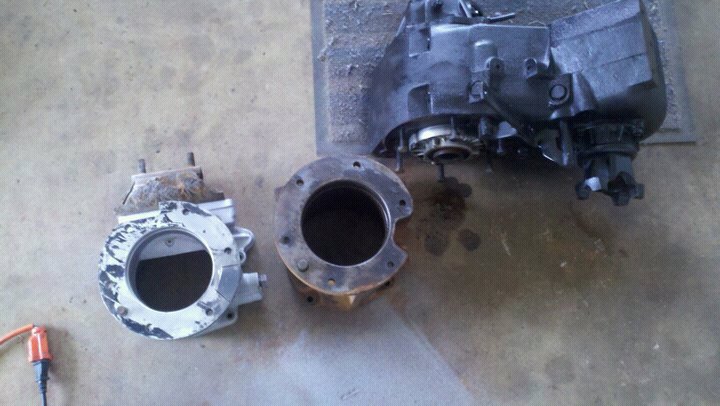

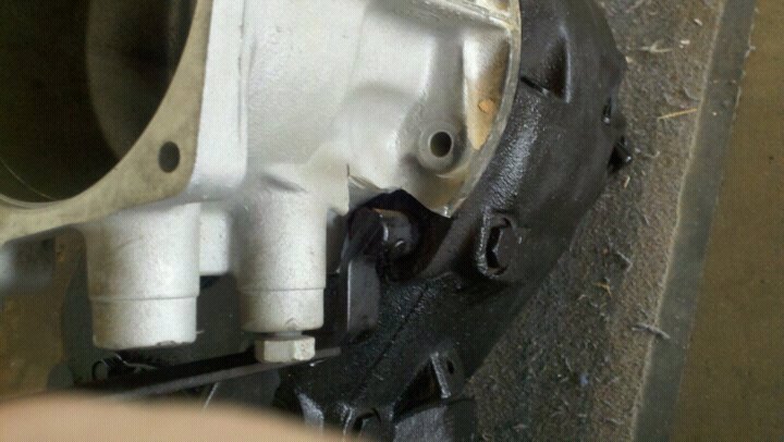

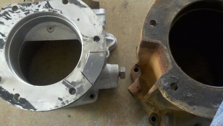

I got a 205 from a 3/4 ton ford,and modified the tailhousing a smidge
Sent from my DROIDX using Tapatalk 2

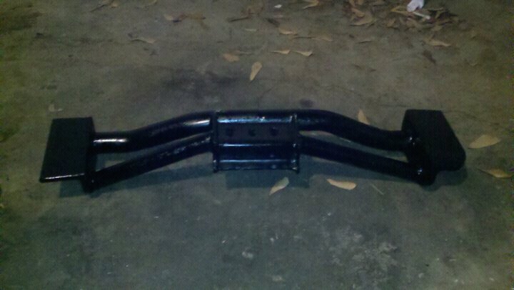

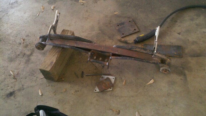

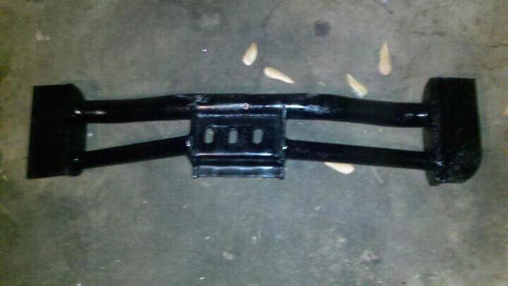

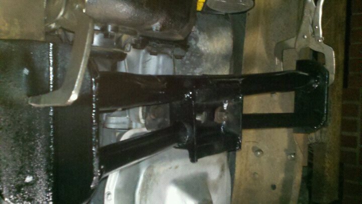

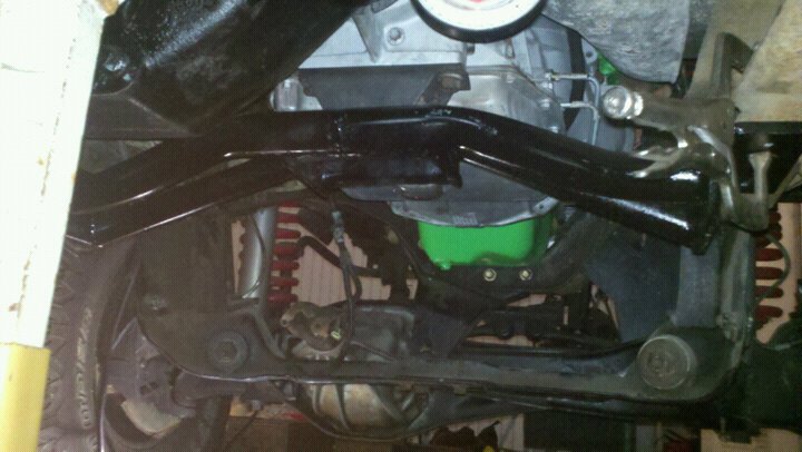

Had to build a crossmember but come on....thatll never work

Thats more like it

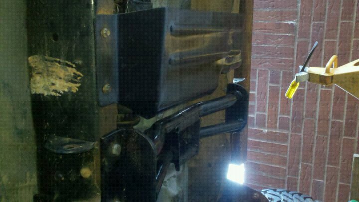

Factory skidplate works well with new crossmember

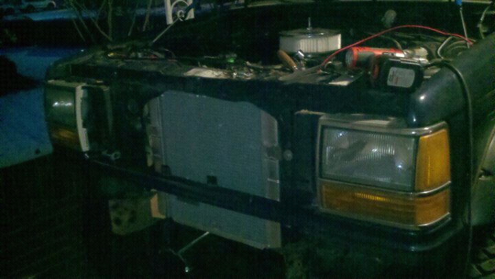

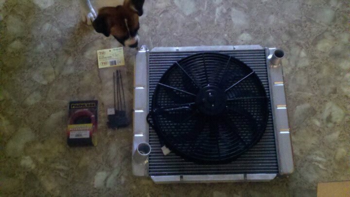

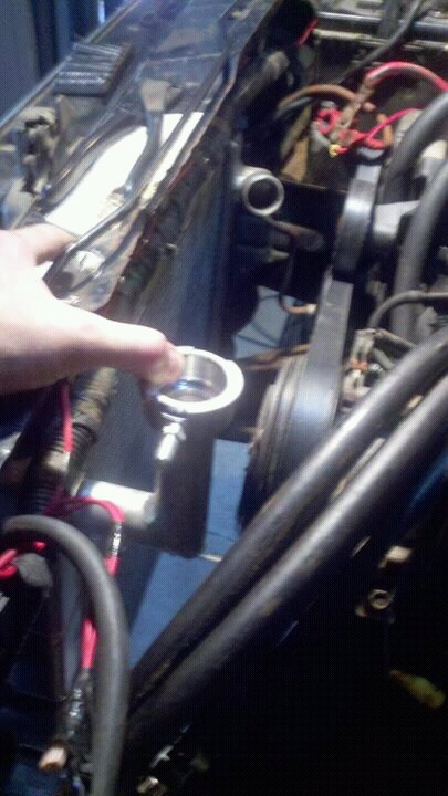

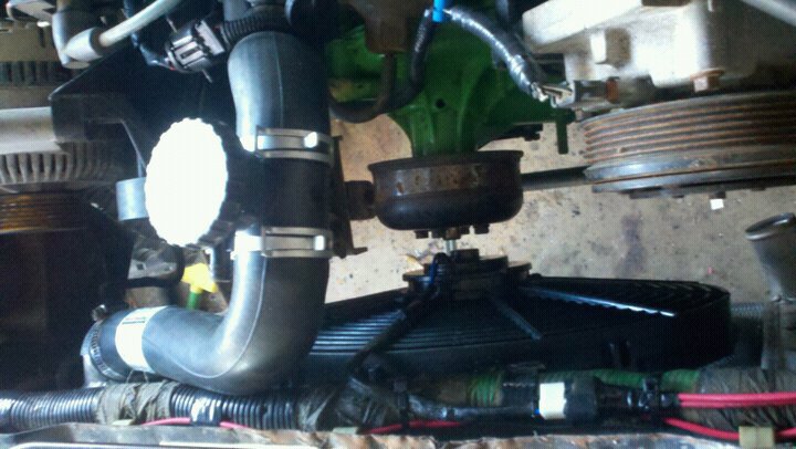

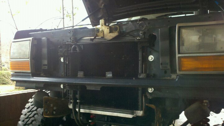

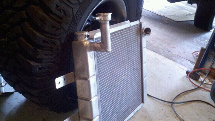

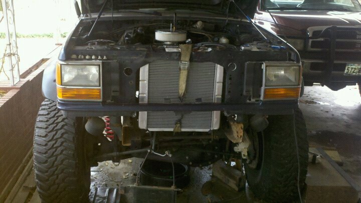

Got my summit radiator and fan,universal fit my foot! I dropped it 3" and recessed it in the core support 3" to get enough room for the fan.the holes on the core support I drilled to get the a.c. Lines to the condenser. After it was all set up I took it out to add a new filler neck,i dont like the in-hose style.

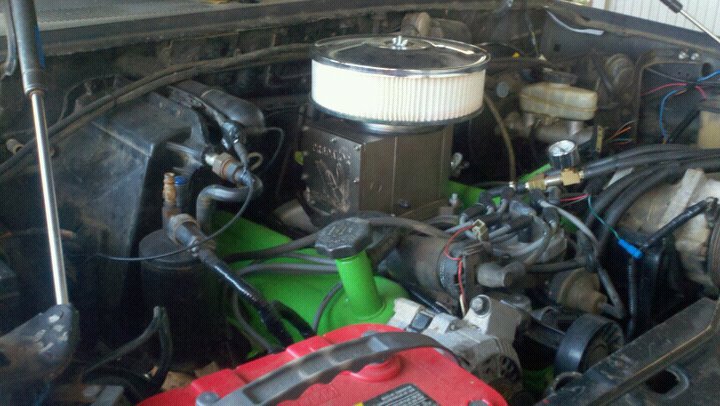

Preditor carbs are cool but useless with an aod

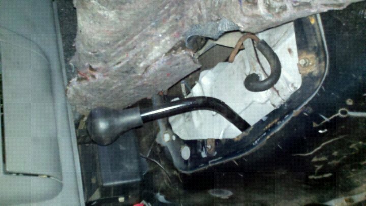

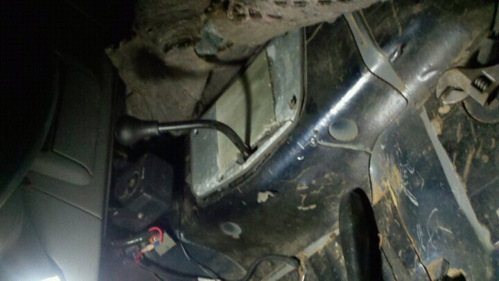

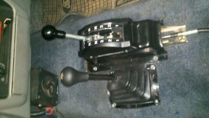

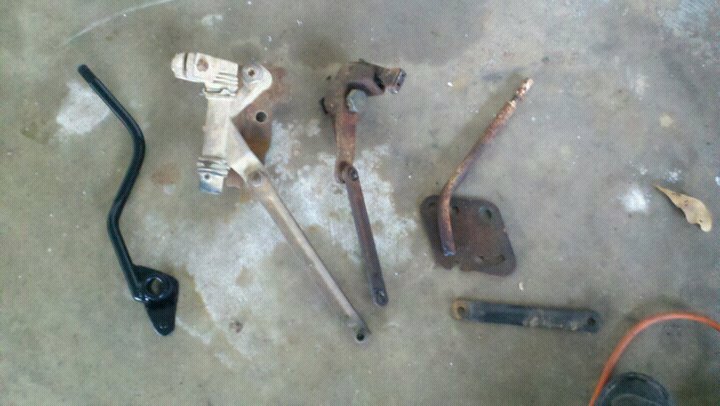

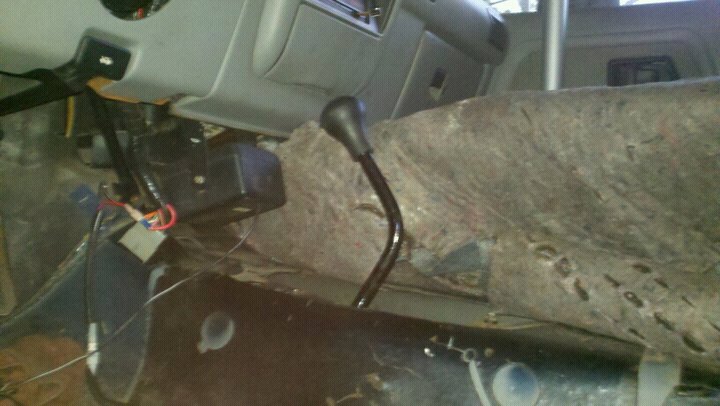

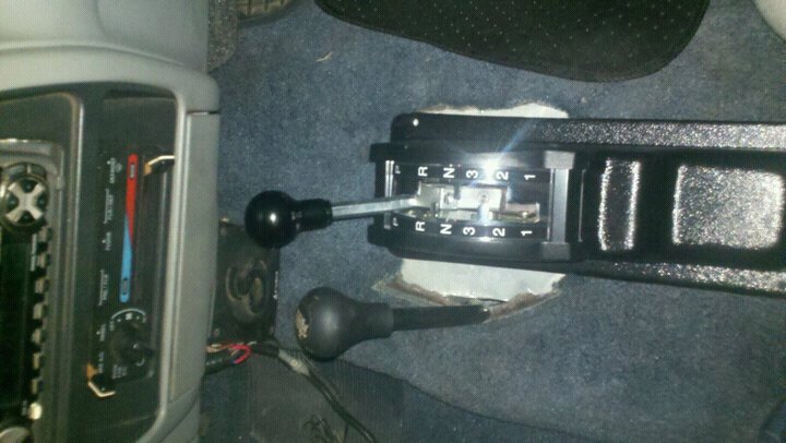

Got an art carr shifter,apparently the last one,i was told art carr went out of business.but I still had to pay dearly for this thing

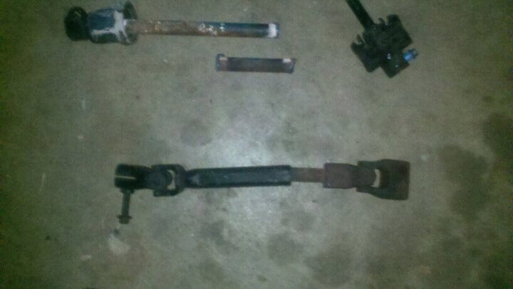

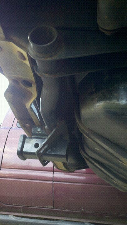

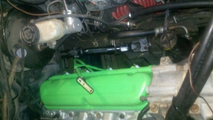

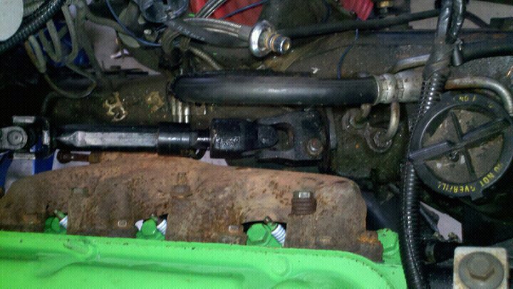

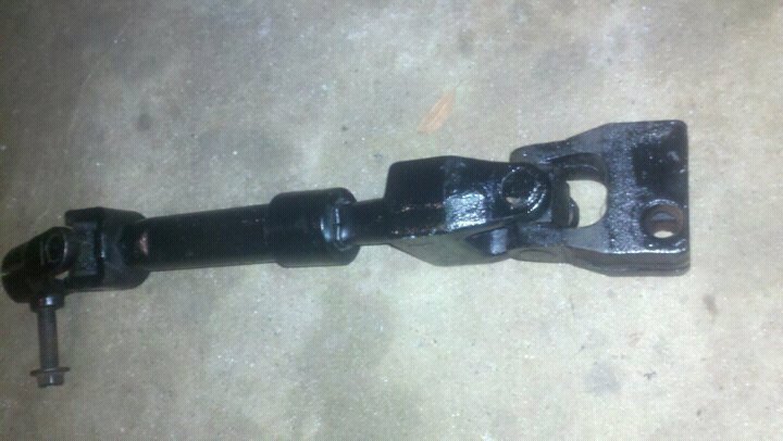

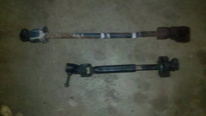

The rag joint had to go because it hit the exhaust manifold so I robbed a shaft from a 70s model and combined the two

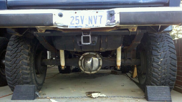

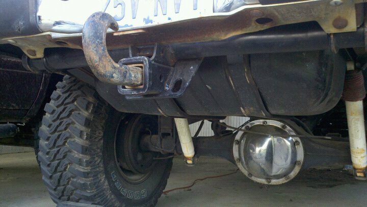

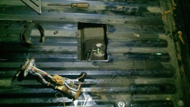

I put in a bii fuel tank,made somestraps and cut a hole in the bed for fuel pump access I think my wires are crossed because the guage doesnt read correctly

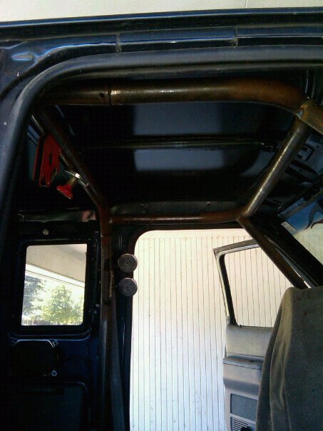

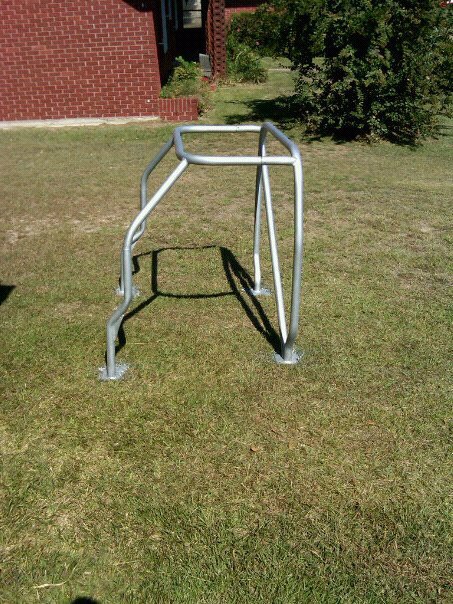

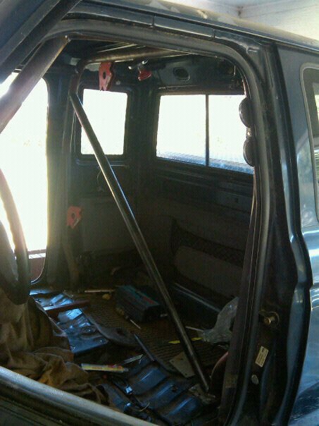

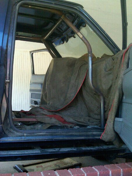

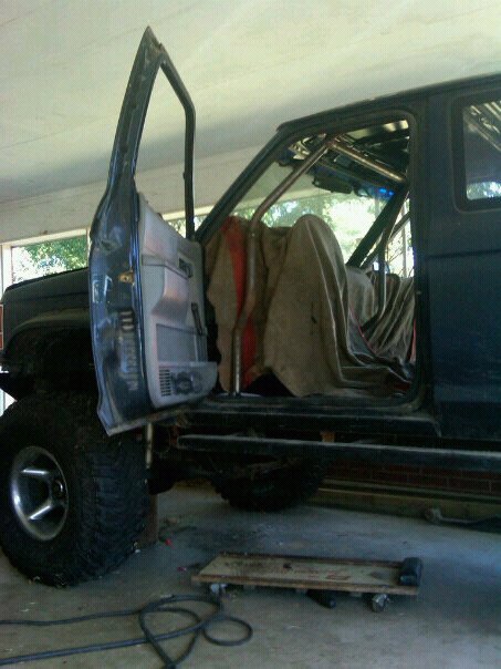

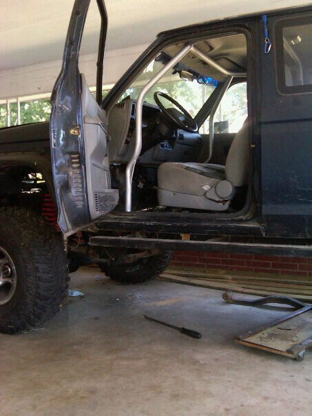

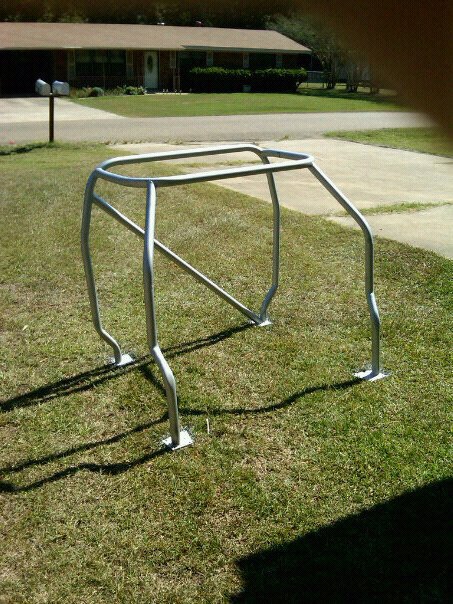

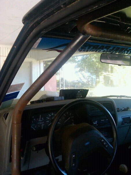

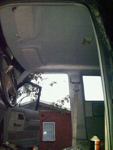

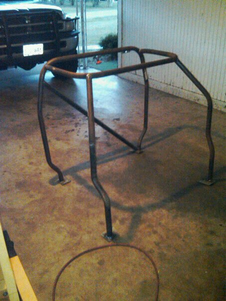

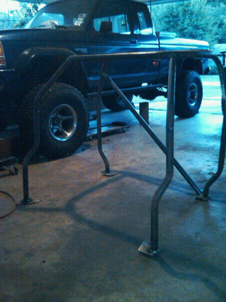

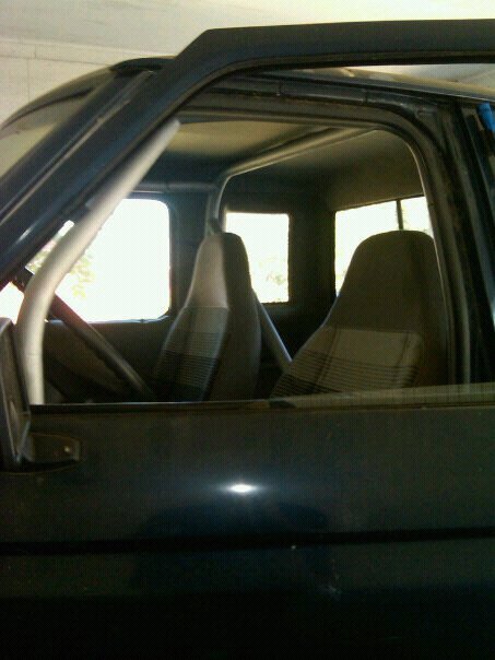

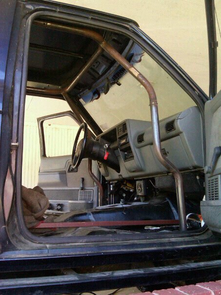

Got a cage all bent up and fitted in there,added gussets to the bends,put in a new headliner,paint and the final install,i think I should have done this before the rollover!
