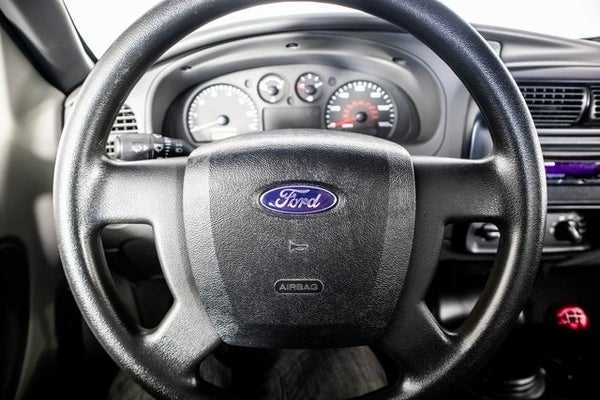

So somehow my dad managed to bend my steering wheel while I was gone. He blames my suicide knob but still offered no valid explanation. Anyway...
Provided I find one of the same kind in the junkyard, what's the proper procedure for moving the airbag to the new wheel safely?
Also, there are a few different style steering wheels in the 1998-2011 era. Mines an 09', say I find one from the same era but a different style, is the airbag the same throughout those years even on the different styles? There is an 2002 near me but it's not the same design.
This is the steering wheel I have.

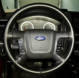

This is the 2002

You need the same style.
To remove/ install the airbag. Disconnect the battery, unplug the air bag. Reverse this procedure to install.

Ok found the same style wheel from a 2010 but it has all the fancy buttons for cruise and radio stuff. I'm assuming this would work the buttons just wouldn't go to anything?
Yup... you may even be able to use some of the fancy buttons.
Maybe not... the airbags look a little different.
Doubt it, don't think my AM/FM super awesome radio with all of 5 buttons has any available functions for that.
