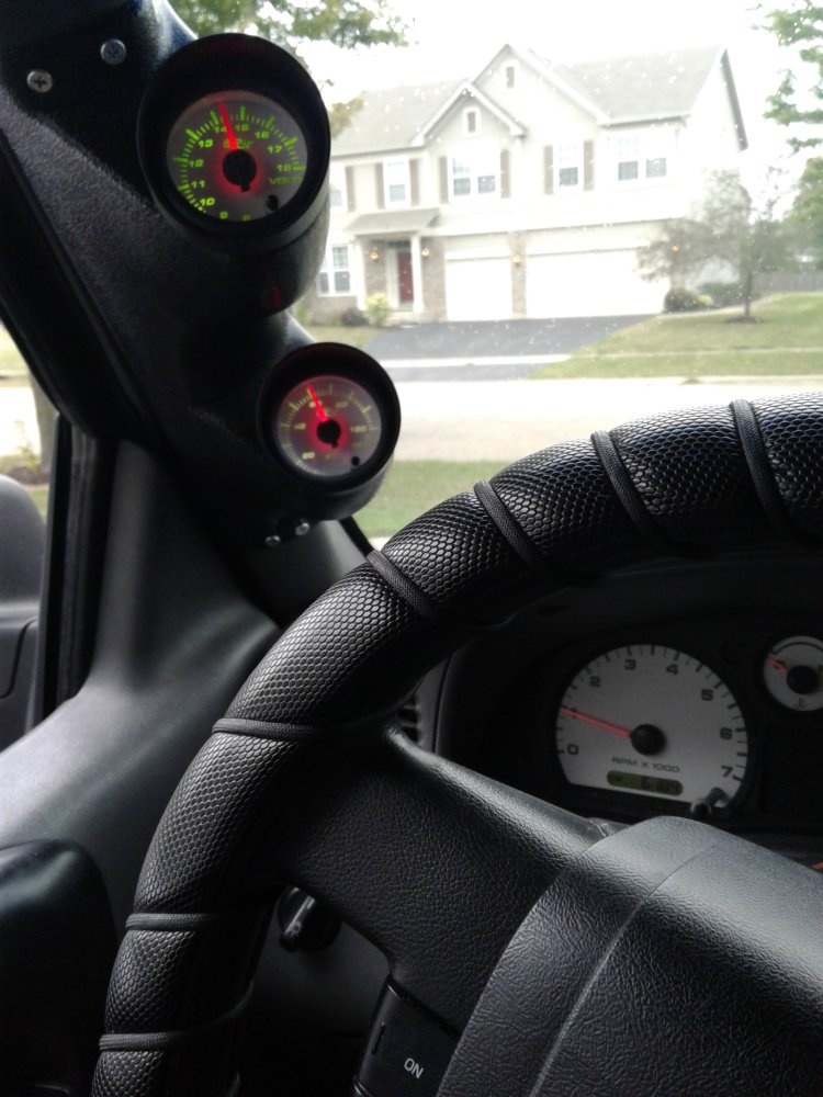

I'll add that the wheel in my 06 was really nice... that's what's in the picture... I still wrapped it.

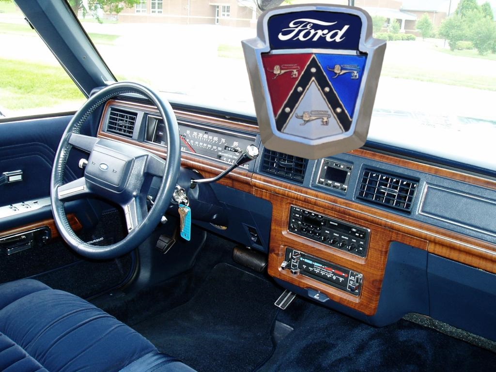

Crown Vic Steering Wheel
I've been wanting to do this for a while now but still can't find a wheel (Blue but black will do).
The ones I did find ('8x - '89) were in to bad of shape &/or the horn button was missing. I found the diameter is ok
& I think the dish depth will work as well. Comparing the backsides looks like it will work too.
It doesn't need to have the leather but it does need the cruise buttons.
Anyone know where I can Get 1 ?
