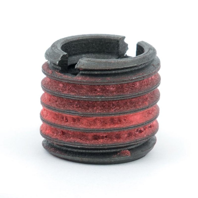

I assume you know what a helicoil is. They suck for blind holes, but there are different threaded inserts that work well for what your doing. Provided you can get a tap to it. I repair cylinder heads with these all the time. Should work great for your situation as well.
Something like this should work:
I believe the starter bolt size is M10-1.5, but double check it to make sure.

I like yours too 4x4junkie, never noticed those kind before
No one likes my thread inserts... :cry:
We do business with a head shop, not the magical kind.... they send us heads all the time with broken studs or stripped holes. We use to use helicoil, the ones I pictured are cheaper, faster and stronger. And no insert tool required. If you do helicoils enough the tool is 150 bucks.
