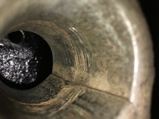

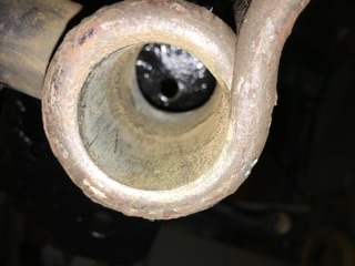

lView attachment 36444looks like there is corrosion in the center that will limit inserting the new bushing. I am planning on using a hole saw to cut out that ridge n the center

Hole saws tend to cut larger than the size they say. I'd be leery of using one. I'm pretty sure the new piece should be a slight press fit so the hole needs to be a couple thousands smaller than the new sleeve. You will never get that accuracy with a hole saw.
Emery cloth and elbow grease.
Don't know torque values off hand.
Those are aftermarket bushings so they were replaced at some point. Do NOT use a hole saw to clean that up. Rat tail file or sandpaper only.
Any old grease will work. I agree that those are aftermarket bushings. Clean it up with a file, that's all that's necessary.
I used a smaller hole saw just to remove the center ridge that was corroded. It left some scratches but only in the area that was already damaged

DO YOU REALIZE WHAT YOU'VE DONE!?!?!

Dirtman. I don’t follow your concern about some scoring in the center of the lead spring. Thanks
It was sarcasm... it came out great.
