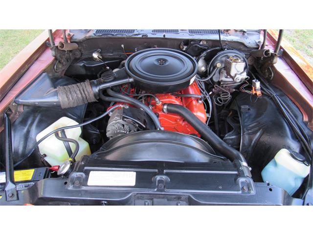

1975 camaro, sports car, cold air intake.

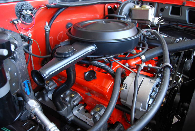

72498
1975 k10 pickup, draws hot air from engine bay.
Even back in 75 we knew.
