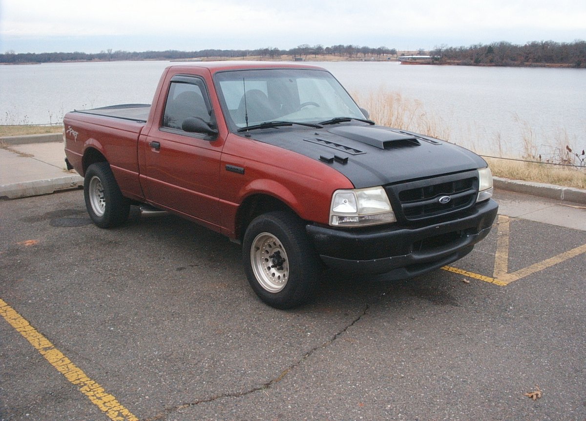

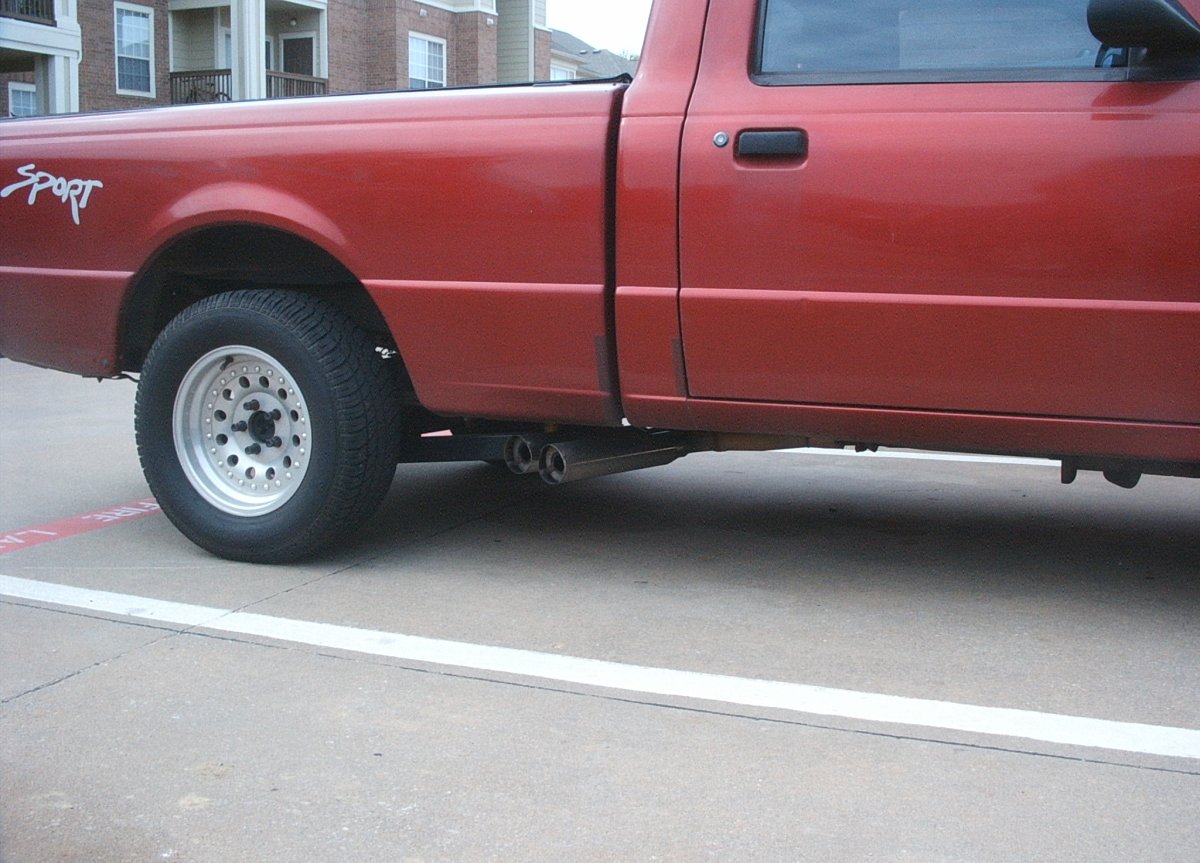

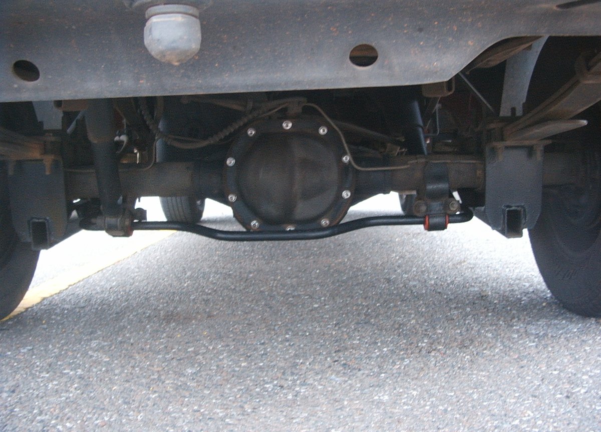

Mine's a 98 3.0 auto. I know the 3.0 gets a lot of bad marks, but I love mine. MAC cold air intake with multiple sources of forced cold air. Dual exhaust in front of the axle. JET chip. 4.10 gears in the axle. Hellwig anti-sway bars front and rear. Only thing I haven't done is lower it, because I hate, no, despise driving lowered vehicles. It's not the prettiest vehicle in the world, but it is my daily drive beater. I have a friend that paints, and may be letting him do an old school all flat black on it this summer. It's not really a dual exhaust. It's minus the muffler with a bent Y and two tips welded to that. But it sure sounds good.
For being a 3.0, I love how it runs. It pulls high into the rev band, something it didn't do with the stock intake. And the JET chip moves the shift points higher than stock. With the 4.10 gears, it 's running truck. There's a really curvy road about ten miles from me, the only one in the area. About 15 miles around a lake, endless style. 45 mph all around. Got a ticket doing 75 on it a few years back in the old Ranger. Cop was cool and only wrote me for ten and under, which keeps it off your record here. She did that because when I saw here, I pulled over and stopped, rather than make her chase me.
I've had sports cars on my tail going around that lake, and they never got an opportunity to pass me. PRICELESS!

Dual Tipped Exhaust
Yup. See the plates in the end. I was playing around with them with different sized holes, tuning the back pressure. I made a whole bunch of them, with holes varying in size by 1/8 inch. Just kept changing them out until I got the desired result. It's loud. A friend's dad, asked me while it was sitting outside his machine shop idling, "What size V-8 is under the hood?" Told him "It's a V-6." He responded "sounds great!"
Intake is a three inch polished tube, from the MAF to the TB, with a large Spectre stainless steel filter. And the hood scoop, a lot of 1.5 inch holes in the hood under it, with six of them impinging directly on that polished tube. And the two small scoops on the side are directly overtop the filter. With another large tube running from the grill to the filter area. I can drive the truck the long way to work around my favorite curvy road, pop the hood and the air filter is cool to the touch. Yup, gets wet when it rains. Hasn't caused a single problem yet. And man, when it rains here, it pours.

Yours is much more highly evolved than mine. I put an extra pair of leaf spring shackles on mine six inches forward of the axle. they help the sway bars and level off the rear end on the twists and turns and campen the effects of axel wrap.
