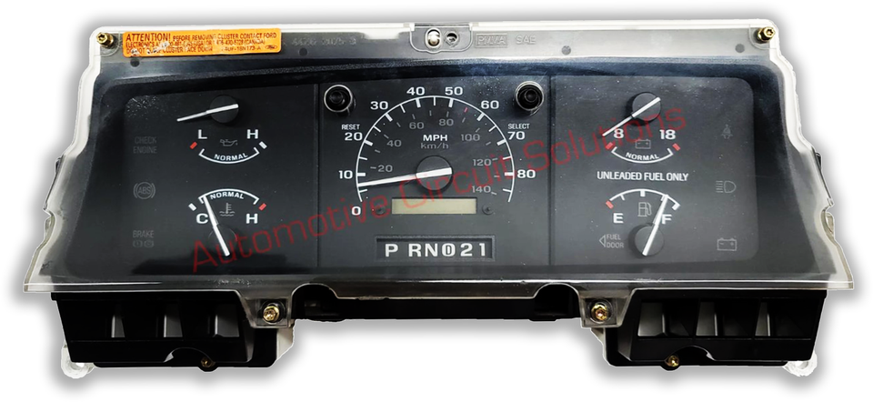

The one on my '94 e150 would do all sorts of intermittent unpredictable stuff. It would go for a long time being perfectly fine, then act up for a bit and go back to being fine. As I understand it, the PSOM clusters all need rebuilding because of the old capacitors failing. The odometer screen part of that system is terrible and of course costs extra to repair on top of the electronics.
Have you ever tried calling the 1800 Ford technical department phone number that's on the orange warning sticker on the instrument cluster?
No. Not sure if any of my clusters have an orange sticker. Definitely not the 2 on the table in my living room. Maybe the one in the superduty. I'm just curious what PSOM stands for and other readers will be, also. So I asked. Not all acronyms are obvious.
Programable Speedometer/Odometer Module. You can change the program a few times for different tire diameter sizes.
My van isn't here with me or id take a pic of the sticker. You're supposed to be careful not to tip the cluster a certain way or oil inside it would leak out or something. IIRC, the 1800 number was to warn mechanics about that. The number was a sex line when I called it a few years ago lol
