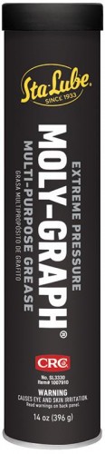

Don't know if was was the best thing to do, but I mixed white lithium grease and liquid graphite (didn't quite have enough of the liquid graphite by itself). The mix seemed to do the trick, though.
Sounds good. Maybe like this stuff
