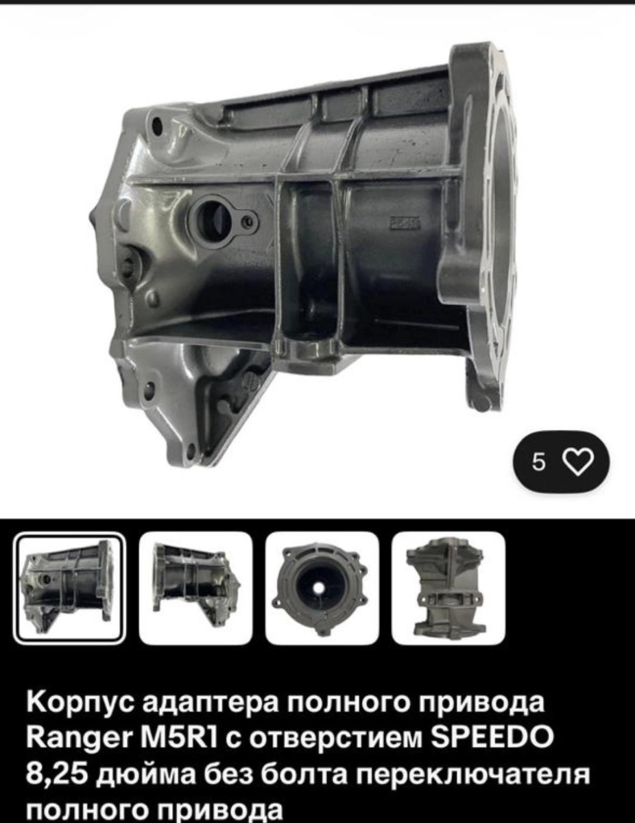

Датчик на механике стоит меж раздаточной коробкой и кпп
На выходном валу , а значит на пониженной передаче он врет на 2.43
Но он так не делает, значит не он мерит на машинах с 2002-2009

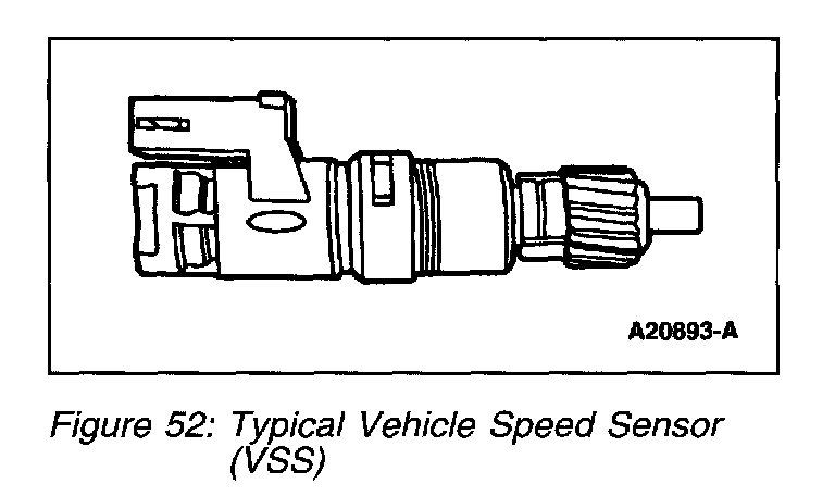

  • Speed sensors
Electronic speedometers are usually adjustable for final drive ratio. Any chance Ford used the same method for low range? Just use the switch on the transfer case to know when to do the extra math?
The sensor on a manual transmission is located between the transfer case and the gearbox. It's on the output shaft, which means it reads 2.43 in low gear. But it doesn't do that, so it's not the one measuring it on cars from 2002-2009.
On a 4x4 truck, the speed sensor is on the output of the transfer case. It should read correctly in any gear.
This is a silly argument.
A lot of people who are active here drive older trucks, hence the general answers, but there's a wealth of info available across years:
"The 2001+ Ford Ranger gets its raw speed signal from the OSS (Output Shaft Speed) sensor located on top of the transmission (not on the transfer case)"
So yes, apparently on '01+ it is before the transfer case. If the speedo on these trucks is correct in 4low, I assume the computer was smart enough by '01+ to correct for being in 4low.
I would not assume the article is wrong, conventional understanding is wrong, the OSS is unrelated to the speedometer, and every truck '98+ uses the RABS sensor and no-one ever noticed.
