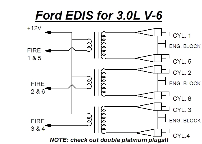

I would question the coil.
Yes they do.
There are actually 3 separate coils in the coil pack. Each coil fires 2 plugs together in series, so if it is a coil problem, there will be 2 plugs not firing.
That would be the first thing i would check after seeing it wasnt getting spark

If the 3 coils are parallel like this:
1-2
3-4
5-6
---------This being the front of the car....
Number 5 isn't sparking. 6 is and so is 3 Hope this helps (sorry if i got the cylinder numbers wrong its ment to show the coils)

I knew they had one big coilpack like that, what I don't know if it is possible for a shared coil to only fire one cylinder. It sounds like you are getting weak spark that isn't keeping the plug clean to the one, probably because it isn't able to recover in time from the other plug.
With new plugs and wires I don't know what else it would be.
If it was a dead miss there is no mistake about it, and you wouldn't be saying it has a lot of power. When changing plugs on my 2.8 I once forgot one wire, it was hard to start and once I got it going it barely ran.
I know its getting absolutely no spark... I can put my finger on it while its running with no shock...Stupid i know. It backfires when I accelerate... So should i run down to the junk yard and yank me a new coil pack?
