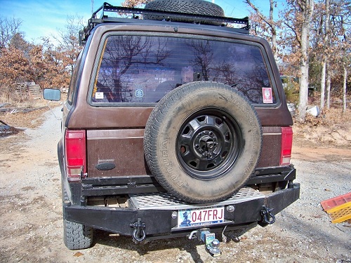

Here's mine I built about a month ago. The silver looking plate on top of the bumper is a hinged locking lid that covers a storage space for my snow chains. The bumper is made from 8" 'C' chanel, slightly modified.
