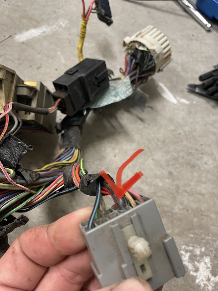

Okay, so I fixed the problem. And now everything is working perfectly.
Bit of a backstory. I originally had a 92 reg cab that got wrecked. Ended up buying a 91 ext cab and swapped my entire drivetrain and suspension to that truck. I guess somewhere along the line ford made a change in the harness that runs along the inside of the firewall. So I had 92 wiring harness’ everywhere except that firewall one. The main plug is missing a ground wire on the 91 harness that the 92 harness needs.
Whew. Thanks for all the input
Plug for reference

That was a head scratcher... way to stay with it and figure it out.
