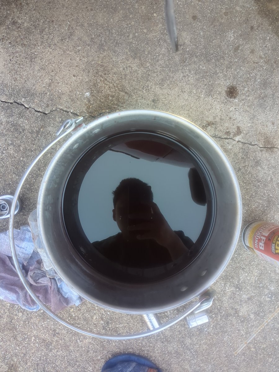

Fill plug won't move and is jammed stuck. Drain plug pictures below with the burnt transmission fluid (only after 30k?). Lots of thin hair like shavings but nothing loose floating in the oil or chunks.
Color of trans fluid (and a free unflattering picture of me). The bucket is grey aluminum. Fluid color of the transmission fluid is a burnt brown burgundy But if allowed to settle the top 1/3rd of it is bright red from picture above.

That looks like a normal drain plug to me. There is almost always a layer of fuzz on them. Don't think into the dirty fluid too much, if it was allowed to go a very long time between changes in the past, it can take a couple drain, refill & drive cycles to flush out all the nasty black goo that forms in there.

I'm going to agree and disagree with Shran a little... that much fuzz that quick on only 30k after a flush and fill is a bit too soon for my blood, couple that with the puking all the time and I think you are looking at doing some trans work no matter what.
