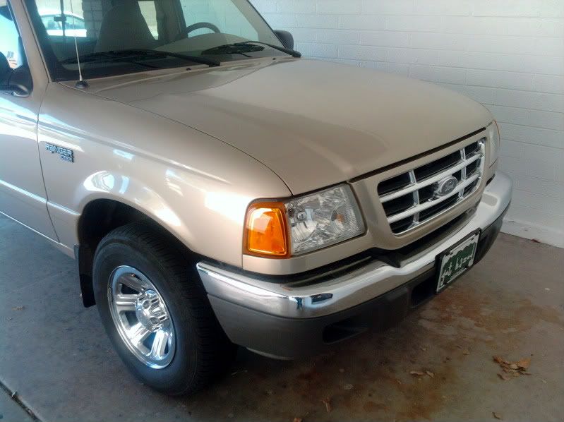

I spend about 90% of my time driving on surface streets. However I also do a lot of camping and traveling. This involves highway driving and unimproved forest service roads. I want to be able to confidently traverse easy/moderate off-road trails with my camping gear without feeling like I am in a rock tumbler on my way to work. A compromise between the two is what I am looking for. Currently thinking of using a long AAL in back to lift and prevent sag under load but using coil spacers up front to help maintain some stock ride quality, along with Bilstein shocks front & back. Any thoughts or suggestions are welcome!
I know people like pics so here are a couple from my car port.
The only changes to this truck are a new radio/cd player and nicer floor mats.
Plan on using 235/75R 15 tire with stock wheels for now.
