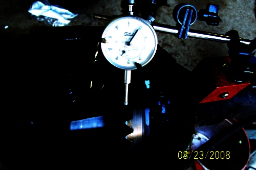

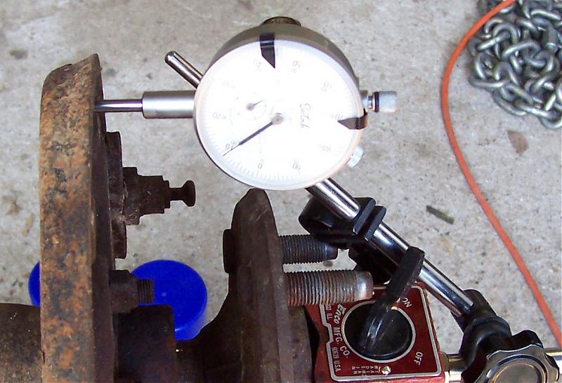

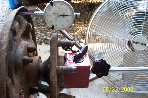

After doing the measurements, it would appear that I do not have "proper" preload on the Pinion, as it has movement and I can't feel any preload! as I only got NINE thousandths of backlash, I think I need more preload and that could very well be my entire problem.

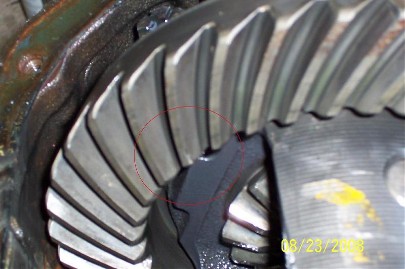

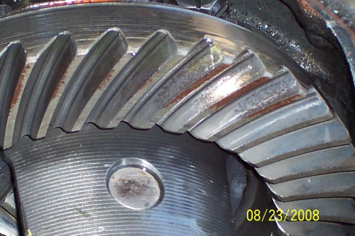

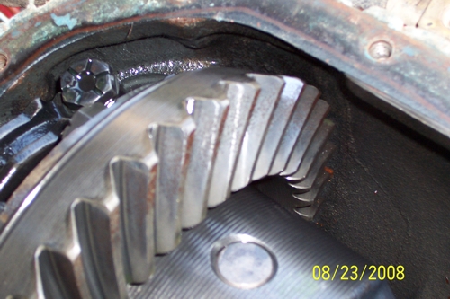

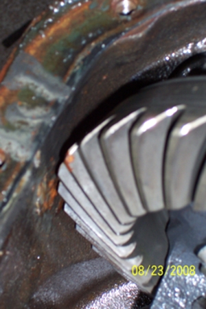

But Give me your opinions of the chips and rust. The picture file name gives the description.
..and this is the chip I am very worried about, its on the inner part of the ring.
I drove on a 7.5 with chunks about 1/4 the size of the teeth missing for about a year, that's not anything that I would be concerned about.
I've been driving on worse for over 2 years, and I purposly GROUND down a tooth so I could get the center pin out, and I ground out a lot more than your little bitty chip... I'm not easy on my axle either, since I blew a spider gear and replaced it (the reason for the chips and such) I've done 3 tractor pulls, pulled two loads to the scrap yard that were over 3000lb each about 25 miles, wheeled hard, rodded the heck out of it, you name it... and it hasn't complained a bit other than leaking oil out either the tube joint or the sensor O ring...
