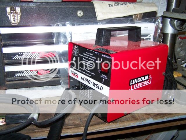

and for the record, i have a welder, but it's a pos, it's a little lincoln hobby weld 110 stick, but my sister's husband has a 220 mig, that i have access to pretty much any time i want... but no access to a pipe bender, cutting torch, band saw, or most other fabrication tools... i do have a grinder, and i can get zip disks for it...

this is my welder...
"Hobby weld"...lol
On a serious note though, little 110v welders have their place even for light fabricating. I have done lots of little welding on my pickup with my dad's 110v. They can get the job done.
I go to the shop at my work though if I need to burn some good welds on some thick plate however, as there is no substitute for a properly setup 220v MIG.
Yeah having all the right tools makes all the difference. I only own a few basics (Miller stick welder, grinders and oxy/act. torch setup) but also have access to eveything else I would need to do a fab project. It pays to know people, and make good friends with them :beer:
