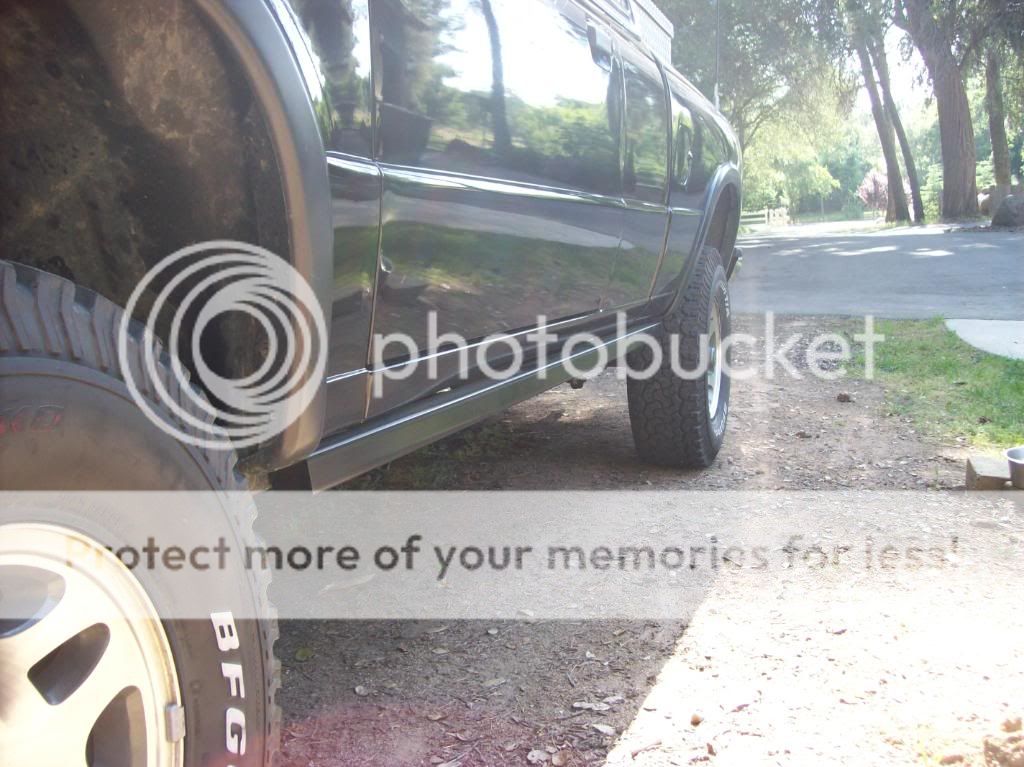

That's exactly like the ones I'm gonna whip up. I need sliders my gf needs a step. Its a win win situation
That'll be enough step?
If I whipped those up and told my girl thats her new step (currently have stock running boards) she would shoot me...

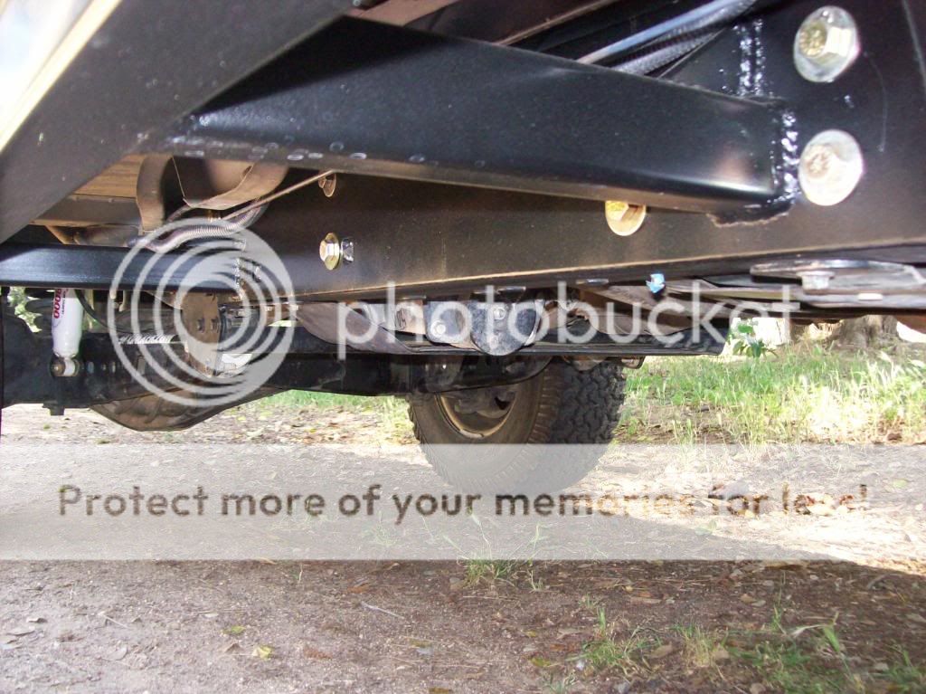

Here are mine. The drivers side was a biotch. I decided to make the mounting plate one continuous sheet, and that way I could put a bolt wherever there was room. Then I drilled holes and cut out slots for all the electronic crap that bolts to the inside of the frame rail.
i like that plate idea! though i think i'm just going to end up getting these welded to the frame...

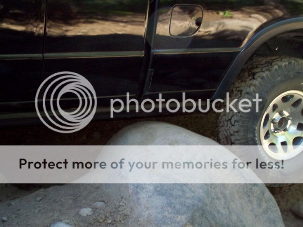

Here is mine... They are on a B2 so they have to be mounted a bit different than the rangers. I beefed up the body mounts and bolted the sliders to them. Only thing I might change adding tubing to the outside... last weekend I got into a stump slightly and barely pushed the door in, it was the same stump that totally wiped out my last door, so the sliders definately helped, just not enough. Either way, they are very strong, and the weak link is the frame rail twisting, but I can jack the whole side of the rig up by the slider, so good enough.
