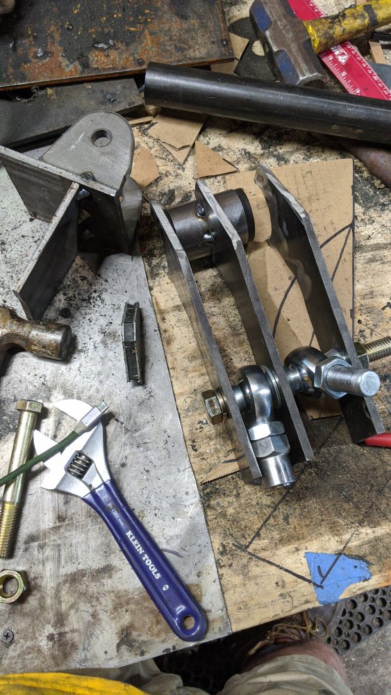

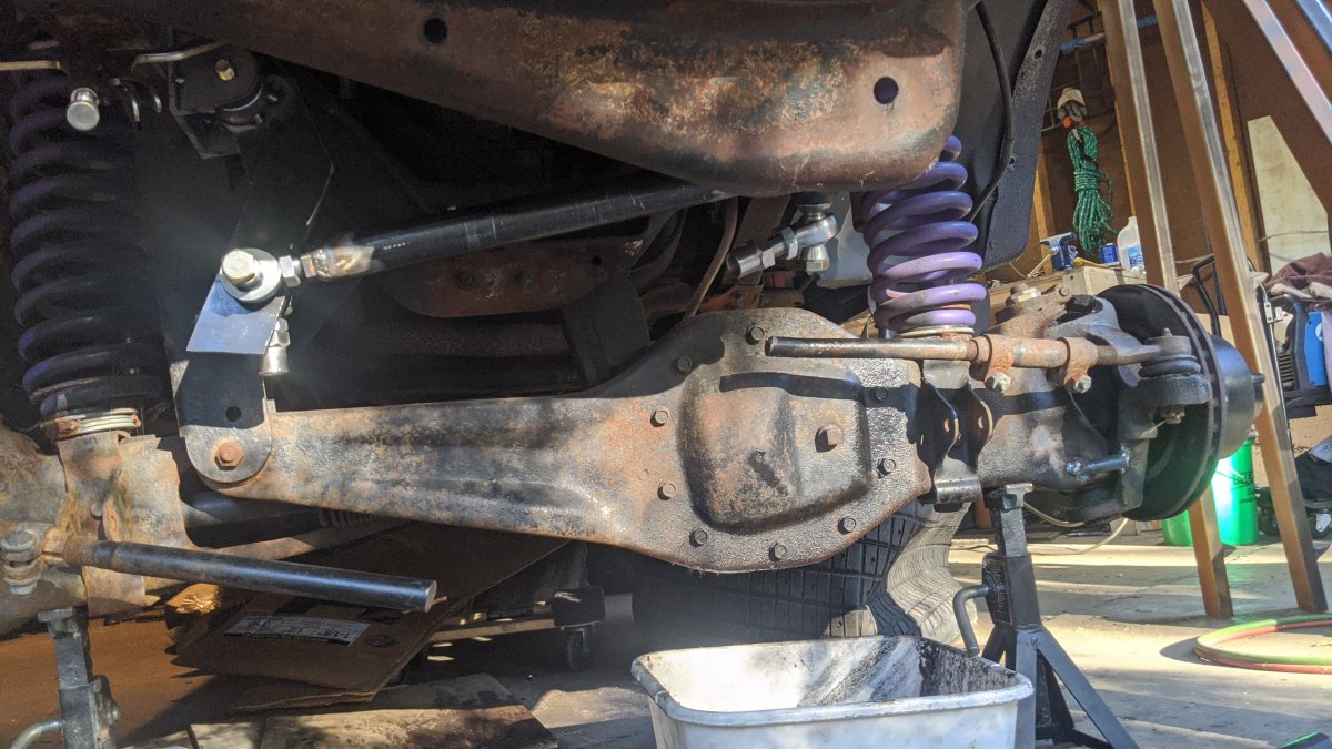

So I have my 1994 ford ranger lifted 6" on the suspension and 1" on the body. Even with the sky-jacker dripped pitman arm driving this thing just plain sucks on the road. Bumpsteer like crazy and just not what I want. I have a welder and for how much people want for a kit that may or may not work i said **** it im buying a tube bender and building my own.
First thing i did was pick up a heim kit from barnes 4x4. 4 3/4 heims with weldable bungs and spacers. Next up I went and looked at 100s of photos online of the steering to figure out what i wanted to do. I emailed and asked some companies about how to design it and never got anything back from them besides buy our kit.
45480
Here is day one of my build i welded the knuckles in place so they wouldn't move at all to keep everything straight. Since this is a single swing set up the lower heim coming off the pitman sets the hight for the idle swinger. This is going to be 22 1/2" from the floor in my case. Next i measured the distance of the pitman from one hole to the other which is 6.5", this sets up i designed my idle swinger to have the same turning radius as the pitman arm.
45481
45482
Two different ideas i was looking at. i went with a mixture of them both in the end youll see.
45483
Here with the idle swinger starting to get roughed in. On that link from the pitman to swinger its 22" long with one adjustment. The photo is a little warped looking but the heim off the pitman arm and the heim on the idle swinger are the same height off the ground.
45484

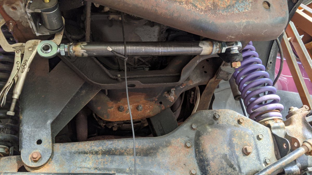

Here is the first Tierod end getting roughed in now. I am using the stock ends so i can still get alignments at any shop and they are replaceable. When i do the 44 knuckle swap in the future it will get heim joints.

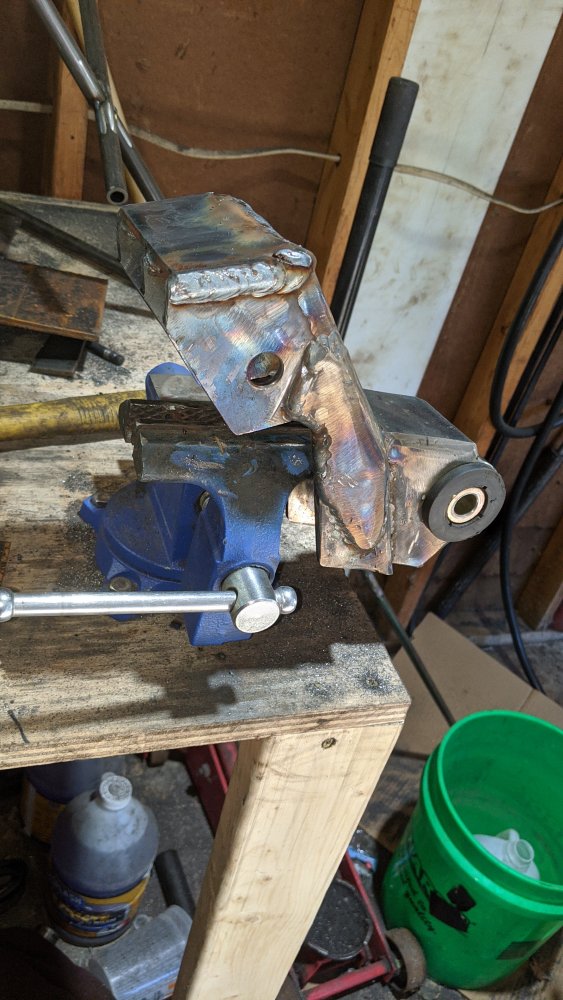

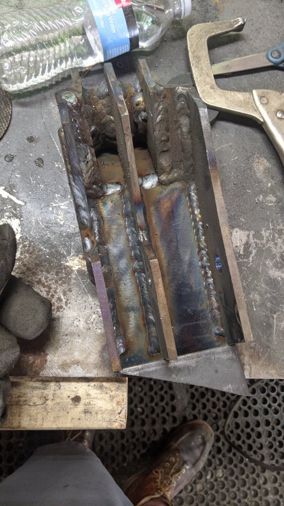

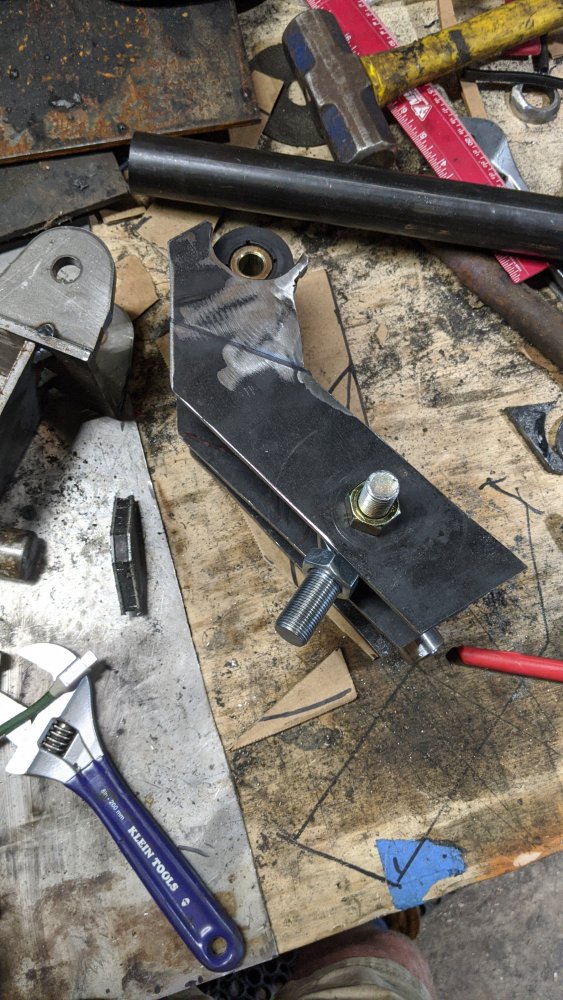

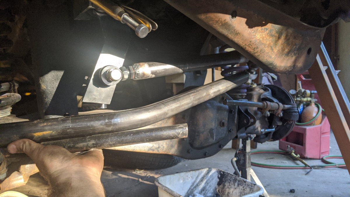

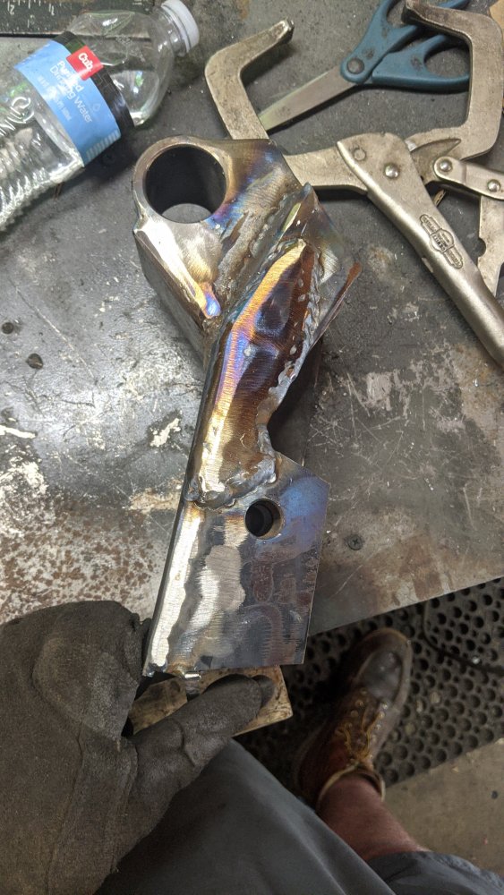

Once I figured out which tierod goes where i was able to weld this idle swinger all together. The entire thing is 1/4 steel.

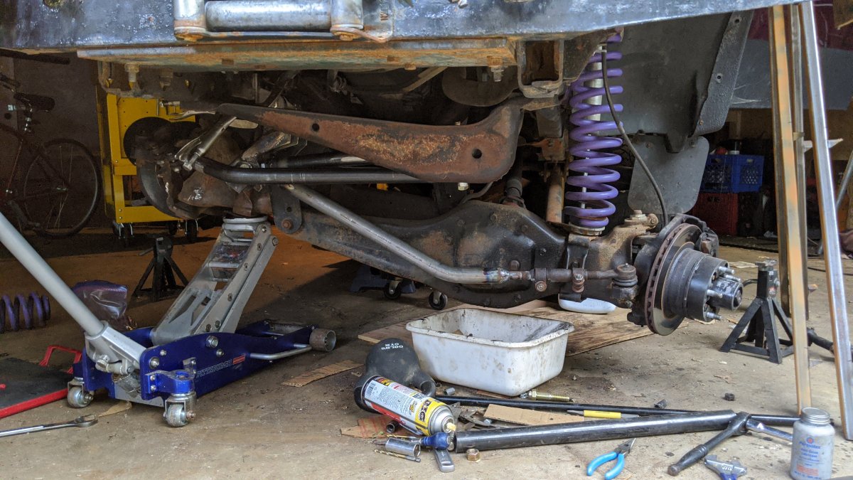

Anyways Ive done some more looking at my set up and I need to push out my drivers side tie-rod even more. If you plan on making your own you will need this diagram here. You NEED to have your steering in line with the RED lines, my driver side tie-rod need to be longer to help with bump steer.
45531
Back to my build now
45532

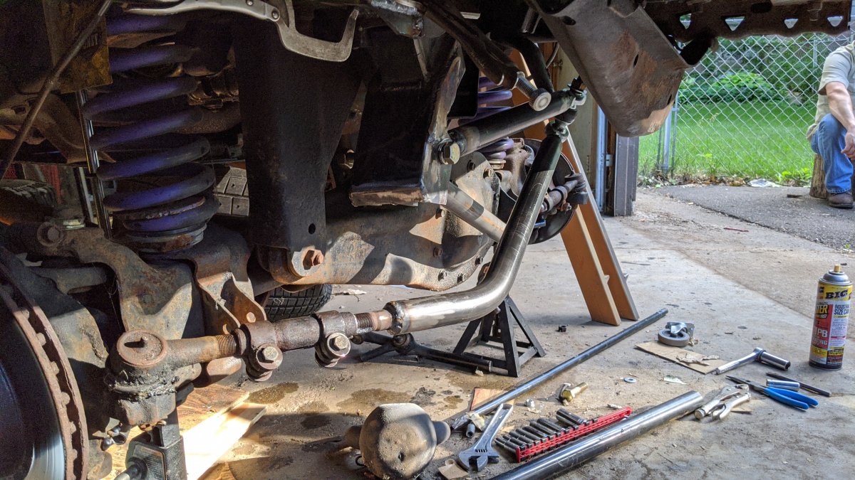

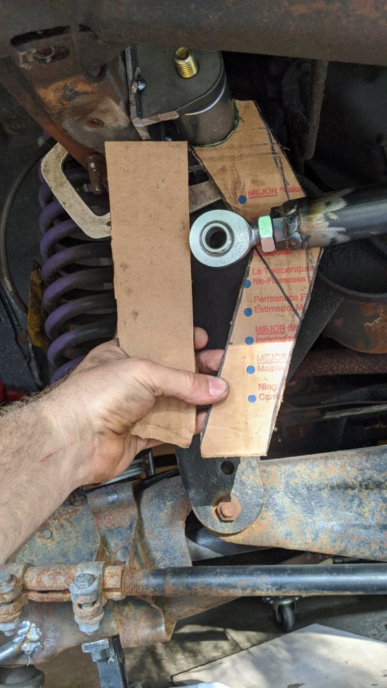

This is just the passenger side done up. My old tie-rod is the same side as the tube ID of 1.25", I just cleaned it and measure where to cut and boom. It slides right into the tube and i just welded it hot as ****. I don't plug weld even though i should but i have yet to break any of my welds yet.
45533

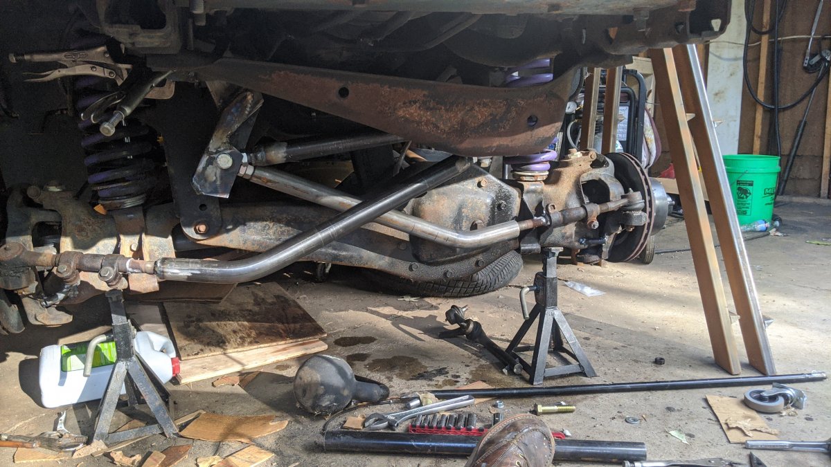

A second angle on this madness. As you can see i haven't decided where im going to put the idle swinger exactly to clear everything and also how im going to mount it in the swinger to the frame. I could weld it but i want to be able to remove it. There is a big square hole in the frame I could use to finger the nuts through..... but that also means i have to drill the thickest part of the frame.
45534
45535
45536

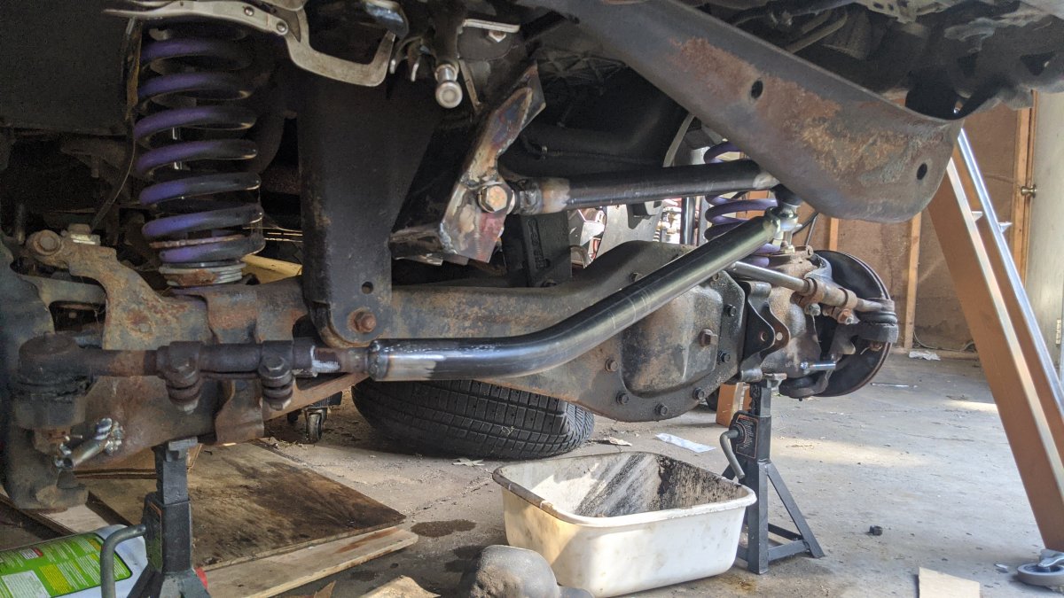

This is where i am at now. I have the passenger side fully welded up and I am fine tuning the drivers side. Everything clears each other right now but I need to stretch the center tube to make the drivers side tie-rod longer. That will put it more on its red axis and help eliminate bump steer even more.

random question/ thought... why didnt you just get rid of those stock ends and built the tie rods to go all the way to the knuckle and attach with a heim like everything else?
also, have you accounted for any ackerman angle?
For reusing the stock ends it makes it so I will be able to still bring it any shop and they will still do an alignment. Also I can get off the shelf part too still. Once I get my 44 knuckles prepped and ready I will do double sheer heims.
I'm no genius but for Ackerman angle it should still be close to stock. Once I get my driver's side beam done up I'm going to cut the knuckles loose and see how bad it is.

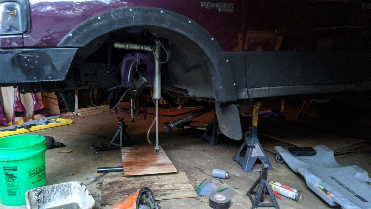

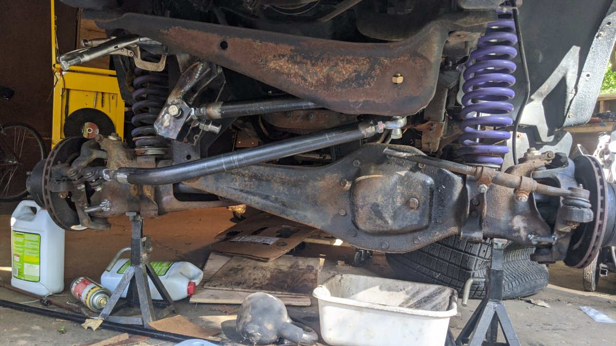

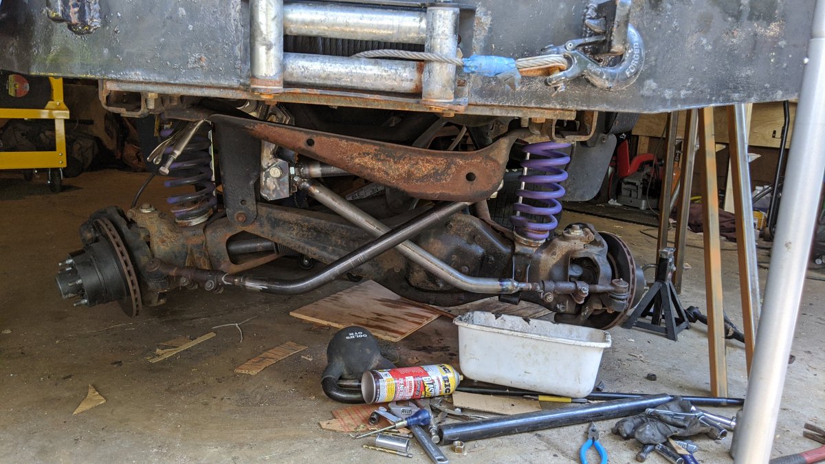

Nearly done here. Ive got about 95% up and ready but i just need to tie up a few loose ends.
45849

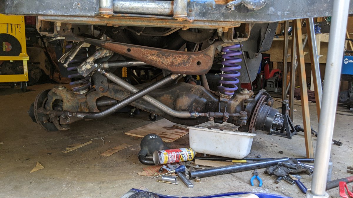

Lock to lock here
45850
Tucked on one side and drooped on the other side. I had an issue with the extra hanging off the swinger hitting the bottom so i chopped it down about an 1 1/2 inches.

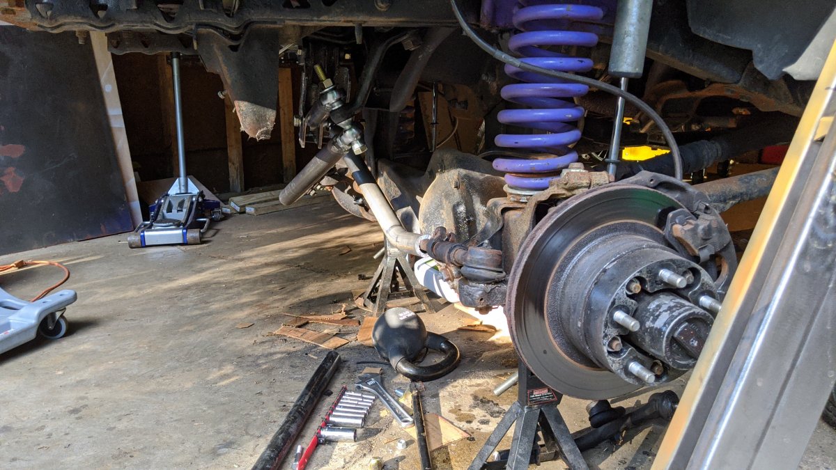

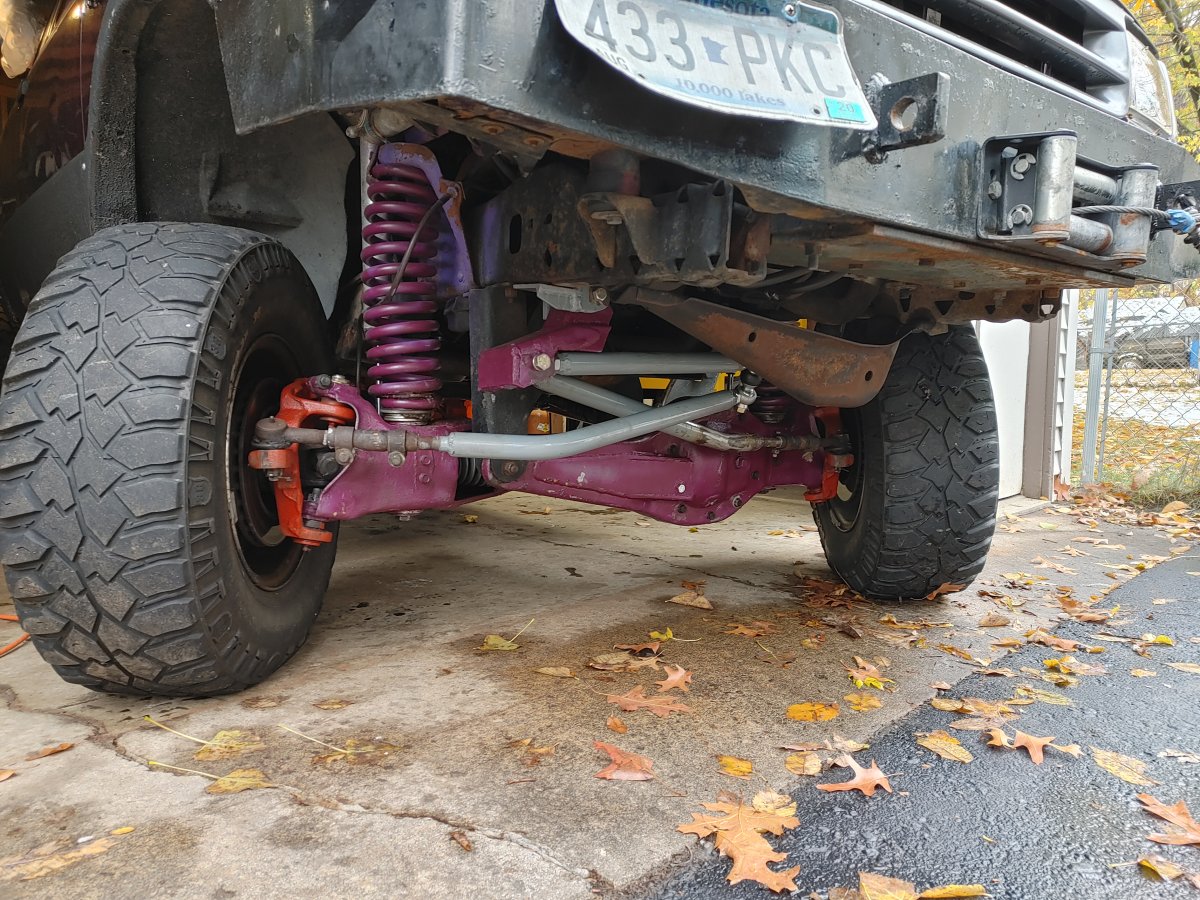

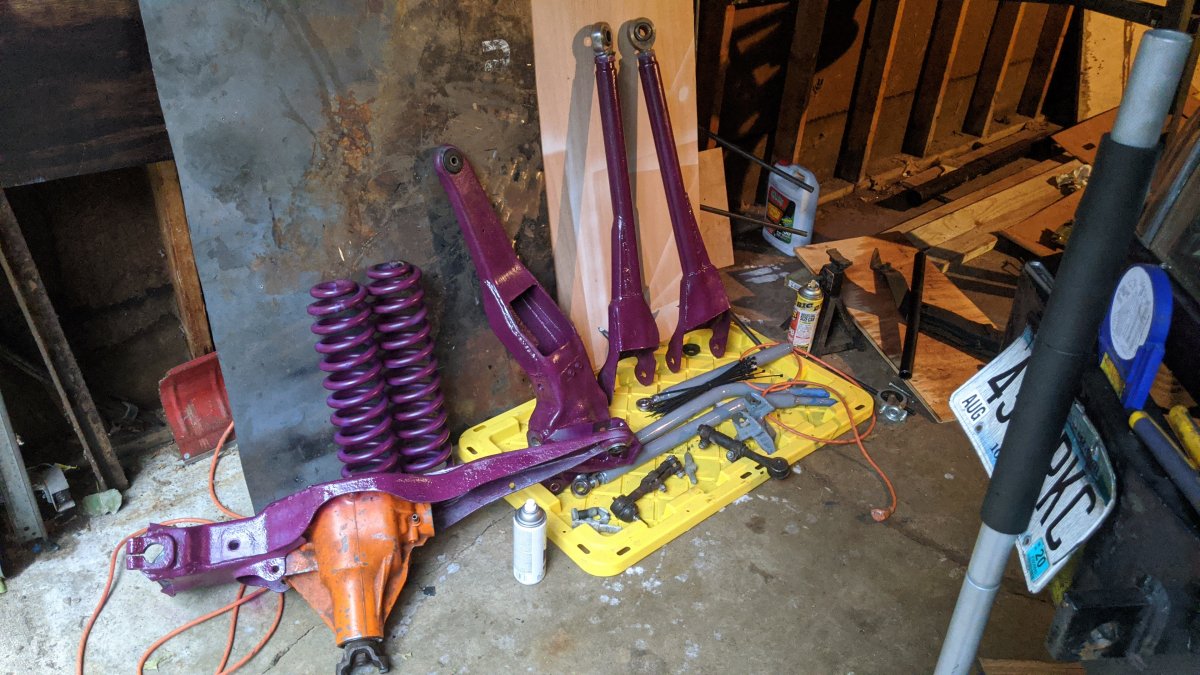

I currently have everything apart right now and am etching in so i can paint. Next up the beams are coming off and theyre getting plated. I think i bent the drivers side drop bracket because the passanger side beam hits it on full tuck.
46391

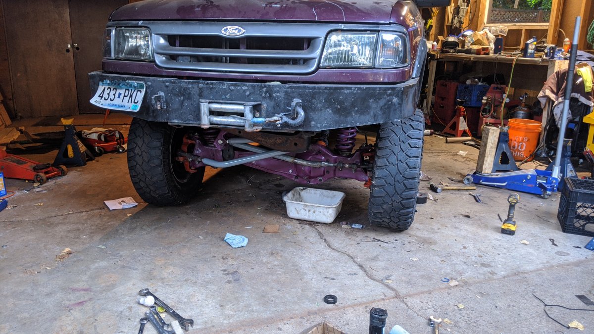

Heres how it sits right now. The axles are plated and everything is painted to match the truck. All new bushings, bolts, and resealed my diff that was leaking and checked my gears/locker.
46395
Ive gotta pull the transmission and rebuild it so that sucks but once its done Ill finally be happy.

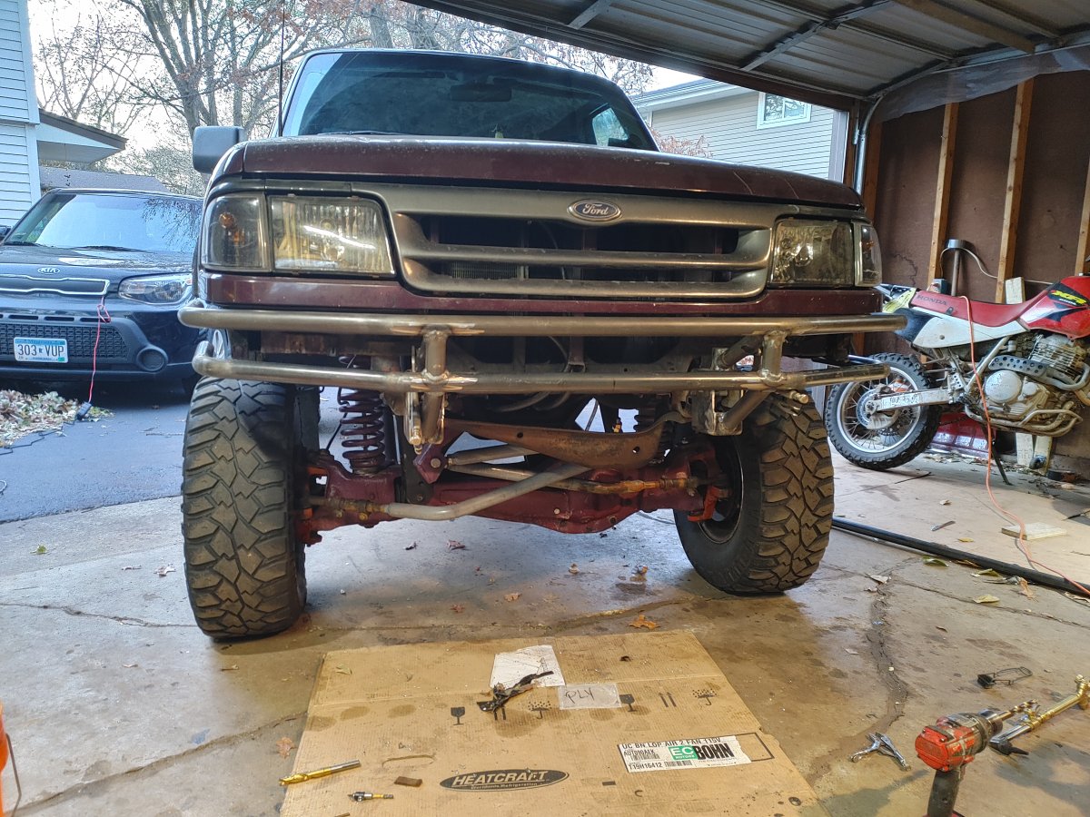

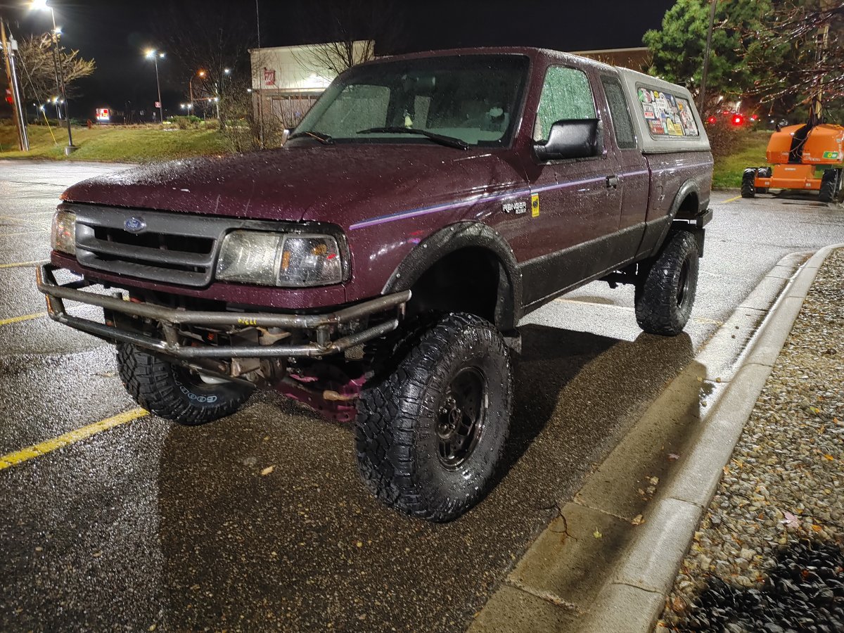

So here is what is looks like done. Don,t mid the alignment that's just ttb being weird for ya but the steering works amazing. Just with my few laps around the neighborhood, some curvy roads and hopping up and down curbs its beautiful. No bumpsteer or weird pulling on the steering wheel.... It drives like a 10 year old truck instead of a 30 year old truck.
48227
I ended up straightening out the drivers side tie rod because it just didn't need so much bend to it. Ill have to get another chunk of dom and some more weld in inserts to redo it right. I also added a small drain plug to the bottom of the front diff to make my life easier. Ive gotten some interest online about making this to sell but I don't think that will ever happen, Although i was thinking about making a video online about how to design your own single swing steering.
Anyways im going to try to break this now and see where i can make it better. Also time to start working on a 44 knuckle swap.

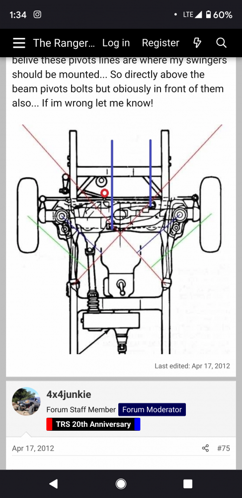

I apologize, somehow I must've missed this post before...
Looks like some nice workmanship here, but to have the least amount of bumpsteer, your tie rods need to not just be on the red lines in that diagram, they also need to be on the same horizontal plane as the axle beam pivots (you have yours mounted much higher up than the beam pivots). I don't think it will be possible to do this on a single-swing setup with a 6" lift, you may need to go to a double-swing setup.
(you'll easily be able to see the knuckles steer themselves left & right as you cycle the suspension up/down if you have the truck supported by the frame and remove the front springs)
IMO, I wouldn't suggest you get too caught up on matching things up with the red axis lines... The tierods being on the same horizontal plane is much more important than them being on the red lines.
Perhaps you also came across my K-link steering setup in your research... The tie rods on mine indeed are somewhat short to match with the red lines, but they are on the same horizontal plane as the beam pivots. I've been running this setup for a couple decades now and have never had complaints as far as handling or tire wear, both for street and off road (I helped a friend build a similar setup for his, and same thing, he says it handles exceptionally well, and he's been driving it for a couple years now). I've always liked the K-link because of the simple packaging of it (there's no need for large bends in the tie rods in order for everything to clear everything). Whether converting to a double-swing or starting over with a K-link is less work, I'm not sure, though it's possible you may be able to use the swinger you already built to handle the opposite end of the centerlink needed for a K-link (the bushings on your idler arm swinger, as well as on the centerlink itself I'm thinking should be able to absorb the slight difference in angle of movement due to the axes of your sector shaft and the swinger being different).

Yeah this set up definitely has its issues. The only was to do this right is either get rid the drop brackets and cut n turn the beams or double swing steering. Ive only been able to drive my truck a little bit since I finished. Its light years better than the stock steering with a 6" lift drop bracket. Id love to drive your truck with k-style and compare it to my single swing set up.

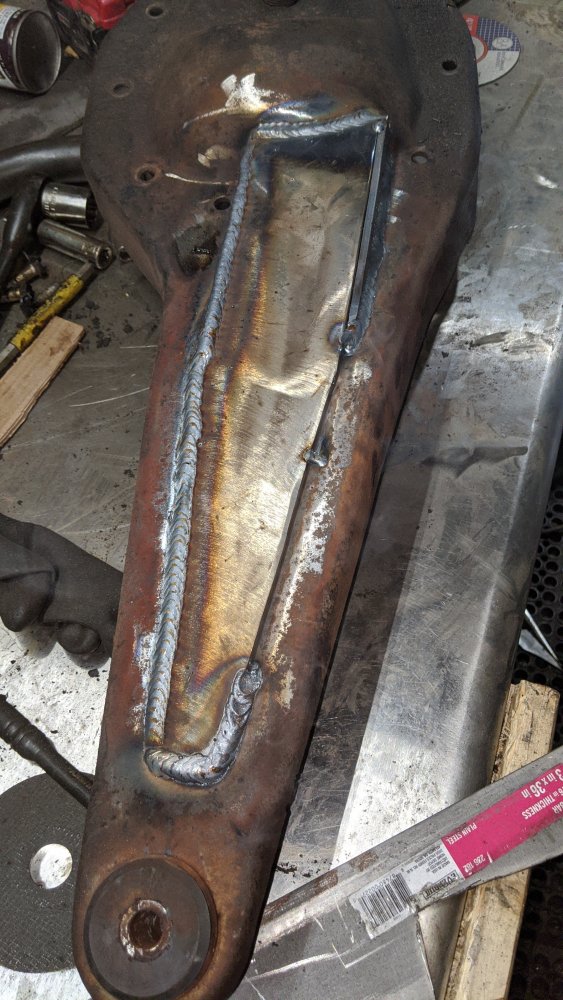

I might also add, reinforcement of the lift bracket holding the driverside beam can boost it's durability a good bit (as well as the suspension's ability to hold a wheel alignment). That looks to me like an early-style Class-1 Skyjacker bracket, on which some of the mounting tabs where it attaches to the frame are known to break.
It's a bit hard to see in the pic I posted above, but I added a plate against the inner edge of mine to give it a larger mounting footprint that extends further down the front of the engine crossmember. All of the mount tabs have been gusseted as well.

I might also add, reinforcement of the lift bracket holding the driver side beam can boost it's durability a good bit (as well as the suspension's ability to hold a wheel alignment). That looks to me like an early-style Class-1 Skyjacker bracket, on which some of the mounting tabs where it attaches to the frame are known to break.
I was most worried about this I wasn't sure what kinda of kit these drop bracket came out of. I am going to get to re-enforcing them now since I got bigger tires.
