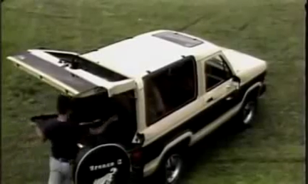

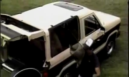

Here is frame capture from a Motor Week episode "1984 Ford Bronco II". I don’t think this was the review I was thinking, there is a longer version of the same era where the host does the window R&R.

Very, very interesting.
I wonder if it was something they showed off but never made it into production.
That's my thought. Like I said previously, no one on TRS has ever been able to provide any confirmation of one in the last 15 years, including AllanD.
You've heard of pre-production vehicles, yes? All of the media gets pre vehicles to "test" After plenty of exposure the vehicles tend to end up crushed. The removable windows are illustrated in my 84's owners manual, but they never existed in real life. I removed a set of glass panels and, using 8" pipe, bent sheetmetal to the correct radius, with judicious trimming, and welded them to the body. With approximately 9 million tack welds and lots of grinding, body putty and sanding. No windows.
