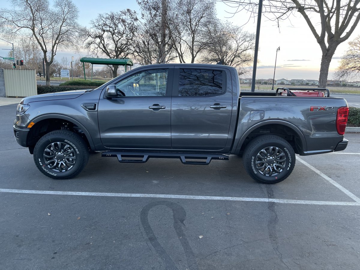

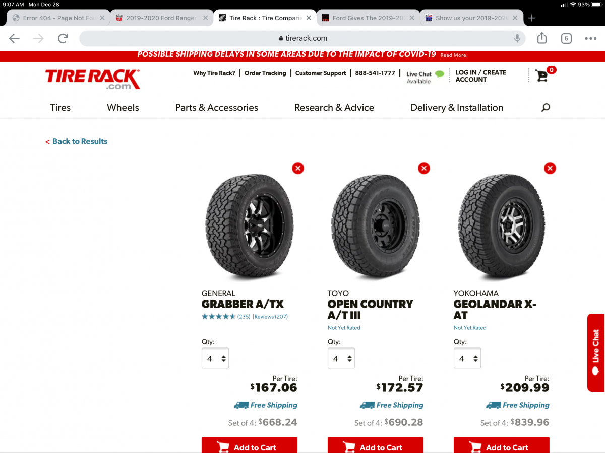

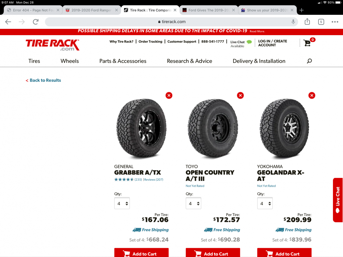

Been a week. 2.5” Rough Country leveling kit. N-Fab Epyx runners. Max liner floor and bed mats.
Time for some tires.

Grabbers are loud, obnoxiously so, but as an all terrain tire I like them. I would not buy them again for a truck that spends most of the time on pavement, but for something that spends mos of their time on dirt roads or trails I think they would be great.
Good to know. I will be racking up a lot of freeway miles.

If you're doing a lot of highway driving, you can't beat the BFG KO2s!
They're going on mine
Let me know what you think if you beat me to it. I lost faith in BFG a few years ago but you never know. They may come back
Lose faith with BFG or the KO2s specifically?
I've been running KO2s on my last 2 trucks for 5 years now. They're amazingly quiet on pavement, and excellent traction off-road.
