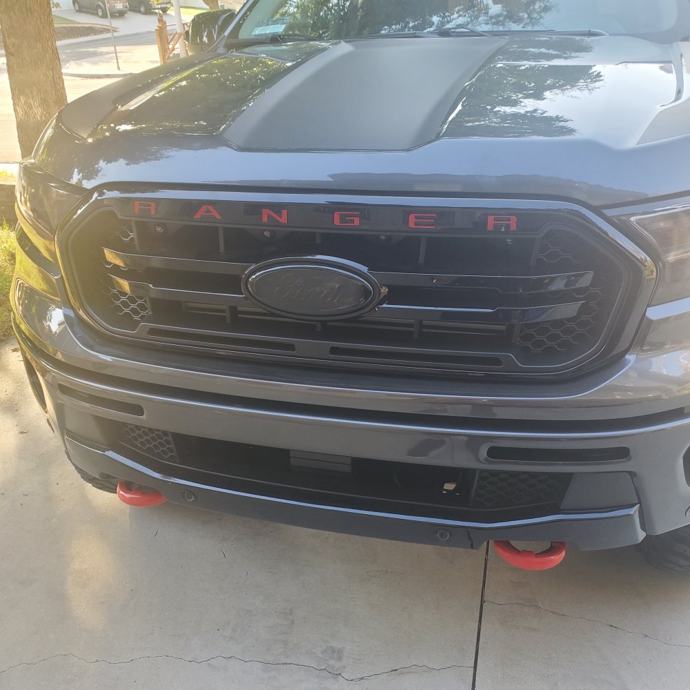

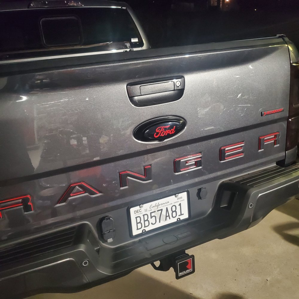

couple more updates 1.5 wheel extenders and some red highlights
more to come

bully dog tune , bov , amber fog lights, and some more red accents then wrapping the back to with with my buisiness and i should be all done after adding in a lill more bass

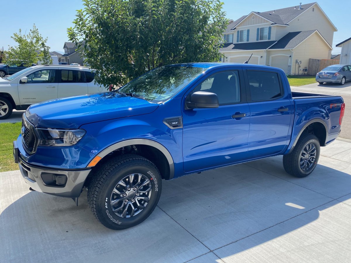

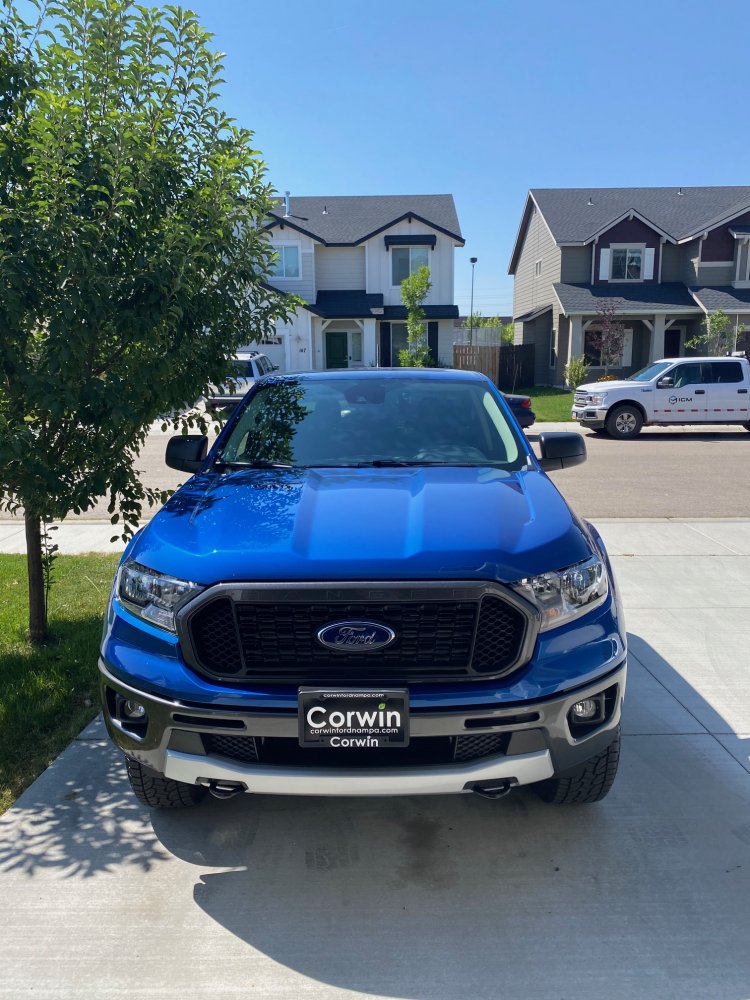

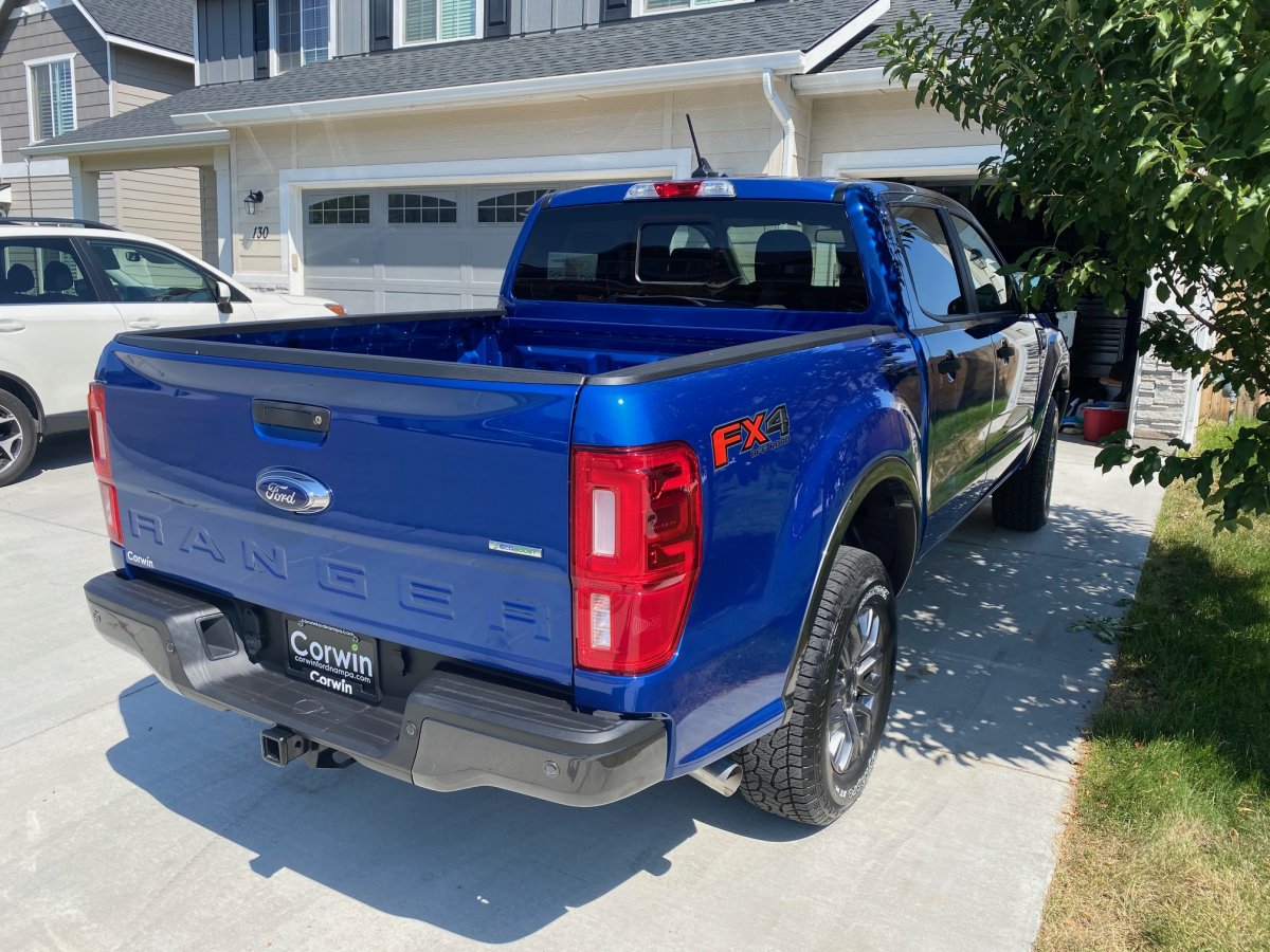

Here is my 2 month old baby. So far so good. I am planning on doing an exhaust and air box modifications plus a 2.5" riser for the front end.
It is nice and quite and comfortable. I added on the mud flaps and black nurf bars. I also had the windows tinted to match the rear windows. I like it a lot so far.
