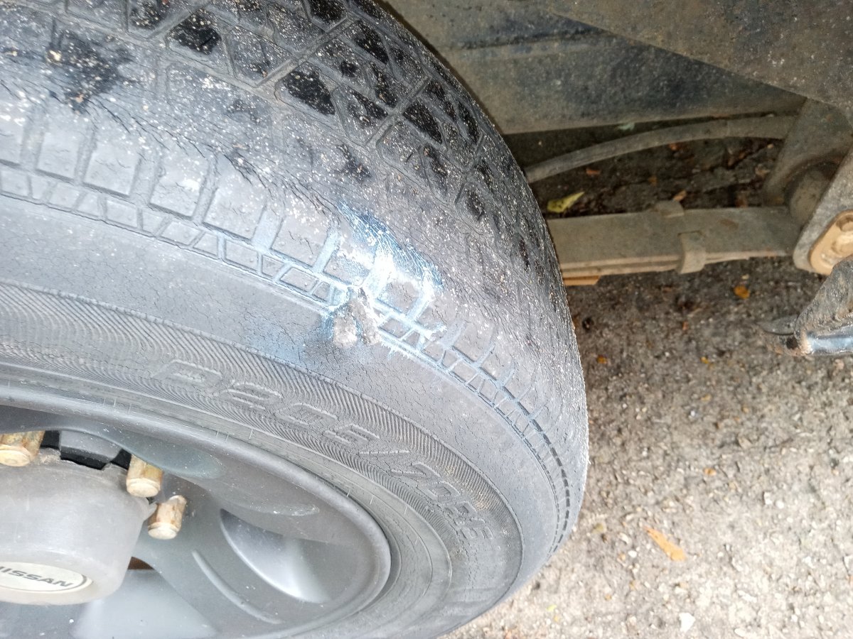

This tire was born in 2012:oops:. Dry rotted AF, but the plug held until I got home Saturday. Sunday, tire still had air. I am in the market for 5 new tires.
I have a plug in the same spot on my old ranger work truck. Its still holding the same air as two years ago. It might need 5 or 10 psi top off by now.
Even I wouldn't have tried to plug that. I salute your bravery. :icon_rofl:
