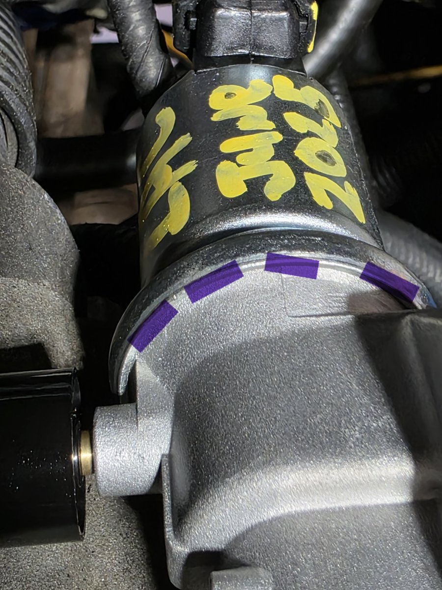

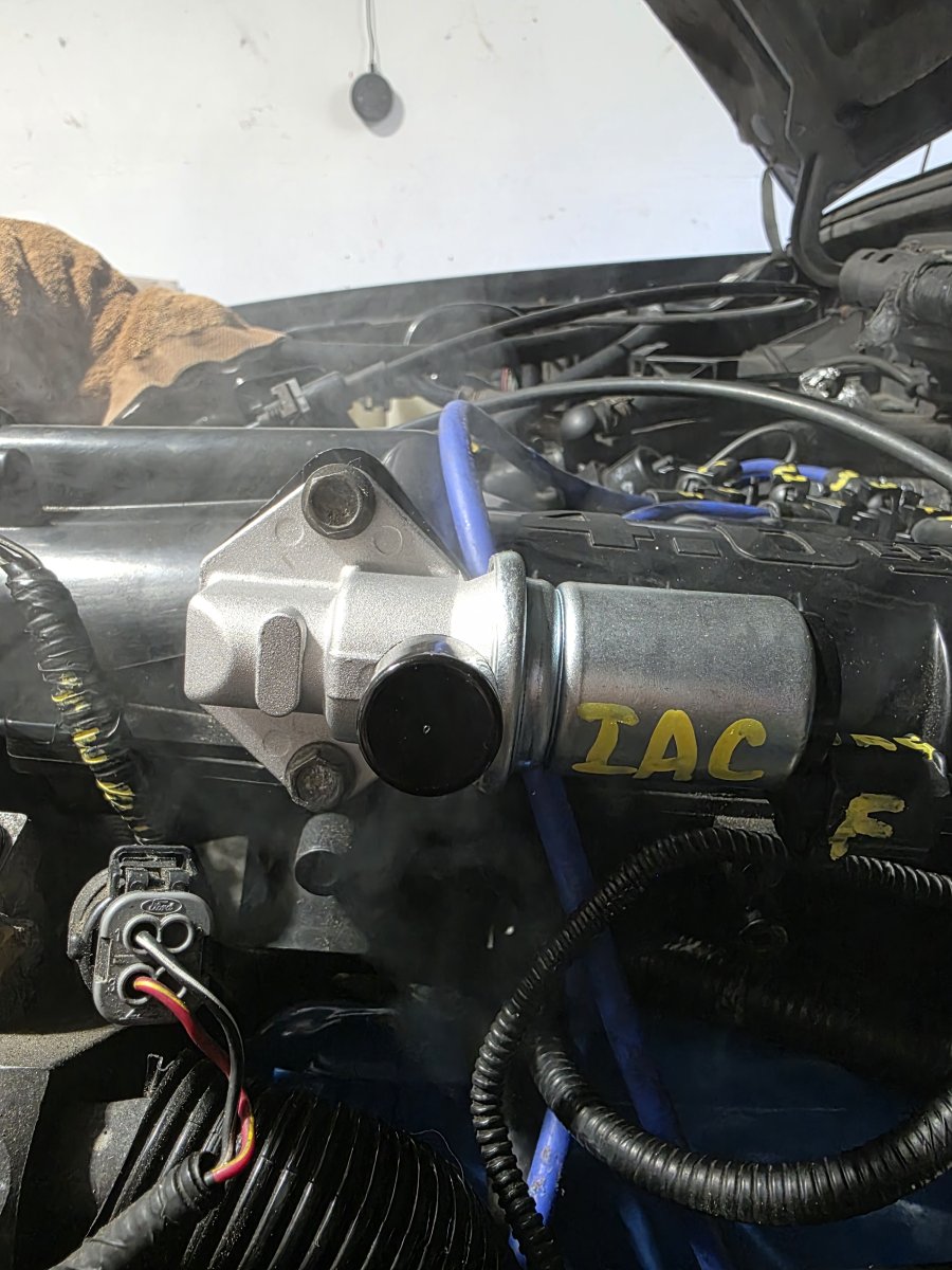

So my 1999 Ranger 4.0L OHV is still running awful.
I put a smoke machine on it this morning after replacing the IAC and the new one
leaks as badly as the old one I replaced. I replaced it because I couldn't believe it should leak like this.
Is this "normal"?
I can't see how it can work like that. Under vacuum the engine would be pulling unmetered air through that...

My bad, missed the part of it being on a smoke machine and thought the engine was running. But If the pvc valve is stuck, crankcase pressure can build up instead of being relieved. It’s hard to get imagine a smoke machine building up that much pressure.
I just tried to blow through a spare IAC valve and couldn’t get it to leak where yours is leaking. Don’t know if what you’re experiencing is normal or not.
No problem! Thanks Jazzer. I've ordered a true Motorcraft IAC from RockAuto. Will come back with a report when I get it and have it installed.

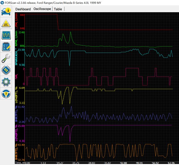

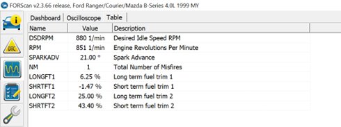

Returned the TRQ and installed a new Motorcraft IAC. Idle is under control, but the engine is still running very lean on bank 2. Also replaced the spark plug wires with Motorcraft. Again that seemed to help. But something is still really out of whack. I left the Ranger off with a local mechanic shop to do a diagnostic for me. Gave him a list of all the things I have done so far. Keeping my fingers crossed!!!
Here are the ForScan images of the issue:

Problem solved! The Ranger is back on the road and running great.
The primary problem was that I switched sparkplug wires 4 and 6 by mis-reading the wiring diagram. Counted from the wrong end!!!
EXPENSIVE mistake!
Secondary issue was the Throttle Position Sensor (TPS). I had replaced it with a Motorcraft one from eBay, but it ended up being bad.
