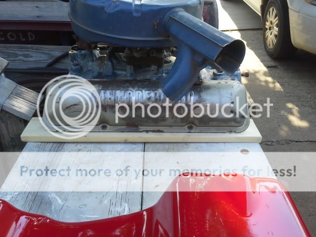

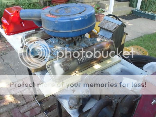

Here's the top side of the motor in mock up

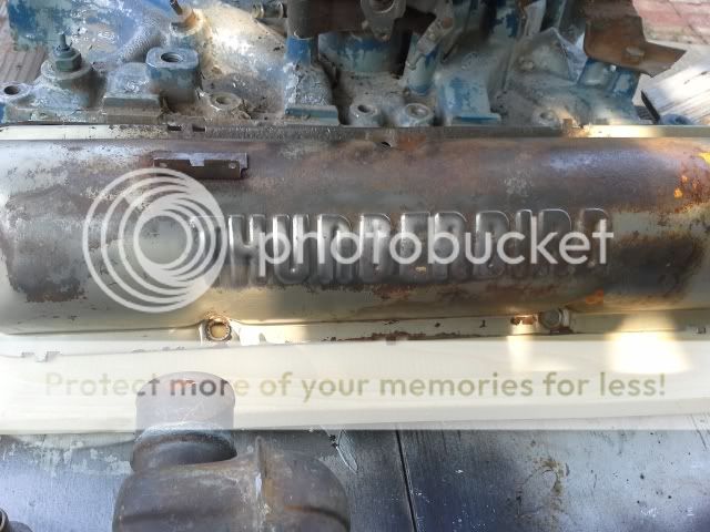

FE Valve covers and overflow tank.

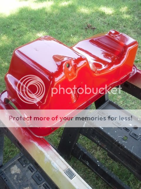

The oil pan is painted cherry the color I plan on painting the tins on top.
the intake is a 84 Ford truck, i think it had a Variable Venturie Carb. I'm using the 67 2 barrel instead.
I will make a adapter to allow the FE valve covers to mount to the windsor heads.

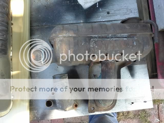

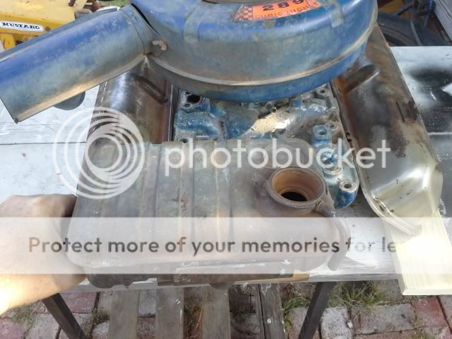

and for the FE coolant tank will need mods as well.
I have the thermostat housing from a 78 Mustang II. I will trim the curved part of the FE tank and the mounting bracket off... using a piece of hose to connect the two!

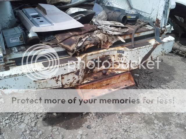

I've been shopping for large bumpers to adapt to the back of the truck this one was calling my name at the local you pull it!
Another look at the freshly painted oil pan.

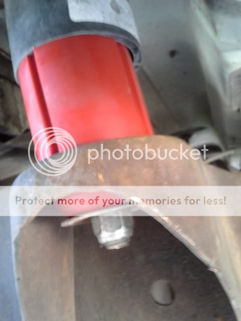

What I don't have Pic's of are the new Poly cab mount bushings this lifted the cab another 1/2 inch.
FrankBoss
OK just a note to all early ranger owners... I love the new cab bushings! Honestly I didn't expect much, I'm impressed with most of the squeaks are gone and the ride feels less harsh.
Old Bushings
New

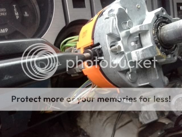

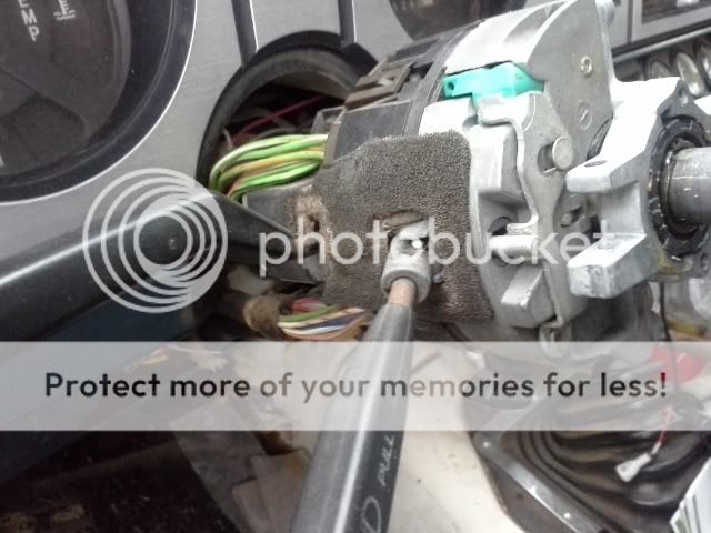

I haven't been able to do much since I've torn my other Bicep, and I have surgery in two weeks. So I have to have a kid help me when they are available. To day in between rain storms I was able to replace the turn signal switch. That thing was driving me nuts!!!
The old lever went limp and quit working... so hopefully this will make the local Police happy!
