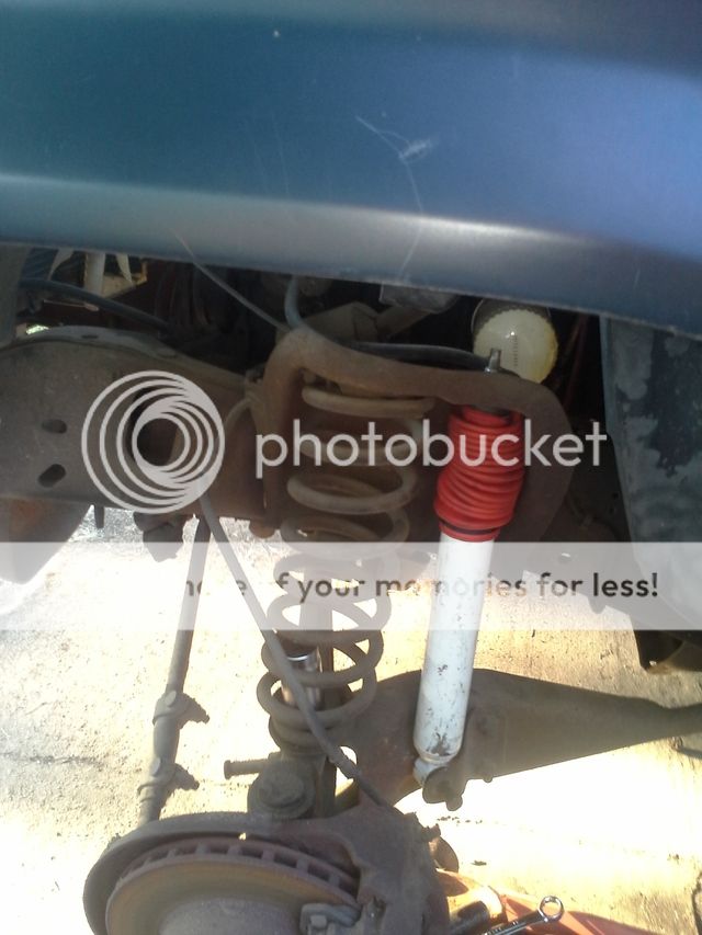

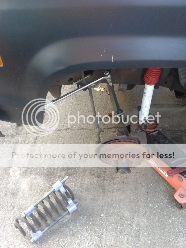

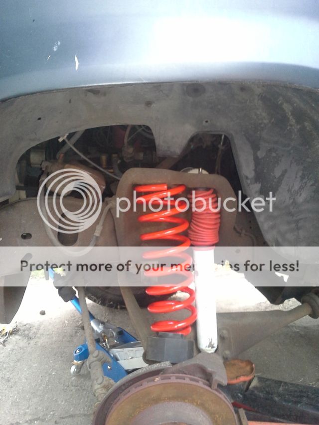

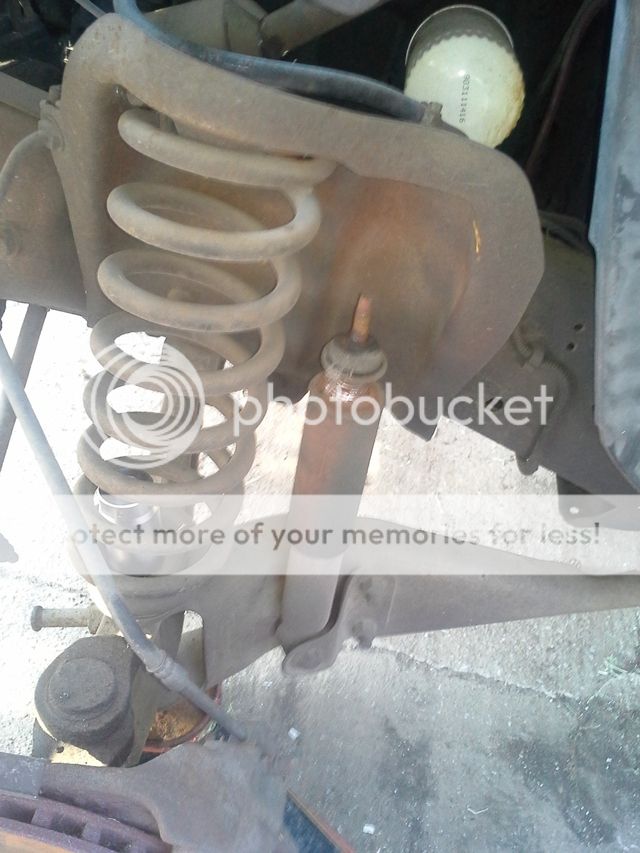

Pulled the front wheels today to replace the shocks and add the spring spacers...
Dam shocks where getting beet up sitting in the tool box....

Looks like I'll need longer brake hoses...
I would like to up grade the power brakes to a dual piston calipar. But for now it is what it is.

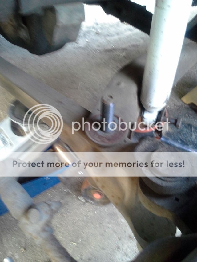

I started pulling parts, Kinda hard on my arms to tackle it all at once so I'm doing it in steps. The plan is to clean and paint all the parts, New poly bushings and reassemble with a 2 inch spring spacer.

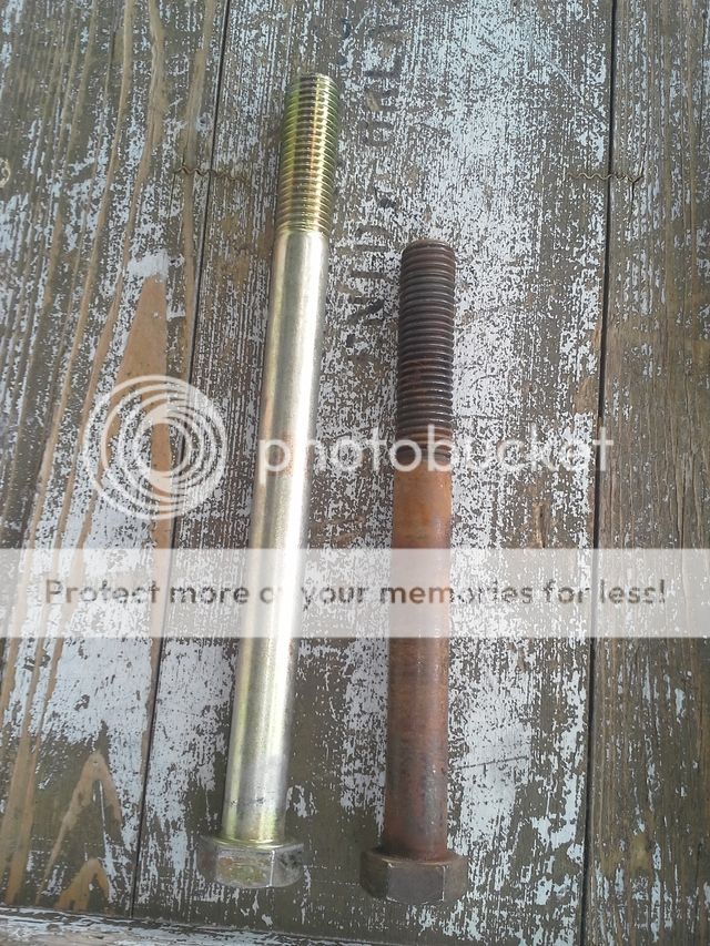

I bought a new bolts to reach threw the spacers, first I have to figure out how to get the old ones out...
FrankBoss
I got one of the spring perch mount bolts out, not as bad as I expected.
So I ran into a little hick-up, the new bolt isn't threaded as long as I needed...Crap!
I still plan on cleaning and painting parts as I go... while I figure out how to thread this.

Another thing I think you should take into consideration; the bolt threads are formed into the bolt, not cut like a threading die will do. So cut threads are weaker than formed. And you may have problems cutting into grade 8 bolts, especially with a one piece die.
There is a toilet bowl cleaner that cost a 1.00 a bottle, it comes out blue, it will remove rust and paint from steel, just don't use it on other metals, it will eat aluminum, and brass, and copper, it will also stain stainless steel.
Good luck on trying to threading that bolt if it's grade 8, i ruined two dies trying to tread one, I went to Tractor Supply and got the right length that I needed, and they where pretty cheap on the price too, you buy by the pound.

Tractor supply ...awesome! got one not far from here.... I bought these from Fastenal not cheap :(

Yesterday made to rounds to all the bolt and fastener suppliers in the city, and didn't find anything to work... so I'm putting the old bolt back in and making my own stud extenders.
The plan is to use Coupling nuts and the treaded ends of the bolts I have already bought, Lock tight the two together,,,,

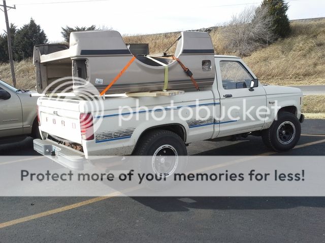

but this is what I was after a nice short bed off a 93 sitting in the yard with only two bolts left holding it on. i called my kids to haul it out and put it on the truck..
