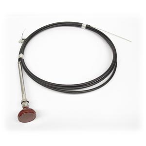

I know the difference betwixt a Bowden cable (such as the one in the attached pic) and a flexible cable, and IMO the Bowden cable would be the way to go.
An "L" bracket underdash for the handle end, an anchor bracket on the transfer case, and a lever to replace the knob on the Shiftster......Done deal.

^^^ I'm pretty sure the shiftster rotates more than 180 degrees, which I think would make the push/pull cable a no go.

And for electric shift rod, 2H to 4low would be 270deg, and then you have to come back the same way, can't loop over to 2H from 4Low
Yes linear would be hard to do, not impossible, but not simple, couple of gears and it would work OK, 1 to 3 ratio so 100deg of linear movement causes 300deg of rotational movement, need bowden cable with a twist lock so it didn't move after selection was made.
Although I do think a Shiftster mounted in the cab with a Flexible Cable would be easier, already marked and detented
