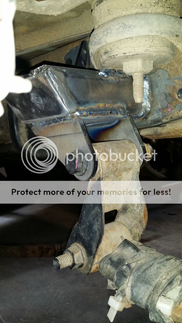

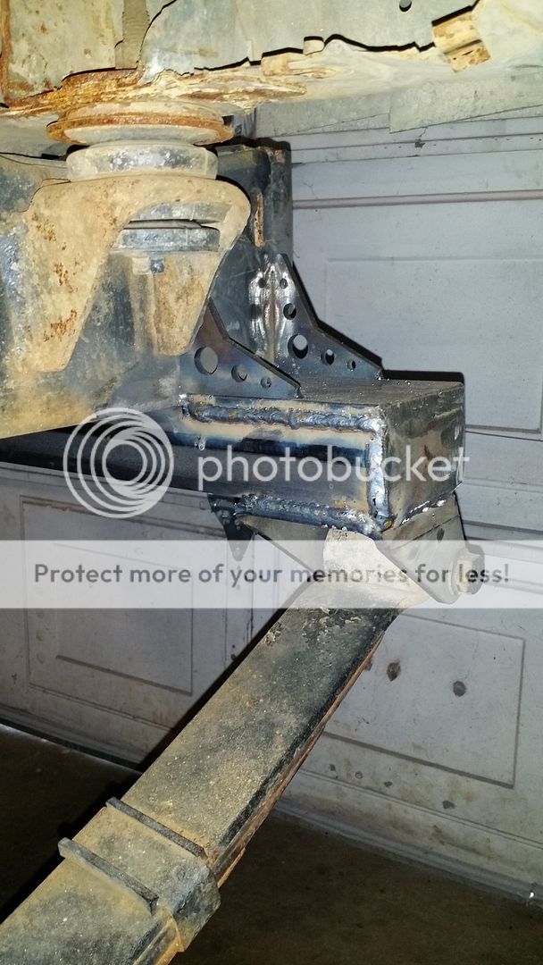

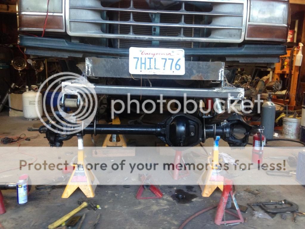

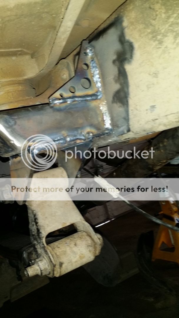

so this is where nice stuff starts getting swapped in. we built a new cross member, built new outboarded rear spring mounts, put all new heims, tie rod and drag link which is super beef U bolts, and mount plates, all kinds of goodies.
rear spring mounts
built a new cross member not using C channel, and random bits of crap... and then mounted the axle.
