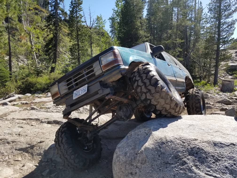

It did do good on the first half of fordyce, but the creek crossing was flowing too heavy to cross. Here is a couple of pictures.

Got the doubler in, fixed a few minor things, and took it to fordyce for another trip in august. With sloppy steering, virtually no rear brakes and old beat up super swampers that leaked and couldn't be aired down since they were 16.5 rims we made it through fordyce trail. It did really good. Broke a mirror off, a little body damage, and a badly bent rim were the only carnage. Had a blast.
