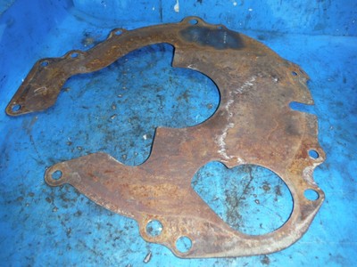

Seperator plate worn... starter keeps moving/walking away from flywheel.

Thanks, Frank! I ordered the new 10 tooth from napa and I should be getting it on the 4th. I found a similar post regarding putting in a 10 tooth. I also found some weird ass crap about using a 4.0 auto (Cant use a manual model) starter on the 2.8.... After looking at it. I have zero idea on how that is supposed to even work. That is the mounting of the 4.0 starter.
Someone correct me if I am wrong, but I think since the 4.0 had more power output, they needed to use a larger clutch. To use a larger clutch they needed to make a larger flywheel. So the starter had to move out more since the flywheel was a larger diameter. And I would suspect they followed suit and just made the setup the same for the automatic also?
The 4.0 manual does have a larger clutch (I've recently done one of each flavor). From adsm08 in a 2014 post:
"The 2.9 manual, auto and 4.0 auto plates are all the same. The 4.0 manual plate is the odd man out because those first three all have the 8 2/3" flywheel or flex plate. The 4.0 manual uses a 10" flywheel, which is why that plate is different. The starter has to be farther out."
https://www.therangerstation.com/forums/index.php?threads/spacer-plate.150750/#post-1450146
I've been through this, replacing the plate on my 2.9L. They are hard to find, but not impossible.
I'm pretty sure that the 2.8 and 2.9 plates will interchange, and are possibly the same part number. The plate used with the early C3 autos had a small removeable window, for access to the TC nuts, that the manual plates don't have. Otherwise, functionally, I believe they're the same.
I've never had a 4.0 auto, so I don't know about its separator plate.
