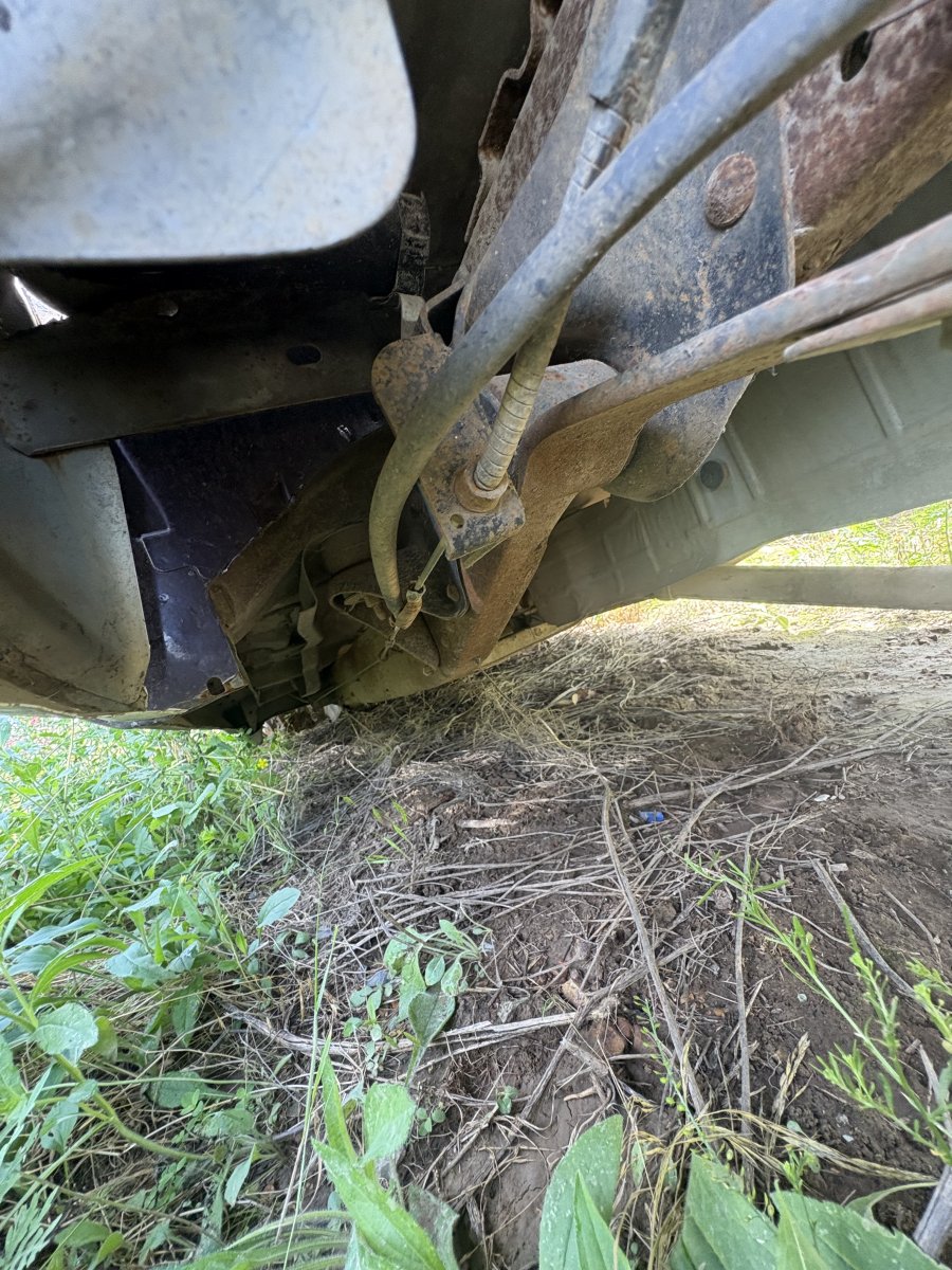

My parking brake barely works. The way mine hangs down under the cab needs to be corrected. It is on the list to get fixed. I find the issue with mine I will let you know, maybe it is same problem you are having. Is the way your cables attached to the frame correct? I took these pictures off of a salvage truck for a reference for me. Maybe this could help you.
I have the disc explorer rear so my parking brake is a little different, but should be functional. It does work at the very end of the pedal travel. There is a lot of slack in the front cable. The pedal only returns about 1/3 of the way. I can reach under the cab and pull the cable to make it return all the way. I do have a spare pedal assembly... Just gotta figure it all out.
Edit: I expected my speedometer to be off with the new transfer case. They're supposed to have different drive gears. It is off a little, but not noticeable until 70 MPH. That said the odometer/gallons on the pump method gave me exactly 20mpg this tank.
So, I noticed this with the Explorer axle swap in my green Ranger. My pedal will come all the way back up, but yeah, it only grabs at the bottom of the pedal stroke. Oddly enough, no cable slack really for me.
It's weird for sure. Mine hast zero grab until the last click. When it makes that last click 4-low doesn't have enough torque to move it. Pedal also only returns about 2 clicks. Feels like it might all just be slack...
I went crazy, all new cables, I cleaned and lubed all of the bits. Still only grabs at the bottom, but like you said, it grabs hard. Weird for sure.
