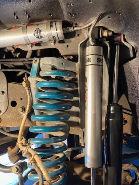

Just something to think about based on your four-wheeling aspirations - - consider welding up some F-250 shock towers to the OEM coil towers to give that front TTB axle a lot more articulation. . .
SenorNoob's '88 Ext Cab "Build"
(Note the shock eyelet about 4" taller than the top of the OEM coil tower.)
Full disclosure: Not certain this will work in your '88 Ranger, but this is my set-up on my 1st Generation Explorer ('94 Sport). My guess is that this kind of thing could be done on your rig.
Nice write up - - glad to see you're still plugging away.
Paul
I have based my suspension on Explorer parts already. I can't see why it wouldn't work exactly the same. I think the existing spring mounts are the same.
