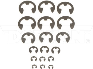

I have been having problems lately with my passenger side wiper arm falling off the motor shaft. I bought a clip that I thought was what I need until I got it apart. After getting the original clip off, I realized an exact replacement was $18!!
So, I found an alternative solution. Very simple and seems to quite strong, though I haven't used it yet.
Dorman Products - 13325 E-Clip-Assortment
https://www.dormanproducts.com/p-19539-13325.aspx
The largest clip in this kit just will fit into the groove near the end of the motor shaft. Oh, and to make it easier to install, I tied a piece of fishing line on the clip. That way it can be retrieved from the inevitable falls into the cowl. You can even use it hold the clip almost in position while it's pushed on with a screwdriver (or a tack puller in my case:D).
