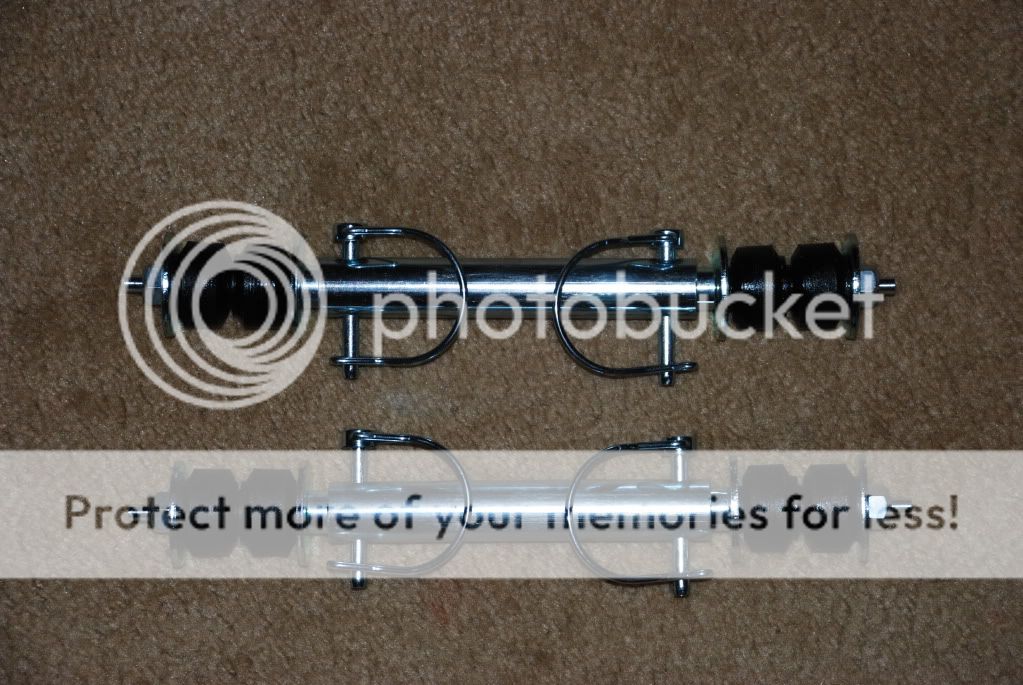

Got some sway bar discos, I'll post some pics once they're installed.
Where did you pick up the disconnects from?

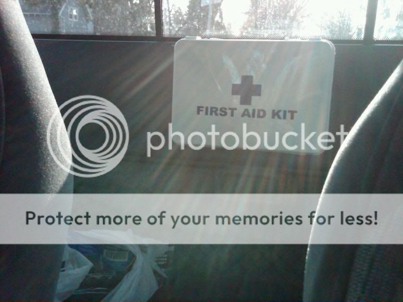

Something everyone should have in their vehicle:

they go on each end of your sway bar, the u-shaped pins unhook and the cylindrical piece of metal in the middle is removed, they let your tires flex a little more when wheeling
Yep, however, though they are quick disconnect, they're not quick reconnect. They are a bit of a hassle to use, but do make a difference in body lean when negotiating the washouts. Here is where you can get some CLICKY. I would call to verify that they will fit your particular vehicle (the should be perfect, but just in case). Oh, also pick up some nylock bolts 3/8 - 24. I had the locking nuts strip out one of the mounts.

Be sure to also carry a blanket and a compress. Hell, an old fashion snake bite kit doesn't hurt either LOL.
I'm also looking at purchasing one of THESE. I've sutured animals (I spent 12 years on a farm), but never a human. But, if push come to shove, it's best to be prepared.
Good man :icon_thumby:
haha, youd be damned to find a snake big enough up here to even be able to bite you, lol too cold. I also have a fire extinguisher, and all the other goodies. I know what you mean about the suture kit....im in dental school, and of course suturing is just part of the job....i just bring goodies home from the clinic :D plus having lots of dental tools around the awesome, soooo useful for stuff.
