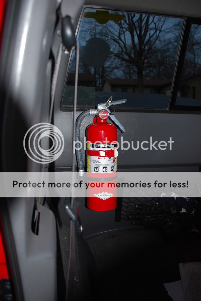

Fire Extinguisher, never know when it might come in handy:

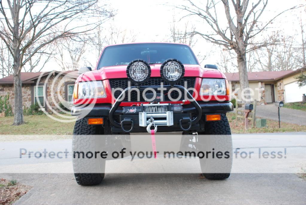

Light Covers. They make a Black and Red cover, but not for the 8" lights, bummer:
Scotty's Rangerunner Build...

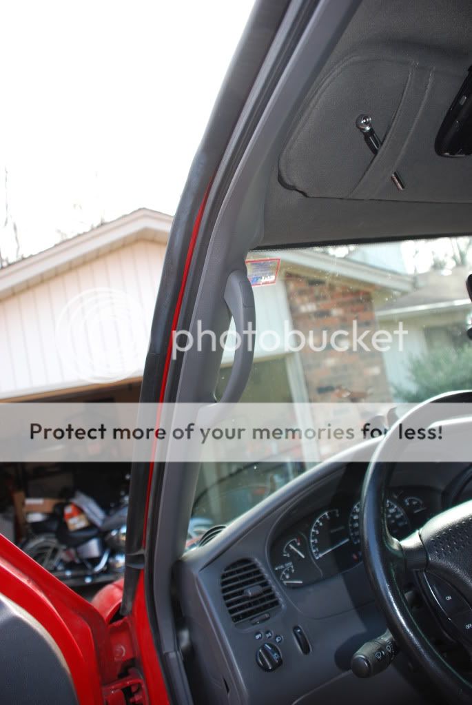

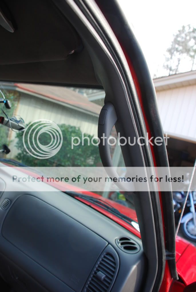

I added some A-Pillar handles. I noticed that the 02 FX4 had them so I pulled the trim and saw that the A-Pillar had the holes for mounting the brackets. I had a buddy of mine order them through his body shop, I got it all for about $150.00. It was an impromptu installation in the parking lot at work so I don't have pics. If you own an 02 XLT, it's an cheap easy installation.
You get 3 basic parts, x2 of course for both A-Pillars. The brackets (with 4 rivets each), the handles (with 2 bolts, washers and covers for the holes) and of course the A-Pillar trim with the molding for the handles.
Here they are installed:
Driver:
Passenger:

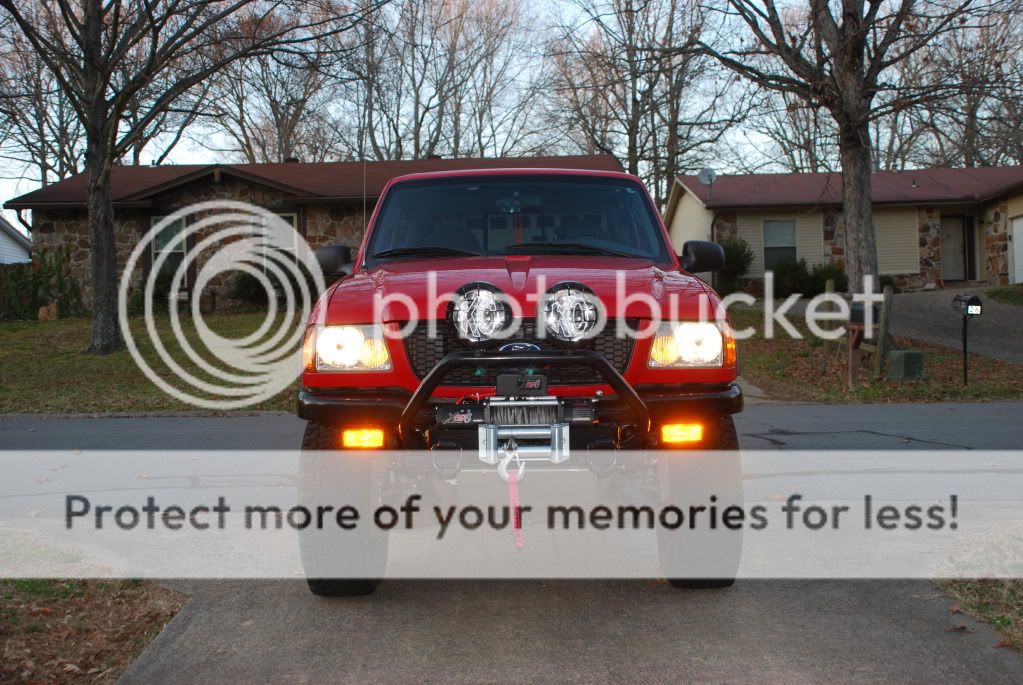

As aux lighting goes, the KC Rally 800s aren't really practical for daily driving (I have bigger plans for off road lighting). I figured since I spend 90% more time on the road in the dark than I do the trails or the desert, I should have some fog lights that are a little more main stream. Since I removed the valance, there were factory holes available to mount the to.
KC 26 series with amber lenses. I wired them into the factory switch. As far as the other auxiliary lighting, I'm going to talk to Charlie and Mud Connection to see if they have someone to fabricate a rooftop light bar that also has mounts for a spare. I'll add 4 more of the KC 800 Rallys, but those will be driving, the two up front are directional.
Here are pics of the new fog lights:
