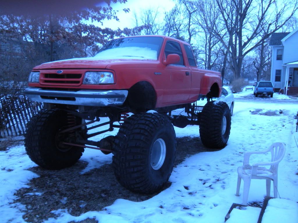

I figured since i was bored at home today id take some pictures of Killer.
Here's how it sits now, blown tranny waiting for some warm weather.
front view. i promise when it was first built it a hell of a lot cleaner. this dang indiana weather.see the high steer arm, 9" full size coils.springs look a little curved, its because of the angle of the picture. they are perfectly straight.

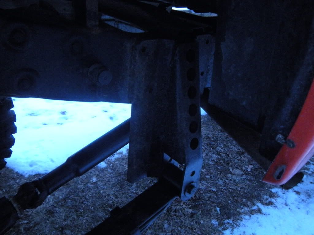

Radius arm drop down brackets with crossmember. the curve was put there just for looks. the brackets are angled out. therefore there is smoothe even movement with the radius arm.

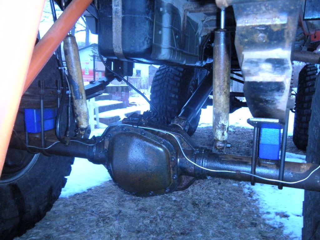

just a shot of the rear axle, sterling 10.25. it has stock f150 leafs. yea no axle wrap there. 4" block also.
