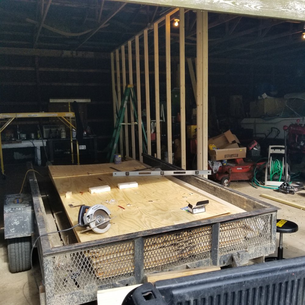

Went and got lumber today....now the real fun *sarcasm* begins...
You're out of 2x4's....
As someone with French Canadian ancestry, I know that 4x2's are the studs you use on the other side of the building.
