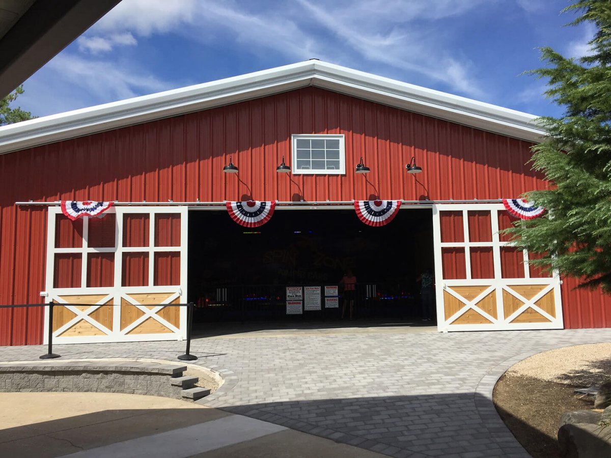

How about something like this, Takes up 0% extra space and you can open them a little, or a lot.
38396
That looks like the right size for a shop,too.
To clarify, my motor crane didn't come from harbor Freight, I got it from Summit Racing. The problem with those doors is holding them open if the wind comes up while driving into the shop. If you don't want an overhead door I'd mount them on rollers to slide open as long as the building has enough width. Or I'd sink some posts into the ground to use anchoring he doors open. It'll take less time than fixing the dented quarter panel would.
The doors would be built on the inside partition wall. Wind isnt an issue. If it is nothing a piece of rope and a halter snap cant fix.
He’s talking about doors on an interior wall between two sections of the building. Personally, I would not want sliding doors for that since they would prevent hanging cabinets or installing a work bench along the wall where the doors would need to slide.
