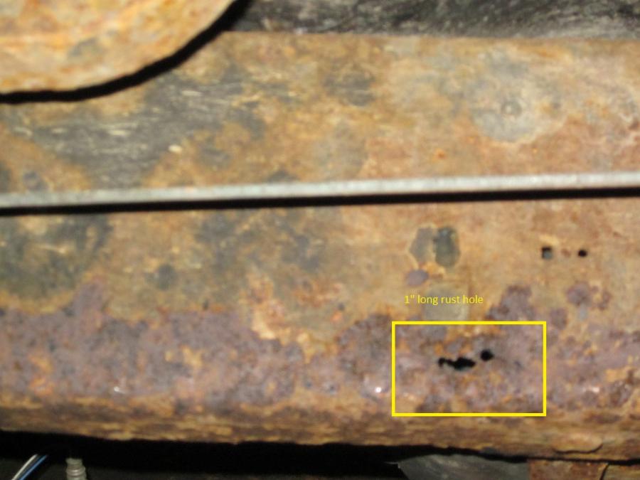

Rust hole in frame, dangerous?

I was getting ready to undercoat the truck and was banging rust off my frame with a 20oz hammer and found that I have a hole, it's about 1" long (see attached). The metal directly around it seems thin, but within an inch or two it goes back to pretty much normal. Behind this is where the "front gas tank" cross member mounts and that is rotted to hell. I can get a new cross member for $110, but I'm worried about the hole in the frame. If you traced a line straight up it would line up with the handle on the driver's side front door. Do you think this has substantially weakened my frame? Is it repairable? Dangerous to drive the truck?

The hole I see is not dangerous yet, but it will become dangerous within a few years. It can be repaired, something best done by a body shop with a certified welder.
I just found some on my frame around the spring mount...not a big hole, but also found some on the rear mount area when I had my shackle replaced...
If you are planning on keeping the truck it should be repaired as soon as possible...I was wondering who would do this kind of work also and I know a welder in the area who can probably do it...but I remember someone posted a guideline to frame welding...it's on here somewhere, but I didn't search to find the thread...yet...
I agree w the above.
Not bad now but it'll get worse and I bet there's more that hasn't been uncovered yet. You should get that fixed my someone with a welder (who's very competent and knows what they're doing)

⬆ This. If you just happened to find this spot... How many other spots haven't you found? Check the frame carefully, especially around any contact points (body mounts, crossmember attaching points, etc).
Don't just go to a buddy with a welder to fix it. Go to a professional... Someone who will do it right. Not Bob down the road with a 110 wire feed welder.
I didn't really "just happen" to find this spot. I was going out of my way to look for rust, hammering (literally) the entire frame end to end every inch or two to see what was bad. This was the only hole I could fine other than a crossmember I'm replacing this weekend (thanks to rangerframefix.com).

Considering that the rest of the frame (and truck for that matter) are in good to great shape, I don't think so. Also, here in Maine this truck is as good as it gets rust wise. I'd need to get a 2006 or newer to be in much better shape and I can't afford that. Not sure where you are thinking it would be cheaper to just get another truck. A 2006+ Ranger 4x4, supercab, V6 5spd tow package, offroad package (if I can even find one) would cost me $10-12,000 around here. I could get the whole frame rebuilt from scratch for half that if it came down to it. And for between a few hundred and a grand I could get the whole thing repaired/reinforced front to back.
It's not an isolated spot. The metal around the actual hole looks about the same as the part with the hole. A lot of metal has been lost in that area. I guess maybe "dangerous" could be a strong word but definitely strength is greatly compromised. Has to be. You can take a new frame and drill a lot of holes that size through it without losing strength. But you have a lot of rust there. I would patch that thing up and keep driving it, but I wouldn't loan it to an orphanage. I wouldn't spent a lot of money on it either.

If your crossmember is rotted to hell and there is a hole in the frame (on a 2000), let me tell you... the vehicle is well on it's way to the scrapyard. It doesn't matter how nice the rest of the vehicle looks or runs.
You can put new crossmembers in, new mounts... that stuff is reasonable. Holes in frames? Speaking from someone who just went over his frame and por15'd it... mine was not even remotely close to what you describe... and it's a 1994 and I live in the great white north!
You can buy a very good condition 4x4 out of California, Arizona, Texas etc and take it home with you. You'll be paying way less than what you are indicating. You don't need to buy as new as you are saying.
You can have a blown engine and rusty body parts. The essential part is the chassis, and if you intent to own this ranger you have long term, you are nuts. Sorry to break the bad news to you...
I had a Nissan Kingcab, same problem frame rot... from the inside of the channels. Nothing you could do about it. I sold it for scrap and moved on. Not worth the money to fix, or the anxiety.
It sucks, but there no logic to spending money to fix it beyond the safety factor to get you to the point you can buy a new vehicle.
