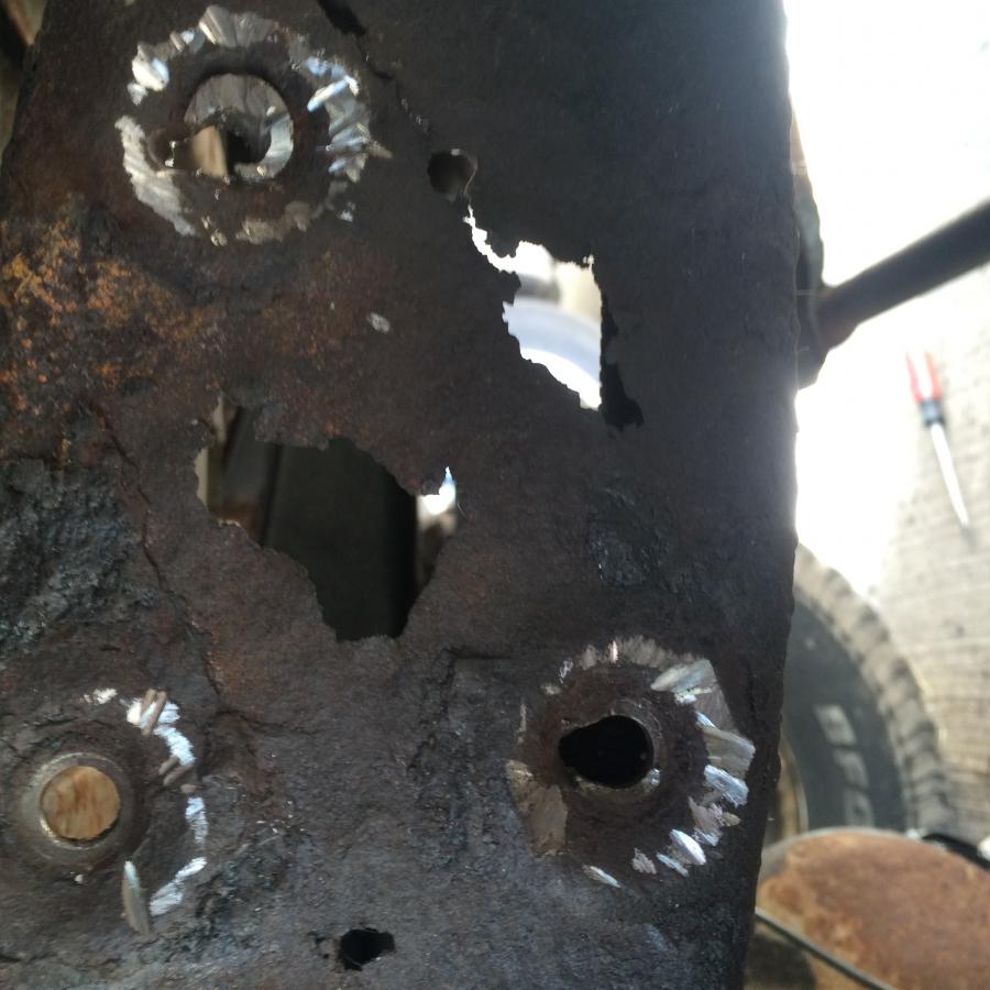

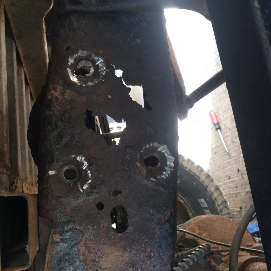

fixing hole on truck frame
Alright guys I new to this site an all so here goes nothing...I was removing my rear drivers side shock mount the other day an it when I finally got it to come off it put a hole in the frame I already got the new dorman mount for it just trying to see what you guys think I should do to fix it? should I buy some 1/4" flat steel plate an weld on both sides or drill new holes an bolt it up any advice would be great

Something like that I would strongly urge taking it to a frame repair shop (yellow pages). That is very repairable! But it needs to be done 100% correct to retain your spring alignment (so the truck won't "Dog Track" down the highway) Plus the repair has to extend far enough front-hole-back to ensure it will hold up.

OK. My repair required drilling out rivets that I replaced with short 3/8 bolts and hard ware. Before I started, I used a come along to maintain the wheel base. I started with a piece of steel that was thick but soft enough . to form cold with clamps and hammers. I unbolted the radius arms and front end stuff bolted onto the frame. I slipped my fish plate as far forward as I could . The piece runs back to the front of the tank. The brake line couldn't handle disruption and leaked. Thus began the most complete replacement of a brake system that worked fine. But I digress. I have yet to continue back toward the bumper. That will require a bed-ectomy. Maybe if I do that I'll get it welded. :icon_welder:

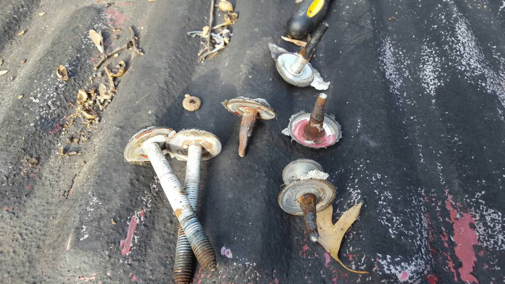

ok tedybear thanks for the input I'm going see how bad there going to charger me at a shop..ya Illinois rust is a b**** also but the rest of the frame is solid i working on taking my bed off also i got 3 of the 6 bed bolts to turn an the other 3 are rounded it looks like someone might have attempt it before i owned it not sure i guess ima have to grind them off
Grinding them off works but they go into C-clips on the frame and they cannot be removed easily with the bolt cut. You can soak them in PB Blaster or other fluid that usually breaks down the rust and allows them to be removed...
I would count on having to replace the C-clips and they are easy to get...I would advise against using bolts and nuts mainly because it is hard to hold the nut while you tighten them...and then you need to go under to pop off the grips or whatever you were holding them with...and impossible to get at the one behind the gas tank.
PB Blaster is what I found worked best...soak them good and leave them overnight...should come off with channel locks or similar. You can also get new bolts...but I recommend Grade 8...the ones with 6 slashes on the head...
EDIT: And I would have to add that you may want to anticipate the fuel tank straps are in rough shape...and I recommend changing them while you have the box off...as well as grinding the rest of the frame and putting on POR-15 or other rust inhibitor...if you plan on keeping the truck a few years.
The bed bolts have an internal Torx. clean out ALL the scrap in the hole with a small screwdrvr. Next carefully tap the face with a ball peen hammer , the little end. This will move all the metal back towards the hole. C.arefully tap the torx bit back in until it bottoms :D

I was lucky and found a nice clean set from Vegas for $30. But even brand new ones are $60 and well worth it. The new set comes with the clips and bolts with the washers attached to the bolts. It is a safety issue, just buy new bolts and clips
ya I been soaking them all for a few days before going to work in the morning. ya I planning on replacing the hoses when I got the box off. like I said also it looks like some one attempted it before cause the top of some of the bolts are rounded when starting but I haven't tried heat yet or ima try grinding across an use a big screwdriver
ford4 did your bolts break or you cut them?
I had three of mine snap off...but I was able to get a huge pry bar on the end of my socket wrench. It's actually better when they break because once you get the box off it's easy to work on the frame.
I put my box on the frame just over two years ago and used clean (not new) bolts...they were rusted by the time I had to remove the box last fall but they came out much easier...so a good idea when putting it back together is to put something on the threads to protect them if possible...
I apologize, I am just now seeing this. I removed the bed liner material from the heads of the bolts, and when I unscrewed them, four out of six simply broke. But they could have broken in a wreck, or when I was hauling something, so I'm glad I found this issue before it became an actual issue
