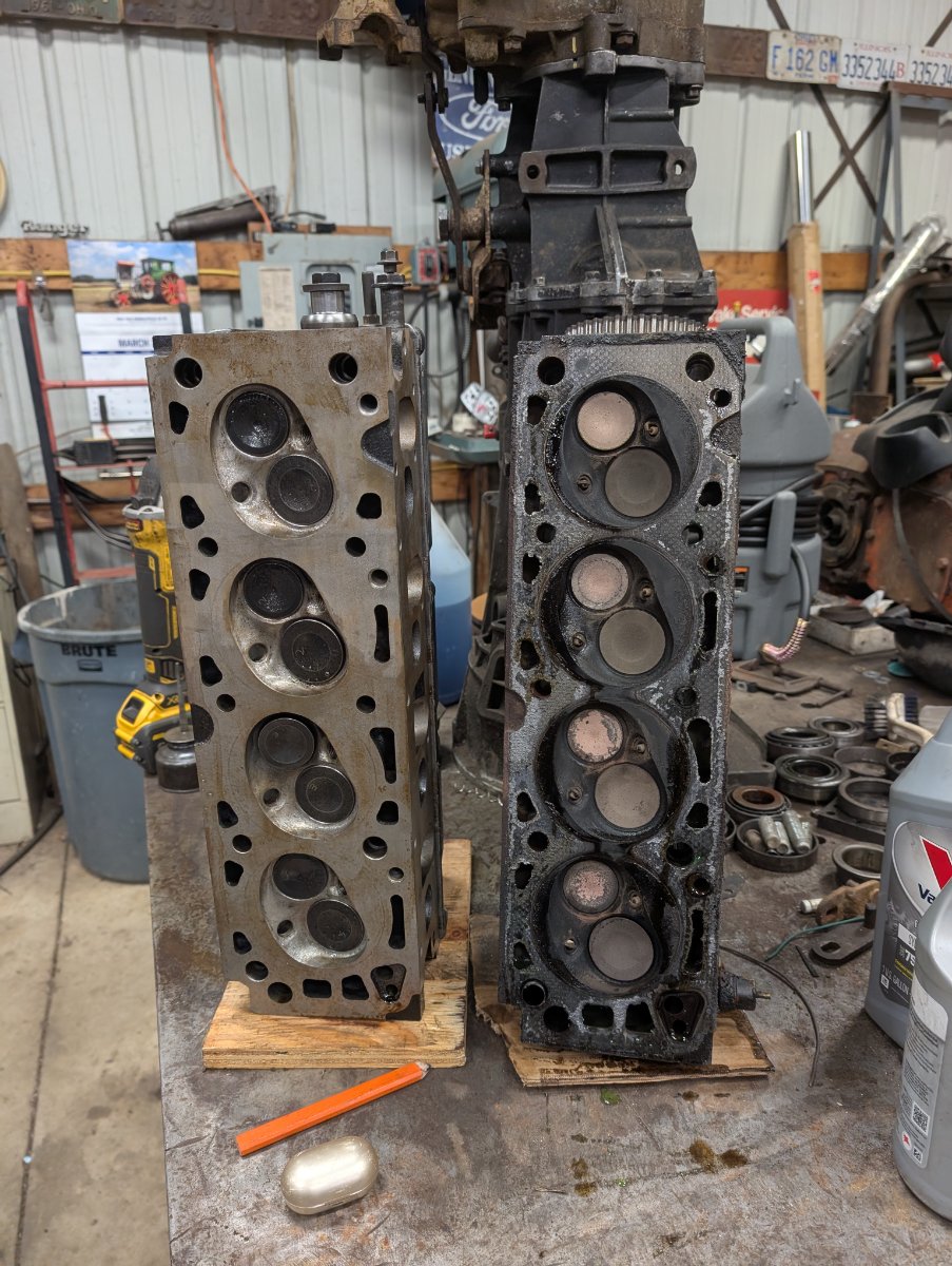

Confirmed sinking exhaust valve seats were culprit. Replaced the cylinder head with a "rebuilt" unit (I got took on that deal) and it took care of most of it.
Narrowed the remaining misfire down to cyl 3 (via OBD2 code) and also confirmed that The exhaust valve stem on cyl 3 sits at least .030" taller than the rest....

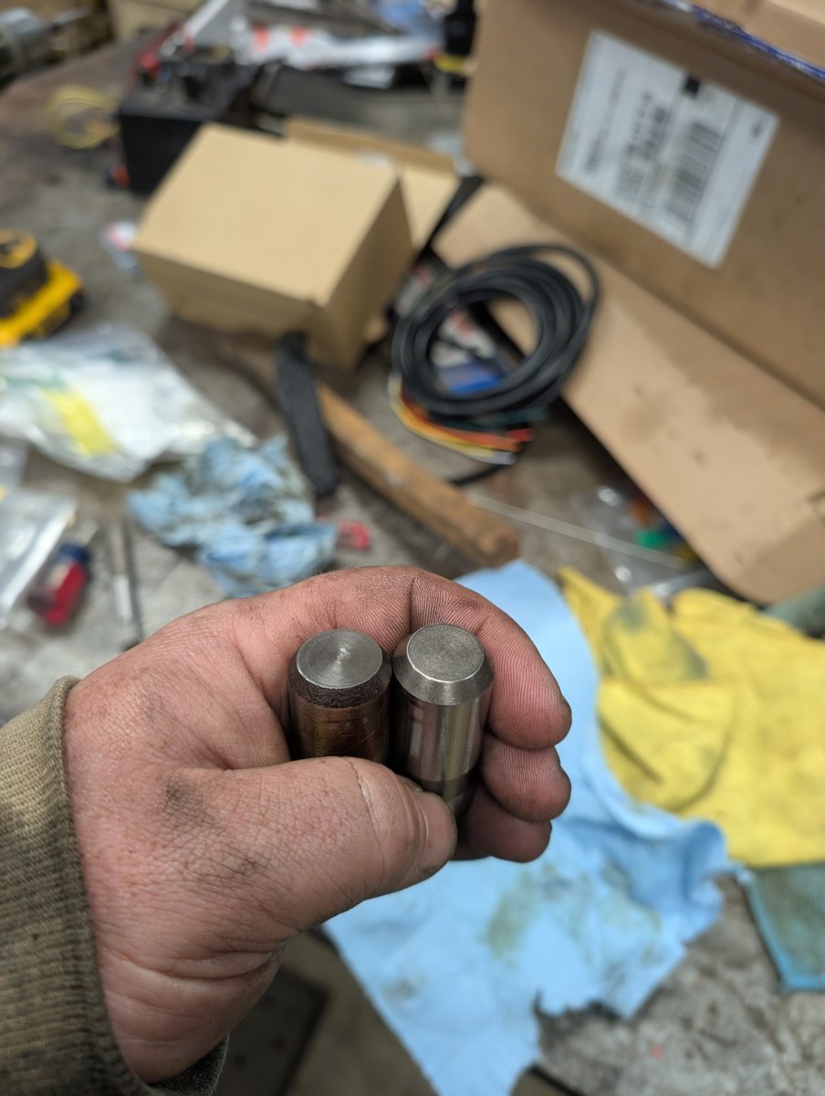

Came up with this sloppy fix...chucked up a lifter and took .030" off the bottom.
Tossed it in cyl 3 and voila...no more noticable misfire.
I'm sure the valvetrain geometry is less than ideal, but she runs like a top even after a hard pull with cold oil.

Also...when I put this head on I noticed cyl 3 exhaust sat lower than the rest, but the installed spring height was still nearly .035" less than the head I took off that had a severe case of dropping cyl 3 and 4 when cold.
It ran better, but had a similar misfire (less severe) when cold.

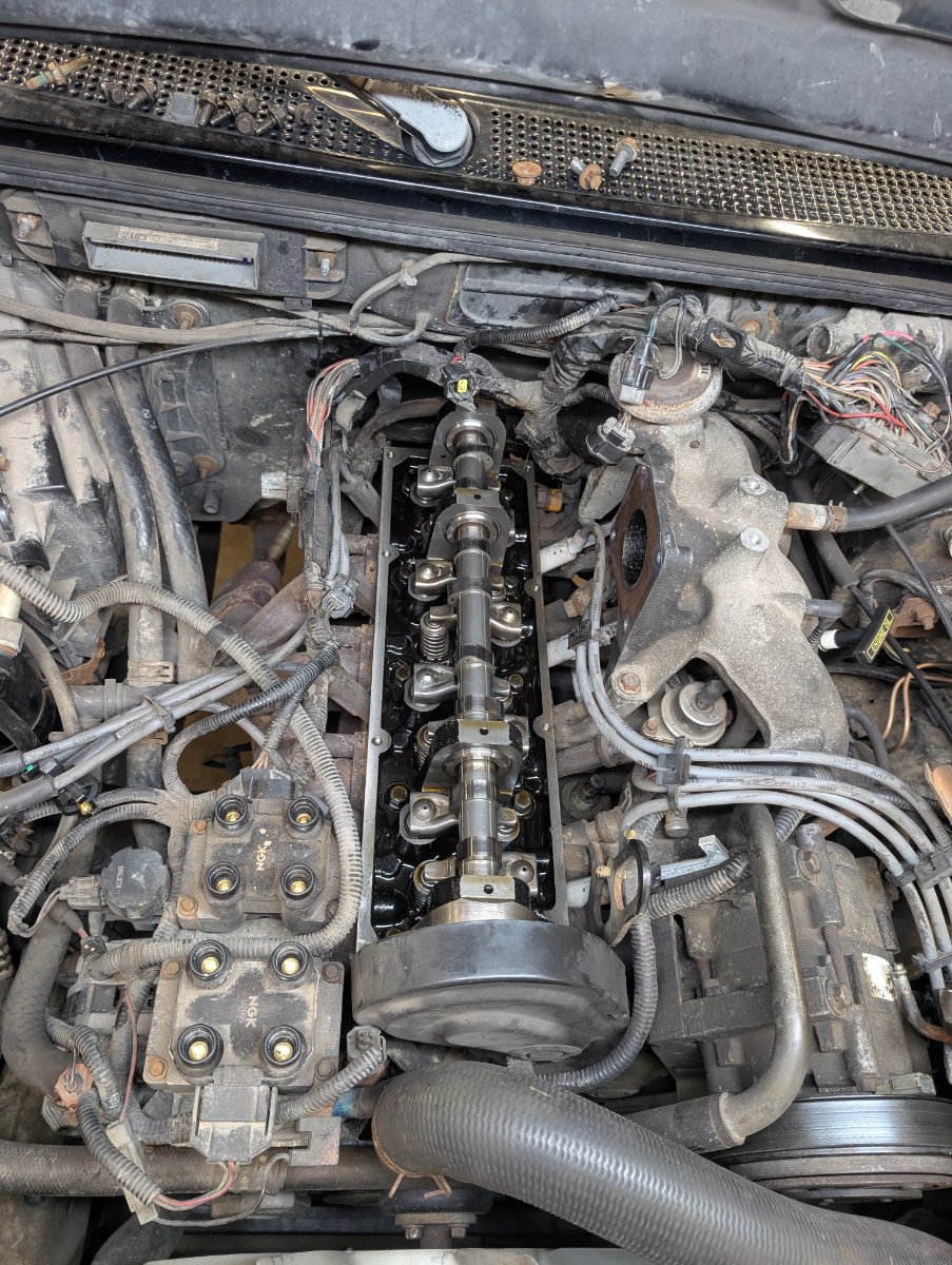

If I'm feeling froggy I may yank the valve cover back off and measure all the exhaust valve stem heights, find the shortest one (least sunk) and take the difference off of the remaining 3 cylinder's exhaust lifters.
Doing the dollar bill over the tailpipe trick I still have some exhaust valves not sealing 100%
