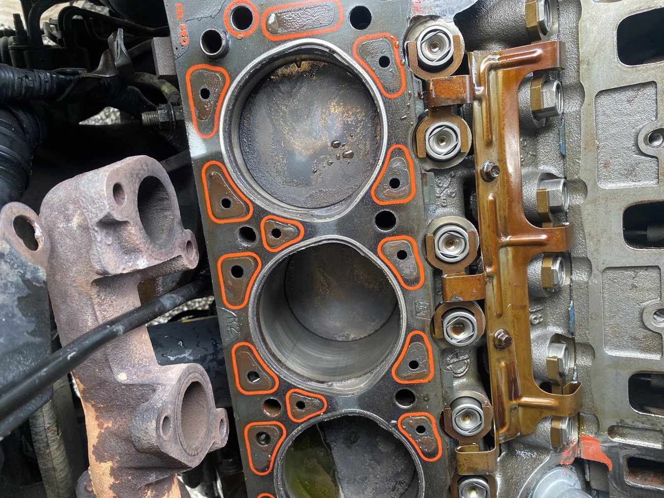

Just a photo of the head gasket surface before i assembled the motor, looking back, yeah, that needed more surface prep… rookie mistake.

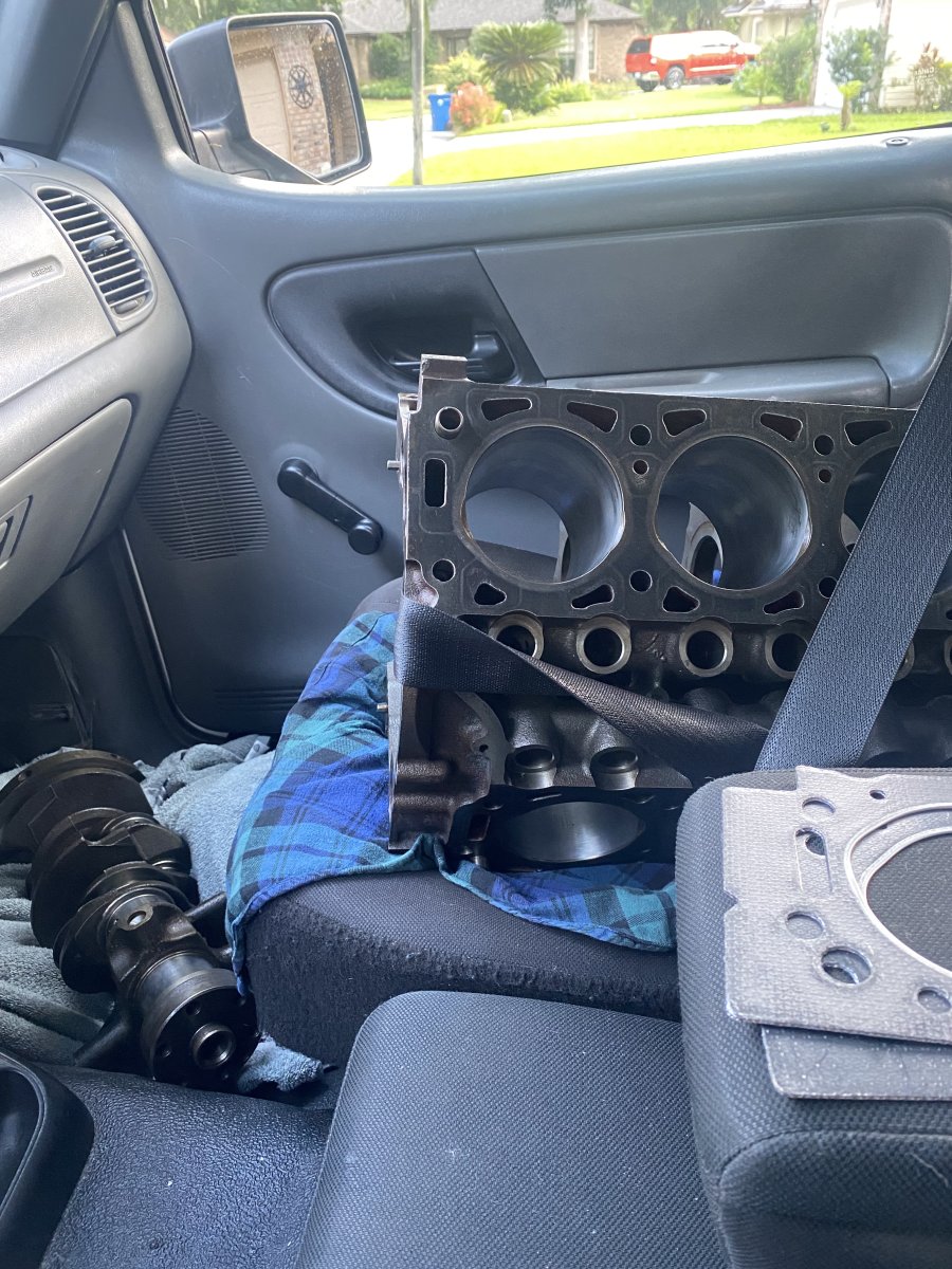

I'm impressed that you got the block in the seat...
Edited to add:
Also, WTF is that?
😂 Neibor's saw it too, it wasn't really fun, felt like i aged 20 years in the joints real quick. Kept telling people the ranger was a dual motor because there was two engines in it

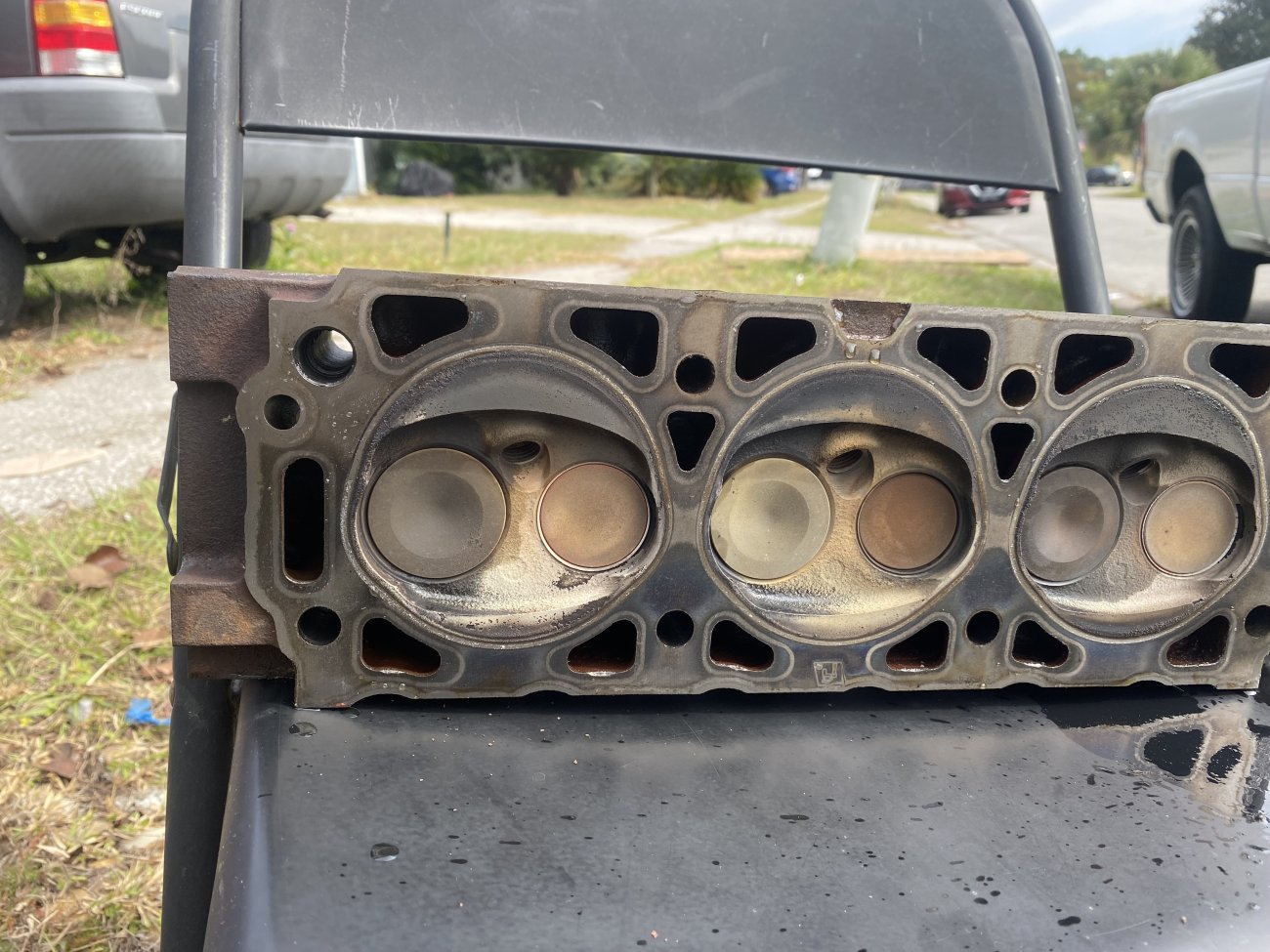

So here is the head, looks like coolant staining a bit, some bolts had chocolate in the holes, cleaned them out real good, the gasket barely left any residue behind, there was just the old crap i forgot on the block

Have you put a straight edge across that head and checked for warpage? I think I read all the messages but forgive me if I missed something.
I'm not sure I'm seeing this pics right but I'm wondering what's going on between the cylinders. It looks like there's a suspiciously clean spot between the cylinders.
Yes i have checked it, its all flat, there was a metal reinforcement in that spot on the head gasket
