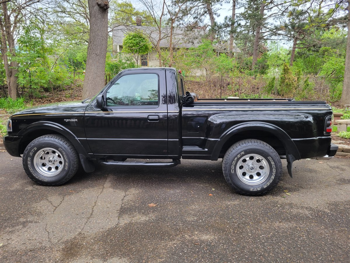

I am of the opinion that fender flares look best when they are the same color as the truck. Also of the opinion that the 2k spray paint system provides for a highly durable finish: primer, color, clear coat.
That looks nice. You pull them off for this paint job? Personally I like the slight two tone, or white/black look, a little retro. Also not sure how well white fenders would hold up
I pulled my flares off a junkyard truck and painted them up with 5-6 coats. but I don't see why you couldn't just tape off around them. Just make sure to cover you entire truck to shield it from the overspray.
