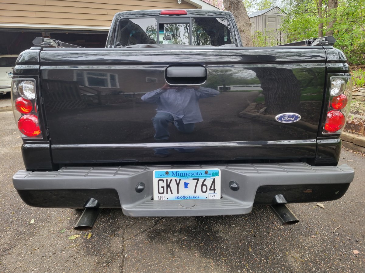

Here's another 2K paint job done on a home made steel fog light bar. I wanted the paint job to last. It has.
You might notice the gray rubber trim on the bumper. I would love to paint it except I'm sure that no paint will stand up to the wear and tear. Will forever black work?
You might notice the gray rubber trim on the bumper. I would love to paint it except I'm sure that no paint will stand up to the wear and tear. Will forever black work?View attachment 104359
Bumper? What bumper I just see a guy in jeans talking a selfie in front a mirror!
Jokes aside, nice paint job. In my searching everyone seems to really like "solution finish", but it will stain/dye plastic black, which maybe what you're looking for.
Do you know if it is durable?
And thanks for the mirror mention. Little things like the finish colors become increasing more important when you can enjoy a show room finish, even take your Ranger (now an antique) to a car show. Don't get me wrong either. I have driven-rusty-but trusty for many years. I still mine hard. It's just less depressing to drive Old-but-New
I've never used it, but all signs point to it being the best, most permanent and "professional's choice". But it is messy, greasy, stains, and can be a real pain for any interior stuff... but I don't know anything other than what google tells me other people say!
