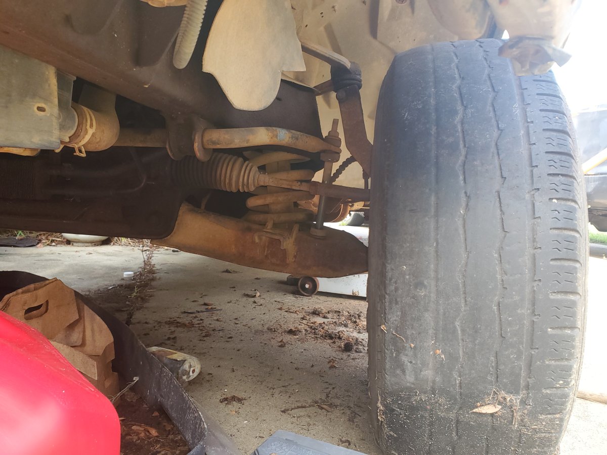

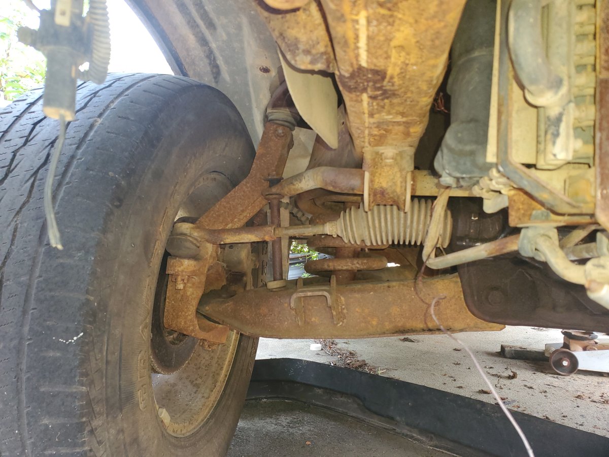

it would probably be best if you took a picture of hte front end suspension so people on here can look and tell you what changes were made.
it might be lift springs with different control arms, but who knows without pics

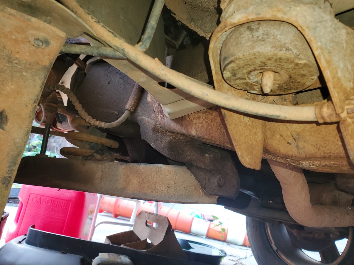

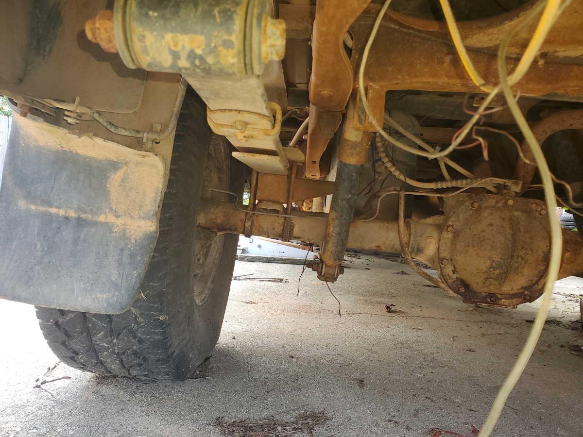

Front suspension. Also included a rear pic to show the 4x4 block.

the rear looks stock. it looks just like my rear blocks above the springs. i think. i will need to go look to be sure but mine have some weird thing sticking off the side like that
That is stock… it’s for the bump stop on the frame to contact.
i knew something hit it to keep the springs from inverting or whacking into the frame. it just looks funny sticking out sideways
