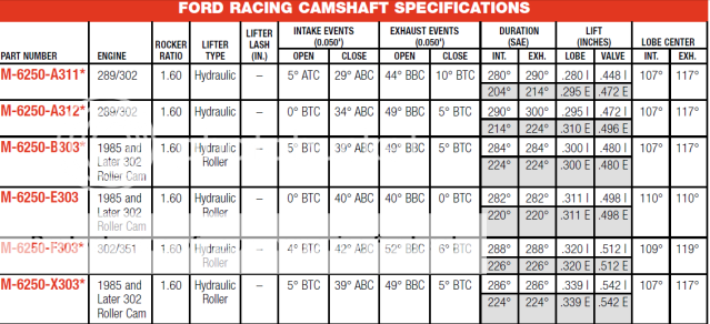

Here are the specs for all the cams to see what the differences are.
EDIT: I just realized that the B and E cam specs are for 1.6 rockers
