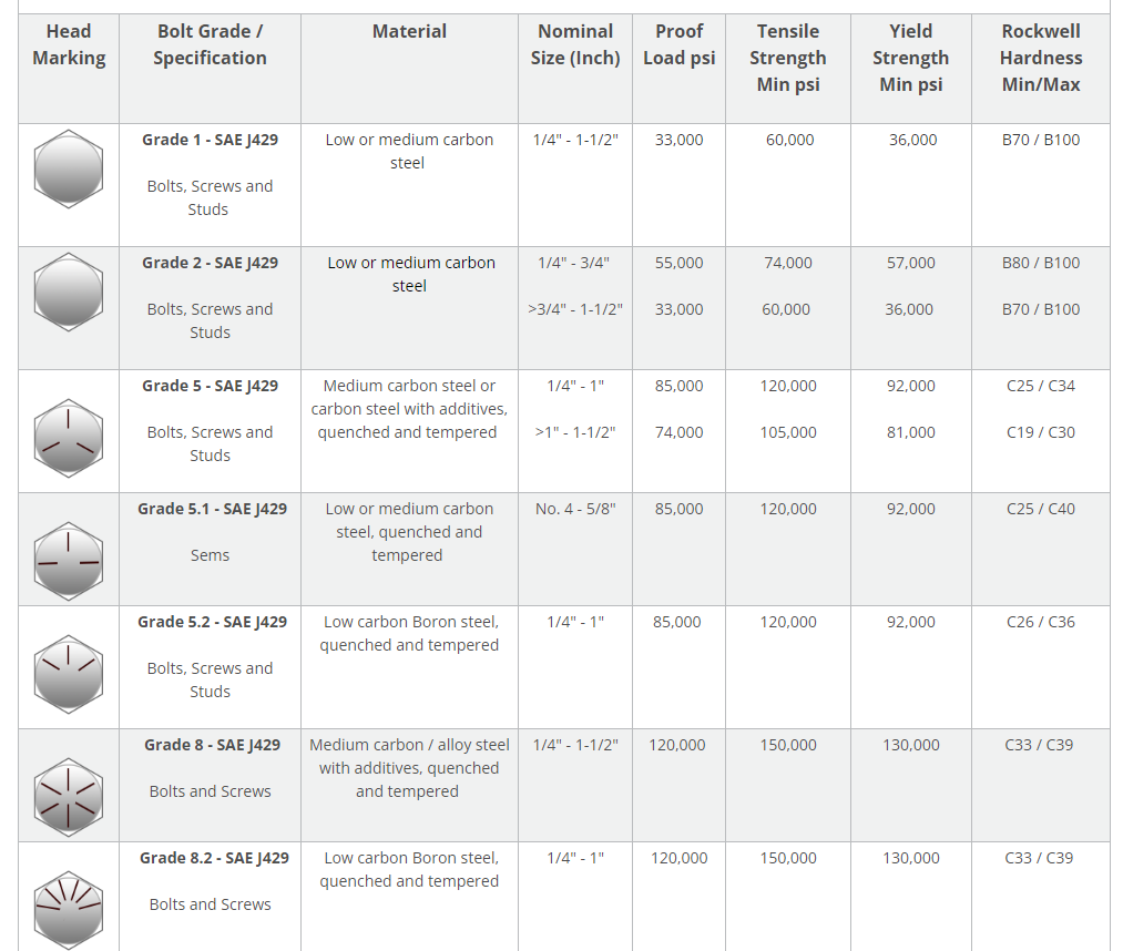

To answer the original question...
Grade 8 x 1/2" diameter is what I used on my race truck. BUT... I made sure the unthreaded portion of the shank supported both the frame and bracket and that the holes were drilled to the same size as the bolts... No slop! I used washers where I had to, to take up space so the nut didn't hit the plain shank before tightening. After, I got to thinking of aftermarket bolt on hitches, and they are all grade 5 bolts. Thicker than the ones used in truck frame brackets tho. So I would probably use grade 5 slightly bigger diameter if necessary.
My shackle/spring bolts are grade 8 with holes in them and grease zerks. So, they probably are not really grade 8 anymore. Don't remember what the shackle hardware was that came with the hangers. I want to say it was 8.8 which is a tad harder than grade 5.
If your shackle bolts are stamped grade 8, they need have grade 8 strength.
Note: Bolt grade specify the minimum, not the maximum.​
There are steels out there with strength far beyond the 150ksi required for grade 8 - e.g. 8740 at 210 ksi, or L19 at 260 ksi.​
So, with your hollow bolt, the mfr. needs to use a better material/heat treatment if he is certifying their strength.
To the OPs - class 8.8 bolts probably exceed the strength of the OEM rivets, so class 10.9 would be fine (Ford allowed grade 5 bolts in their frame repair manual). Then you either need washers or flanged bolts/nuts to distribute load before lock washer/thread locker.
No slop and supported on shank, not threads are critical, but not drilling out such a large hole that there is insufficient material in the bracket to maintain strength is the flip side.
This is one case where the slight differences between metric and imperial is an advantage - e.g. 3/8" is just slightly smaller than 10mm (~0.4mm), so you may ream the hole for the metric bolt to eliminate any slop without having to remove as much material as going to 7/16"​
Rivets work even if the holes aren't aligned.
The rivets I was replacing needed 1/2" holes to properly align. 7/16" left some parts of the hole too big. But yes, I would use the smallest diameter possible.
