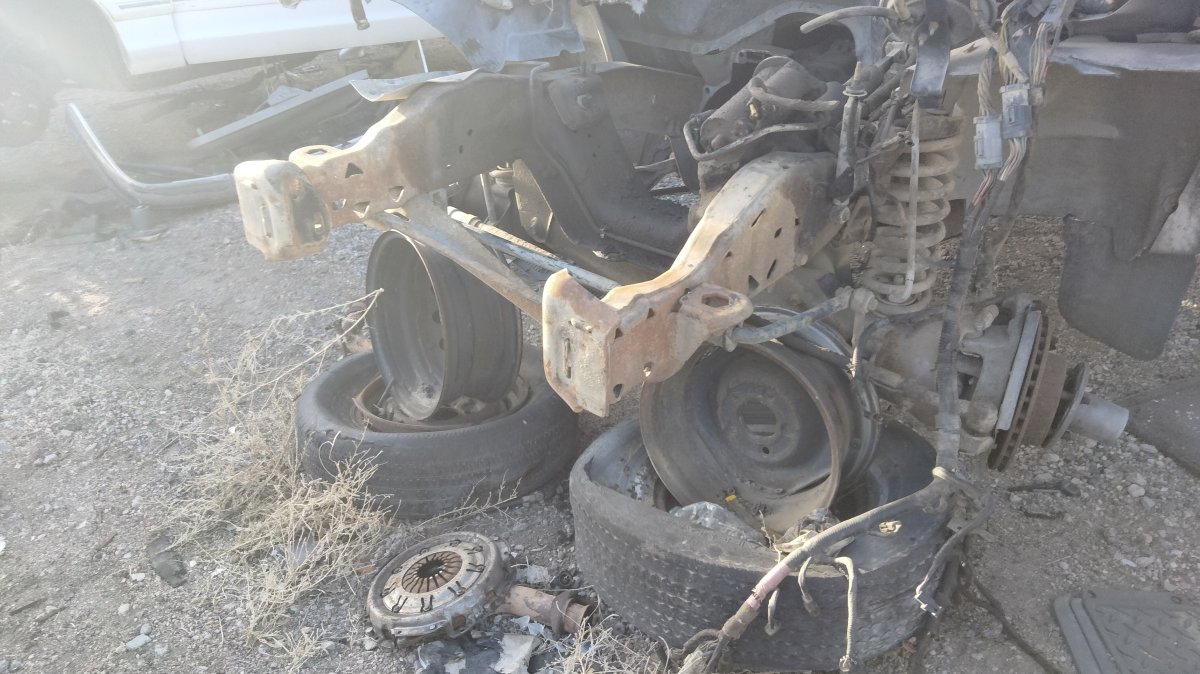

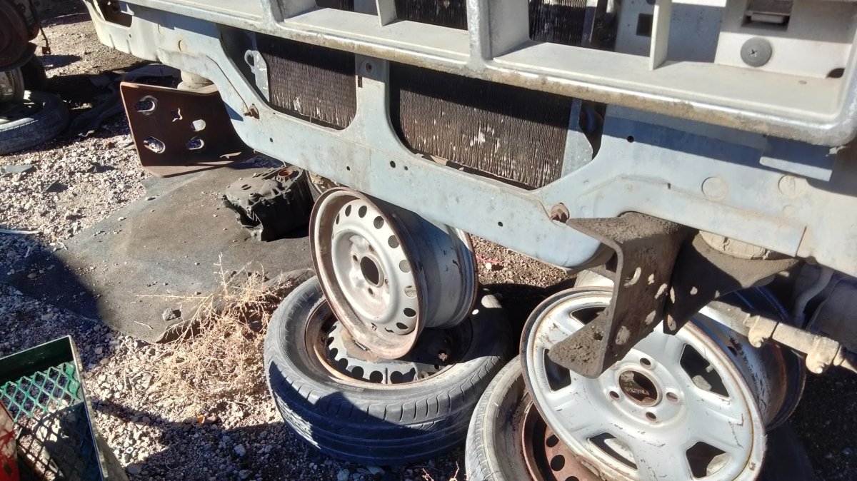

Since I started this and I have the 'yard close by to get pictures easily I snapped some photos
Additional Edit:
Per more than a few users here the 4th and 5th generation frame stayed exactly the same so 98-03 and 04-11 interswap just by turning bolts.
The front frame horns / bumper mounts are the biggest difference.
A 1st Gen front end (specifically is a 1984):
A 2nd gen front end (specifically a 1989):
a 3rd gen front end (specifically a 1994):
I do not have any 4th gen available at this moment, if you have good pix and exact specs (year) please share with me.

The frames remained pretty much the same until 1998. From then on, the frames stayed the same until production ended in 2011. I seem to remember a few people saying that the frame horns, where the bumper mounts, changed some for the pre-1998 models.
...I seem to remember a few people saying that the frame horns, where the bumper mounts, changed some for the pre-1998 models.....
I literally just posted pix of a '94 and a 90 frame horns in this other thread:
Also change to the frame horns for the 89 model year. There are basically 4 styles of frame horn.
1983-1988
1989-1992
1993-1997
1998-2011
I can't say for certain that those last two are actually different, but I seem to recall that changing the bumper brackets is part of face lifting the trucks with the later bumper.
