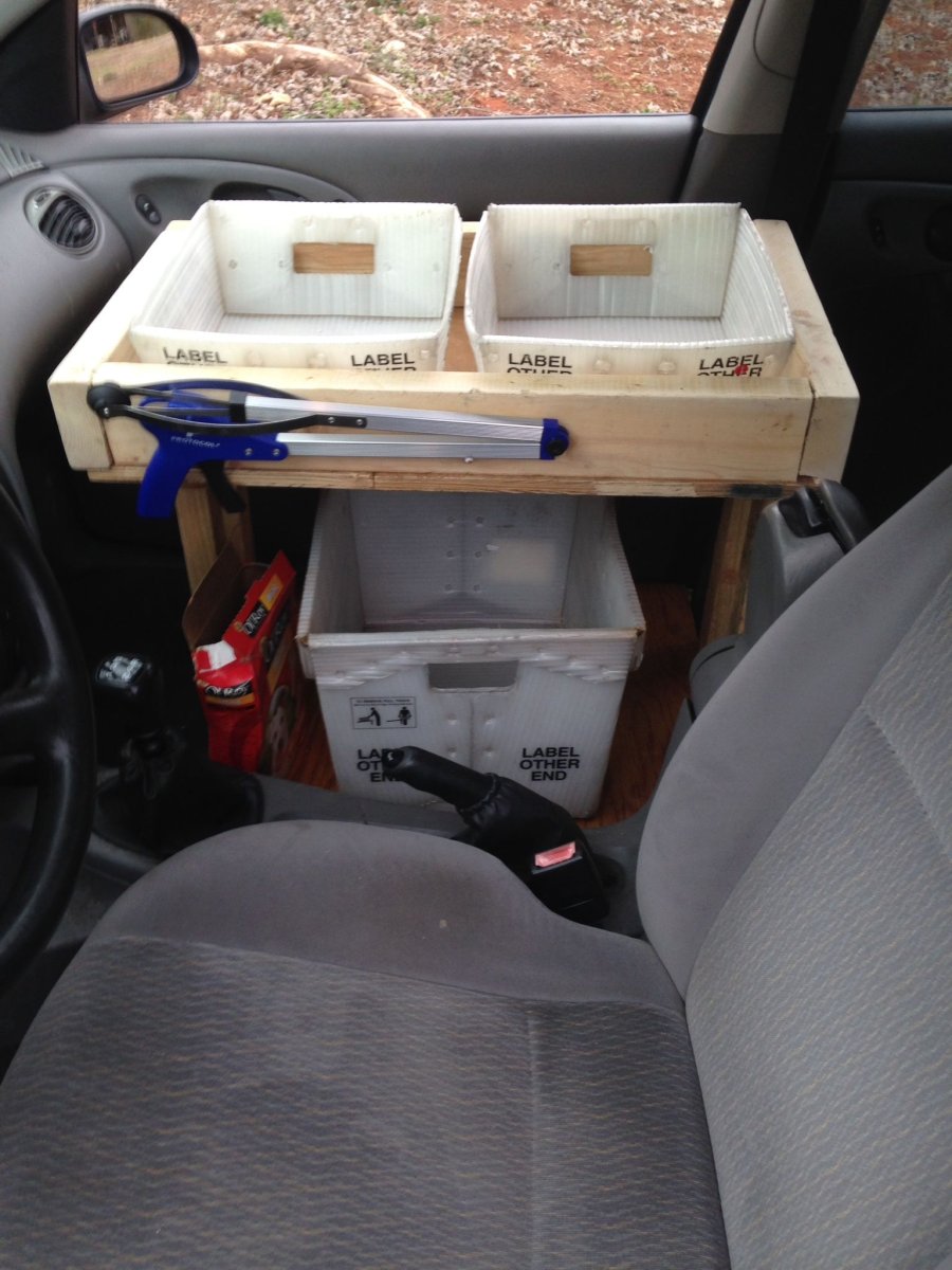

My passenger slider will soon have a Cargo Tray attached to it similar to a Postal Jeep Mail Tray for Tax reasons. (I have a courier service in the Okanagan.)
